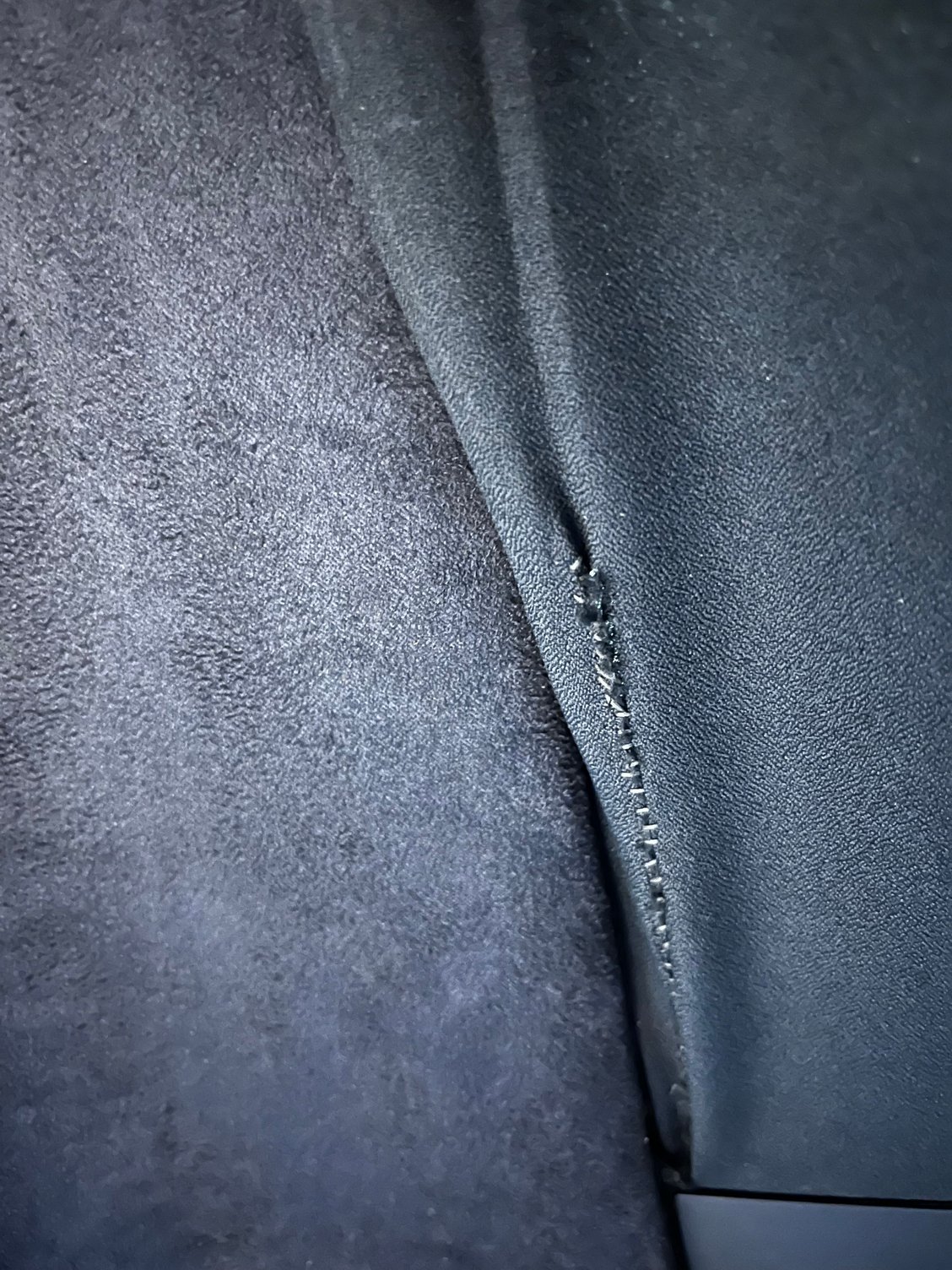

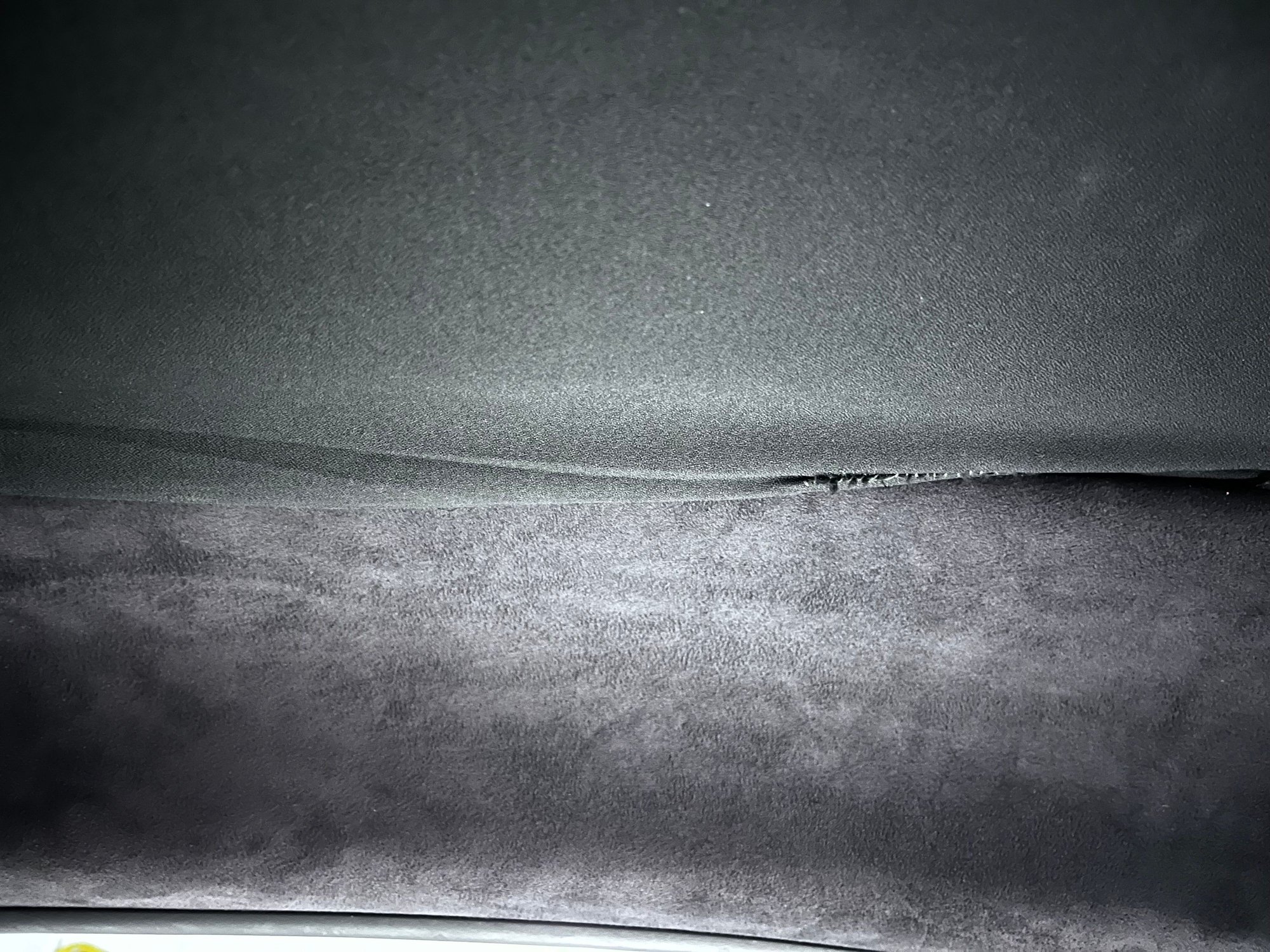

Hello, I have a 2015, F-Type R. The material that covers the sliding sun shade is starting to became detached. Is there any information on how to DYI the fix myself?
thanks in advance.

There is no simple diy fix for your issue. Best left to the dealer and will cost $$$ .You could DIY if you are keen and experienced as involved dropping the roof lining, which means taking out the rear quarter window panel and possibly the seat as well and then still having to buy the OEM shade replacement ,so a massive job

If you could provide a photo of what's happening, that may help with suggestions. I also have the sun shade, so will be interested in learning how this comes out. Just checked mine again and it appears that the material is stretched to all four sides, and not glued in like a headliner would be.

try the info in this link.
https://www.jaguarforums.com/forum/f...broken-250416/
It's a $4000 headline if it's leather. I think the shade and headliner is one piece. I had it fixed, then tinted the glass and have never shut the shade since. I am not tackling that job and I'm not paying to have it done.

This is on the drivers side.

Not sure if putting in a very small amount of epoxy would take care of it without having to pull the headliner out.
