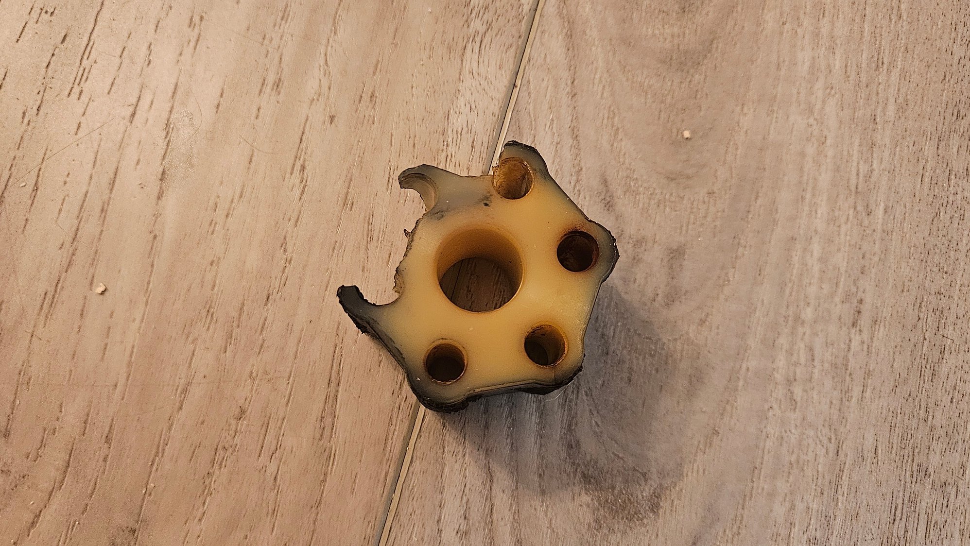

The couplers that i install in members cars are solid by ZZP OR any that are not fake they must fit tight and i mean tight ,the fake ones will slide on easy and melt , took one of a 2016 F-TYPE and this is what it looks like ! after 3 months ,then i installed a original ZZP . You can go back to stock but then you have to pull the snout again ,the one i use is ZZP, ITS lasted a couple years now and the ones I've installed in members cars are quiet and reliable
Fake one
