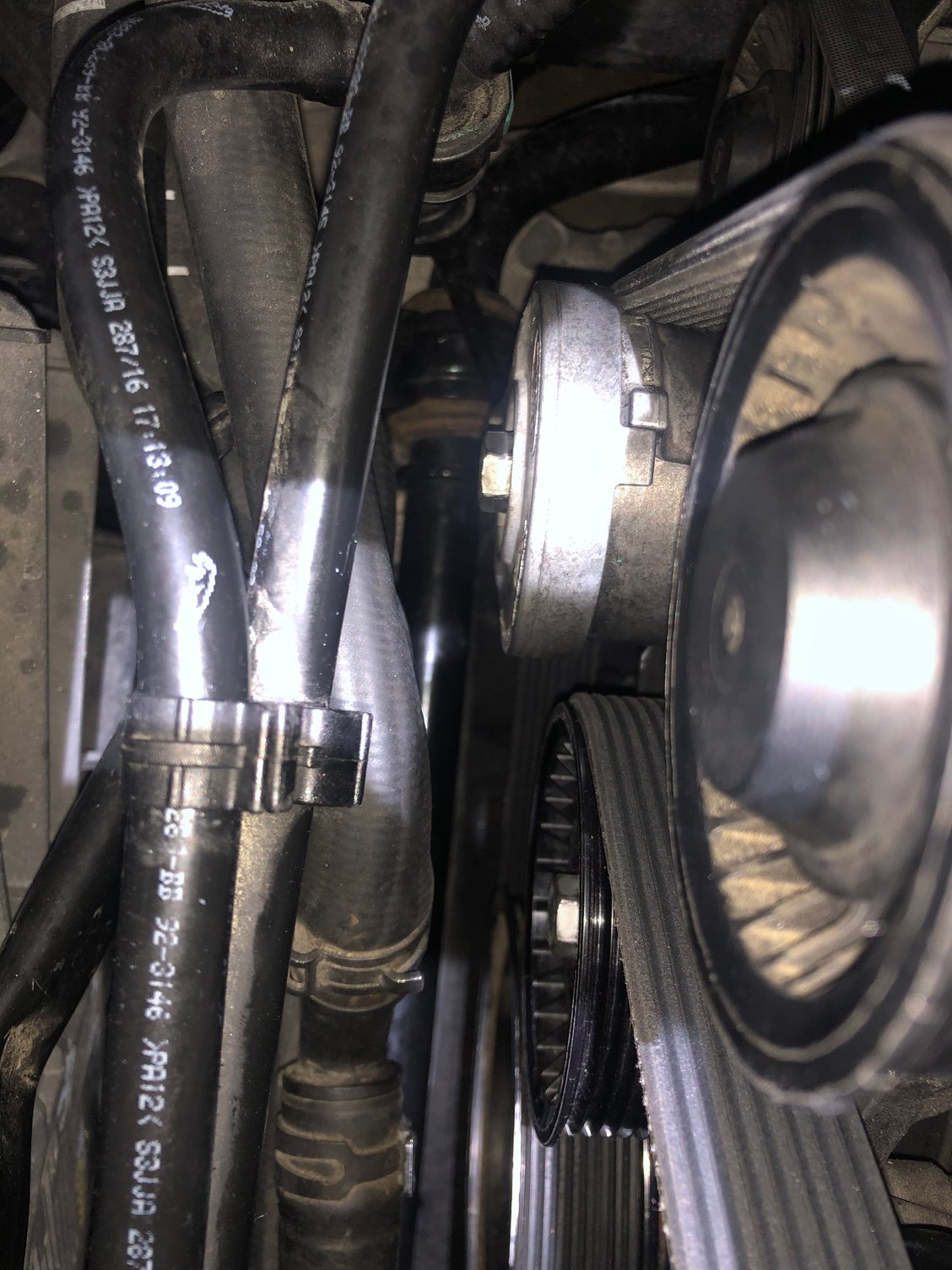

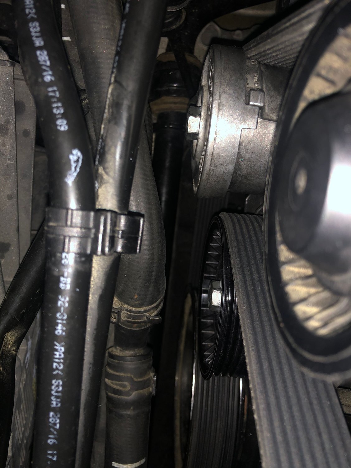

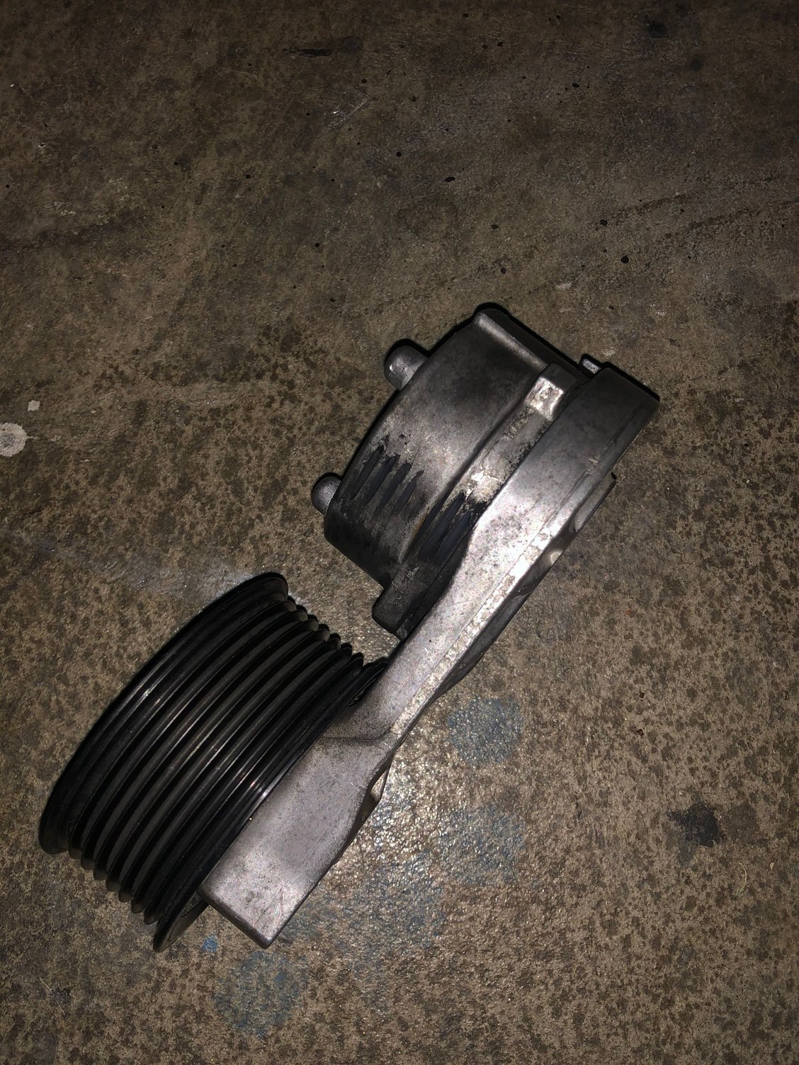

so , i was getting ready to take the supercharger snout since am getting the replacement tomorrow and I noticed something interesting, could this be the problem, I see that my supercharger belt is touching the belt tensioner, is touching it so bad that I took the tensioner out and noticed in the tensioner body, (the aluminum) the belt marks, is this normal or what?, i attached some pics
Old May 19, 2020 | 11:31 PM
OzXFR's Avatar
Posts: 9,031
Likes: 3,664
That does not look right!
I see you have a double-sided (ribs on both sides) SC drive belt whereas the OEM belt was always single sided.
When fitting a double-sided belt the tensioner needs to be changed as well, and it looks as though you still have the old/OEM tensioner.
I reckon you have found the source of your whine!

i think that is it, making that loud sound after gets hot, I ordered the belt through the dealer online, so you saying that’s the wrong belt?, is supposed to be one side tread only?
Looking at your pics again I am not so sure.
Are those pics taken from the top looking down or from the bottom looking up, it's very hard to tell although my best bet is bottom looking up?

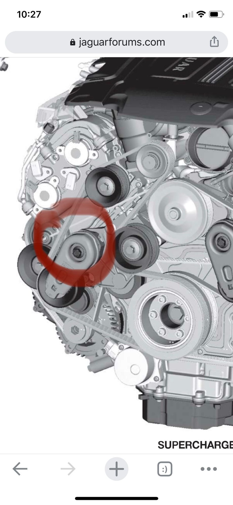

But in any event there is no way a ribbed belt should be rubbing on a pulley/guide/tensioner (whatever it is) like the metal one in your pics, the silver one with the "step" in it. I'm trying to picture the SC tensioner in my head and from memory it doesn't look the same as that metal one in your pics and maybe just maybe it's missing a piece (possibly ribbed) where the belt sits/touches.
Edit - looking closer now that suss looking pulley is not the tensioner instead it is one of the two idler pulleys, hard to tell for sure but I reckon it is the bottom one.
Both idler pulleys are black plastic, so I reckon you are missing the plastic part of that pulley. If so, how the hell your SC even runs is beyond me!
The attached diagram shows the pulley and belt set up (the bottom diagram).

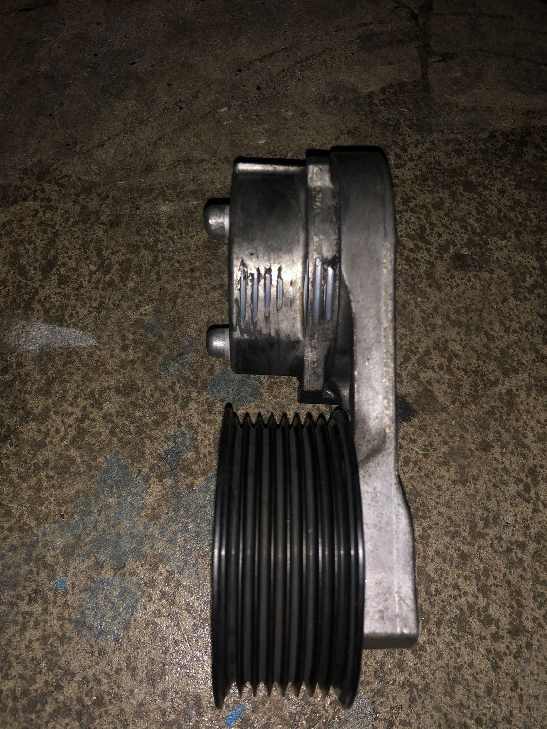

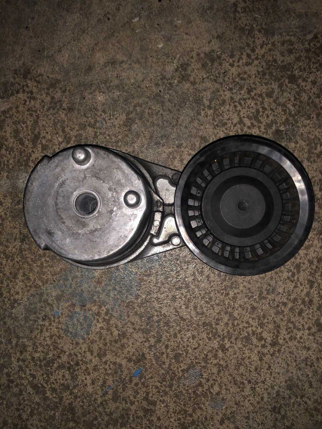

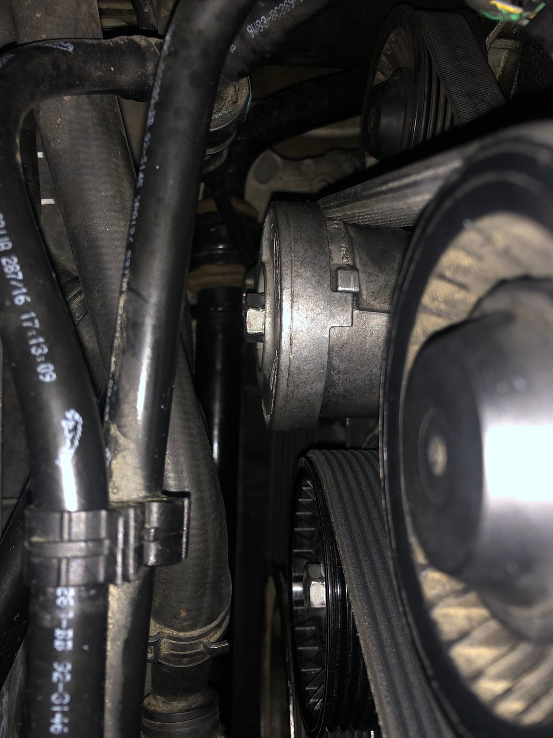

this are pics looking from top to bottom, the belt is touching the tensioner, I took some pics of the tensioner as well, to see if it looks like is bad, you can also see the marks made by the belt right there, also I don’t know if somehow the pins are not right like is broken maybe?
Old May 20, 2020 | 12:14 AM
OzXFR's Avatar
Posts: 9,031
Likes: 3,664
OK, getting clearer, that is definitely the tensioner.
No way should the belt be rubbing on it let alone as badly as those grooves indicate.
Something is very wrong but I am not sure what, maybe the tensioner is broken, maybe it has been fitted incorrectly, maybe the belt is the wrong length, I dunno.
Anyway, attached as the belt/pulley diagram I promised last time but it went haywire.

yes my set up is as shown in the picture, the only difference is that I don’t get that space from the tensioner to the pulleys going up, my belt is touching all my tensioner, making me think that my belt is too short, also almost impossible to put back the belt, makes a lot... LOT of pressure, I have to remove the middle pulley and force it to make it fit and when is all fit properly, is very tight, I can’t even take the belt out because I don’t have any extra space to wiggle, if it makes sense.

more specifically, see that space between the tensioner and the belt, mine have 0 space making it touch the tensioner. Making me believe that my belt is too short?
Old May 20, 2020 | 12:38 AM
OzXFR's Avatar
Posts: 9,031
Likes: 3,664
Yep, that would make sense, a too short belt pulling the tensioner in so far that the belt now rubs on the tensioner "base".
There have been some problems with these SC belts when buying a larger crank pulley kit, but so far always with the belt being too long rather than too short, maybe you are a pioneer?
