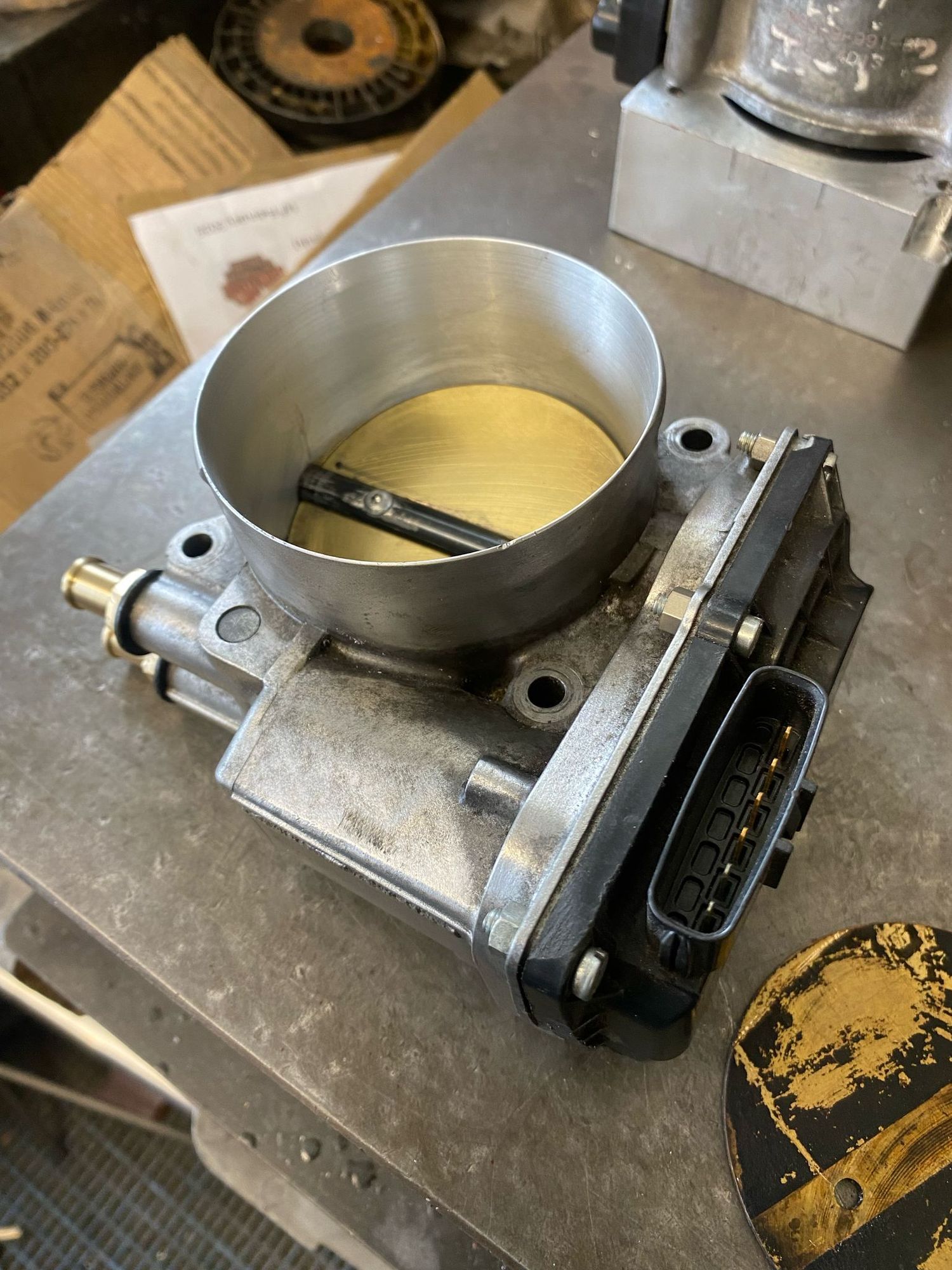

Lots of shops offer these mods with great power gains, but I believe you can get near 700bhp with just a tune and no pulley changes on the 5.0 SC cars.
In case it is of interest, we can also bore out the TB for these cars. Running a bigger TB has proven to be a good power adder for dual pulley cars as proven on the fastest 5.0 supercharged car in the world (XFR on stock supercharger which is running low 10s in the quarter mile).
Picture of an older 4.2 TB which has been bored from 75mm to 84.5mm for illustration purposes.
