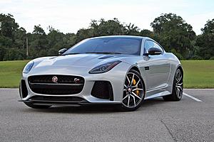

Do you think the side skirts from the 2017 SVR would fit on a 2016 R. I noticed the shirts on the SVR are angled at 45 degrees so that water and dirt does not build up. Mine are flat and being Rhodium always have dirt/dust e.t.c.
Im not sure if its the Rocker Panel Guard 1 or Finish Panel 8 i.e. on the diagram
The Finish Panel has the same part number for a 2017 SVR and 2016 R so I guess it must be the Rocker Panel Guard
Does anyone know
Thanks
Part number is listed as this for a 2016 R.
JAGUAR (T2R11991/989)
https://parts.jaguarpalmbeach.com/a/...M/4760615.html
Attached Thumbnails SVR side skirts on a 2016 R-jag-f-type.jpg   SVR side skirts on a 2016 R-maxresdefault.jpg

I have SVR sides on my R. But it's going to require changing the fenders as well. The SVR rockers are one piece unlike the other F-Types that are rockers + side skirts.
part numbers for the rockers are T2R20613LML and T2R20614LML, but like I said you will need the SVR fenders as well, which are T2R18858LML, T2R18859LML, T2R19982, T2R19983, T2R20872, T2R20873

Ha ok thanks.
Guess I'll just get used to cleaning them. Not worth the effort as I prefer the fenders I have and the cost with painting going to add up.
