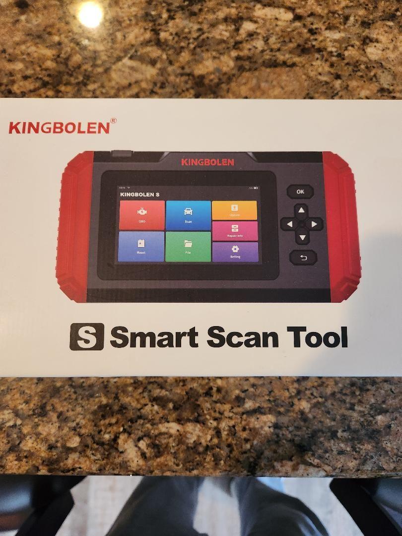

Jagcode 3, here is a pic of my OBD 2 scan tool. It has everything but can't see the code. BUT, either way the DTC are all zero'ed out. IE- 0 yet the light comes back and I later disconnected the main battery for 8 minutes. No change.....the light comes back on.

@jaguarguy100 does it give you a list of all the modules when it does a full scan? See if you can specifically enter the "Telematics Control Unit Module" and investigate. See if you can do a scan just in that module and clear any code unique to that module.
