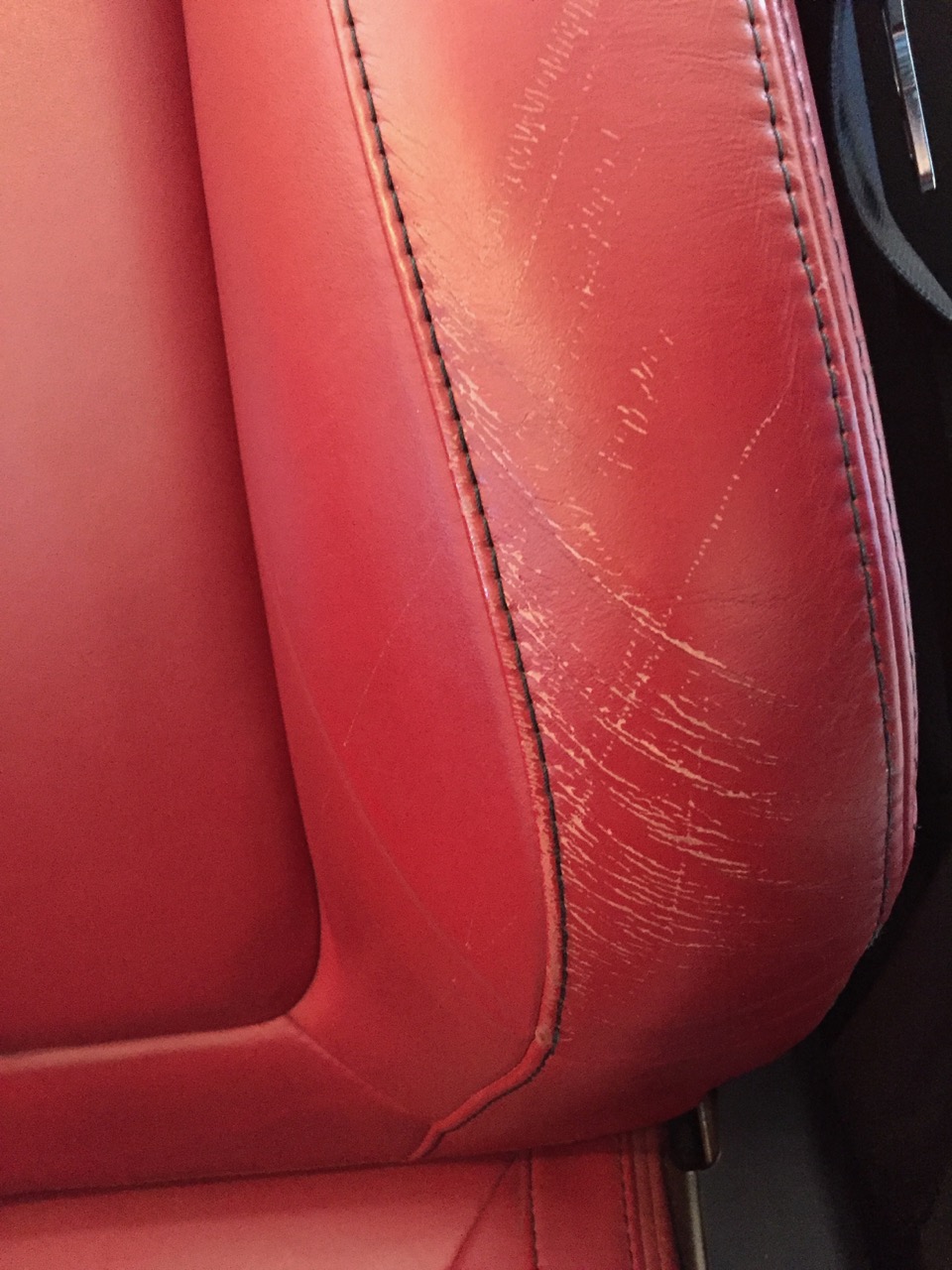

The bottom part of seat bolsters wear over time. I found a DIY solution and I'm very happy with it. A fellow named Andy has a business called Seat Doctors and he specially formulates a product that will get rid of those unsightly wear marks. It is a water based formulation of urethane, flex additive, color formulation, and more flex additive. He will ask you for your VIN, Color Code, and name of the color. The more info the better. I applied mine with a q tip to the creases a couple times, and then applied some with a soft cloth to cover the entire area. This is what it looks like:
Before and after: If you plan to have your seats treated, it is best to apply it and let it sit for a couple days. If you google Seat Doctors, you will see his work.
ps: Andy does not ship overseas

Hi Oz. Our postal system does not let us ship liquids overseas (or any liquids domestic either) and I don't want to get caught by customs. Andy does not ship overseas because the shipping costs are more than the cost of his product, and I think he is subject to the same regulations. I do think, however, that if you mention Redzone for the fellow in California, he will remember the formulation. I'm sorry I can't help.

The color is called Redzone as in your signature and I give him a color code of CHX. Its on the upper white sticker on the driver's side door, bottom line. Mine says "Paint CHR" "Trim CHX" CHX is color code I gave Andy but put (?) because I wasn't positively sure.

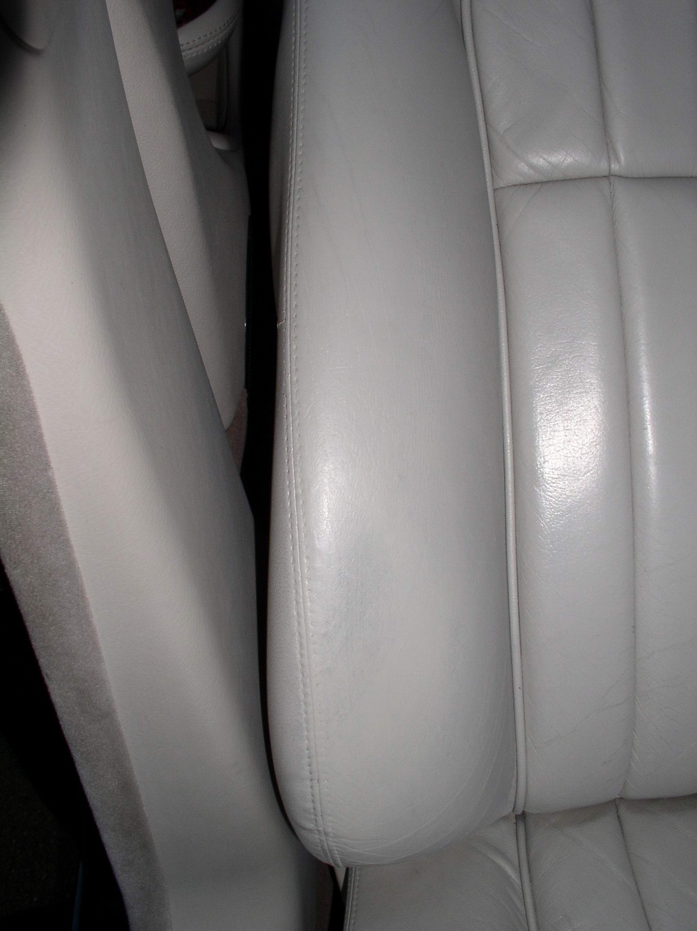

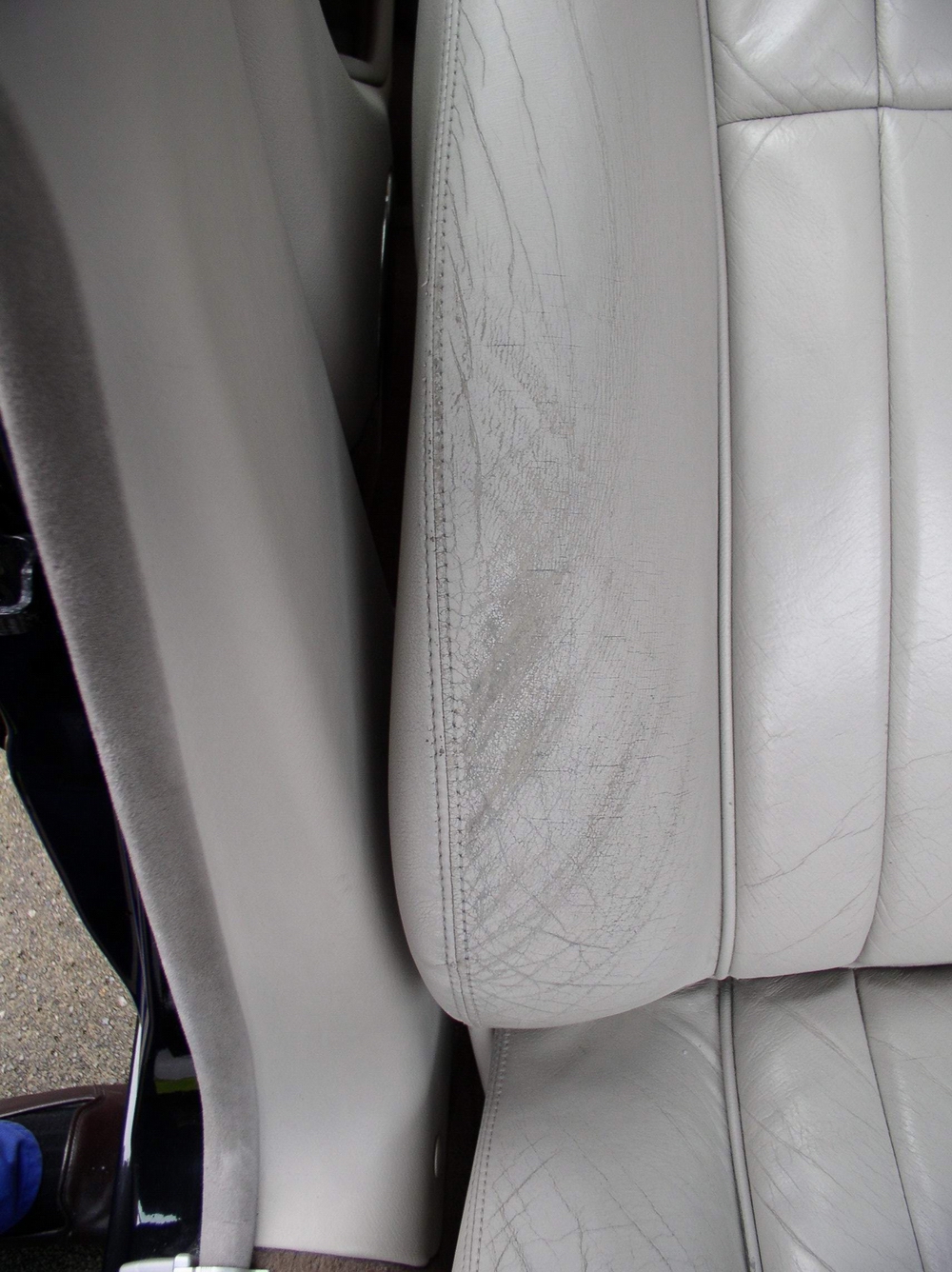

Here's a 'before' and 'after' example of the driver's seat in an X308 I had a few years ago:
Those Pesky Worn Seat Bolsters-03-back-lh-cleaned.jpg Those Pesky Worn Seat Bolsters-04-back-lh-dyed.jpg
I used a Gliptone Scuffmaster kit but others have posted similar results using the Leatherique equivalent.
