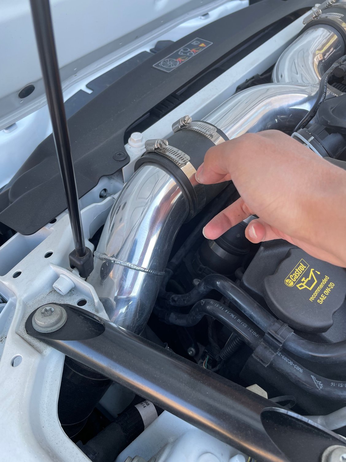

Just found a loose hose clamp on the top intake tubes, out of the visible 4, 1 was loose enough I could rotate it with no effort, could this cause an isolated misfire?
Not clear where. In general, vacuum leaks can result in random misfires.
Do injector cleaner with PEA, then if you still have issues look elsewhere.

this one, moves freely by hand, the one next to it and the ones on the passenger side don’t move.
I will grab a bottle of cleaner on the way home, is fuel cleaner same as injector cleaner? I think auto zone carry techron and Lucas.
