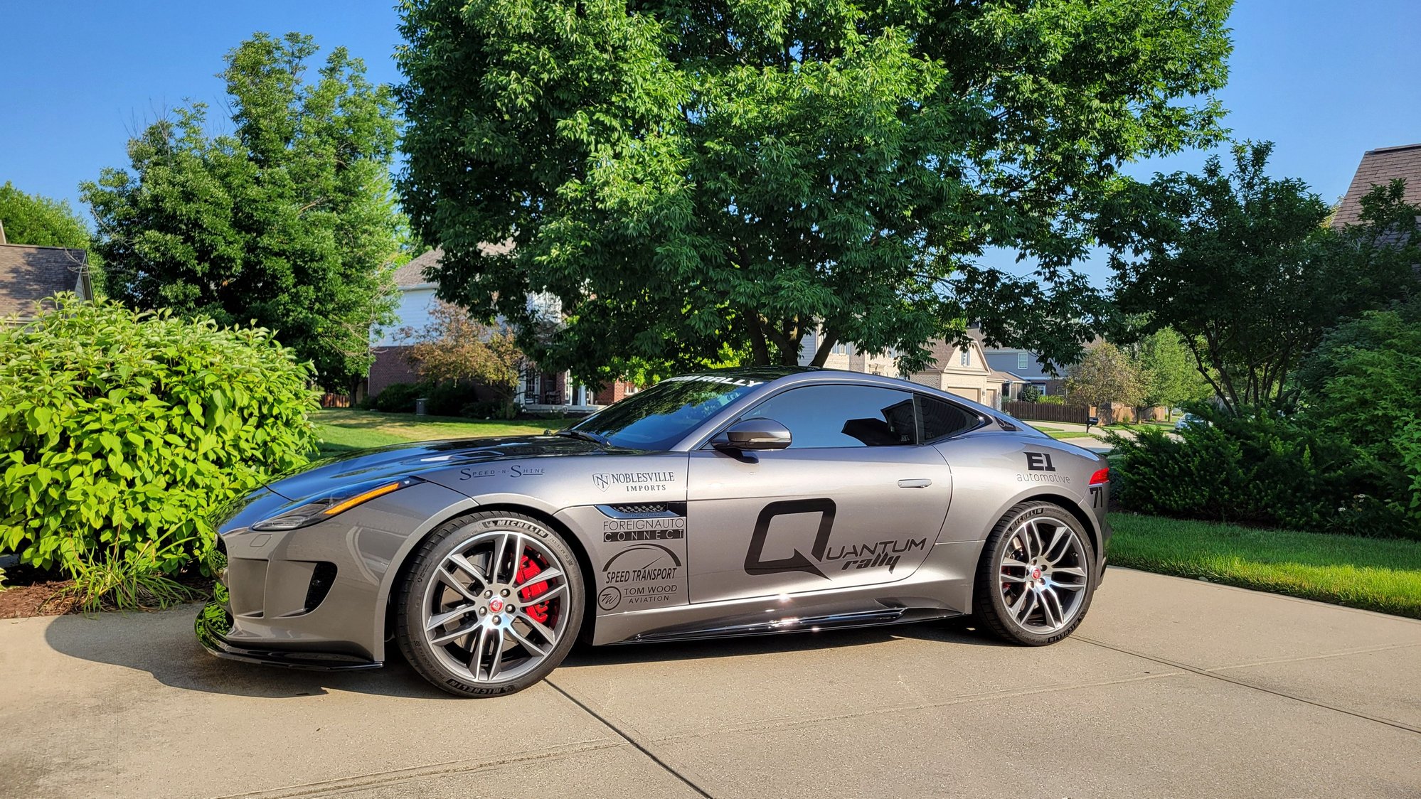

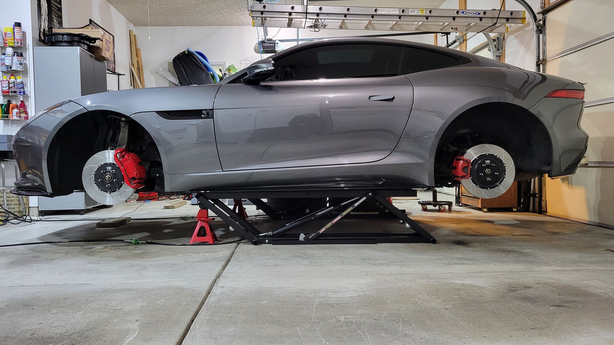

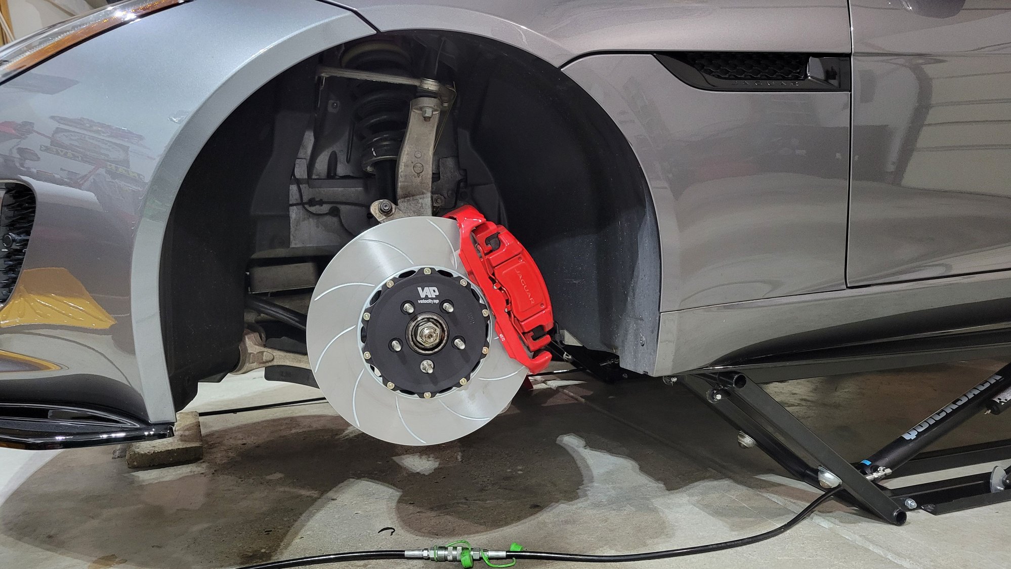

Based on a lot of positive comments, I went ahead and purchased the VAP/Girodisc 2-piece rotors. Below are some pictures. I have done three track days and a trip to Tail of the Dragon and have been very happy with the braking performance. The slots appear to create a bit more dust, but temps are lower and braking is very consistent through a 20-minute track session.
The slots will remove brake dust and dirt from the surface of the rotor creating better pad-to-surface contact. However, that is at the expense of that dust going everywhere else but staying on the rotor.
