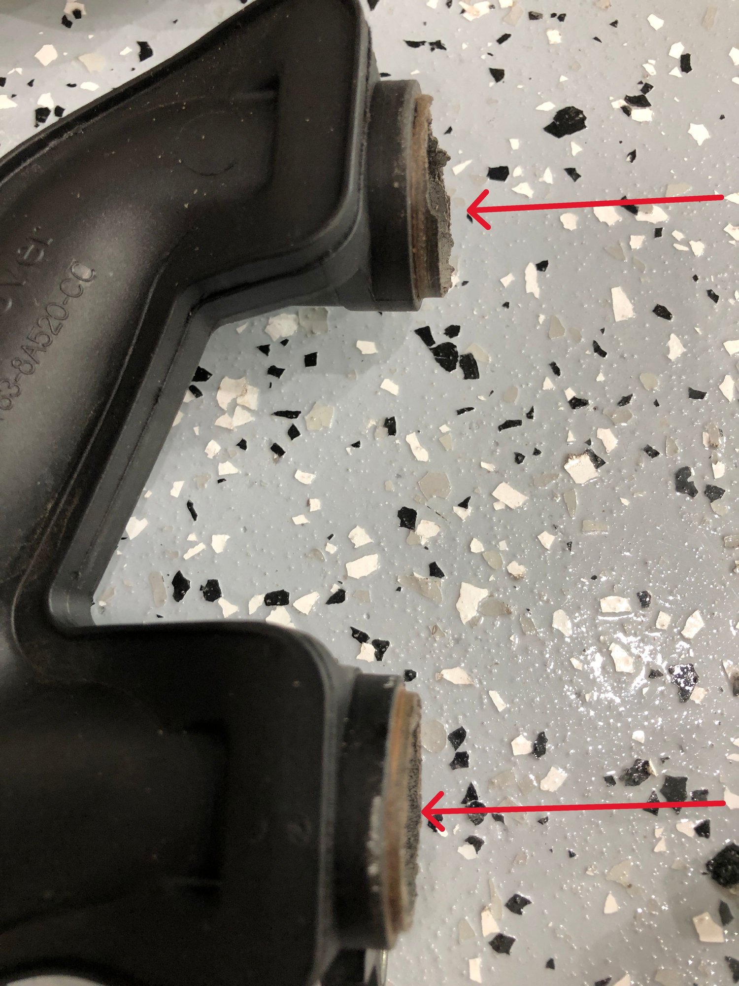

I have a 2018 V6 and the Y-Pipe failed at the O-Ring ends that extend down into the valley openings. Probably good not to just focus on seams.
