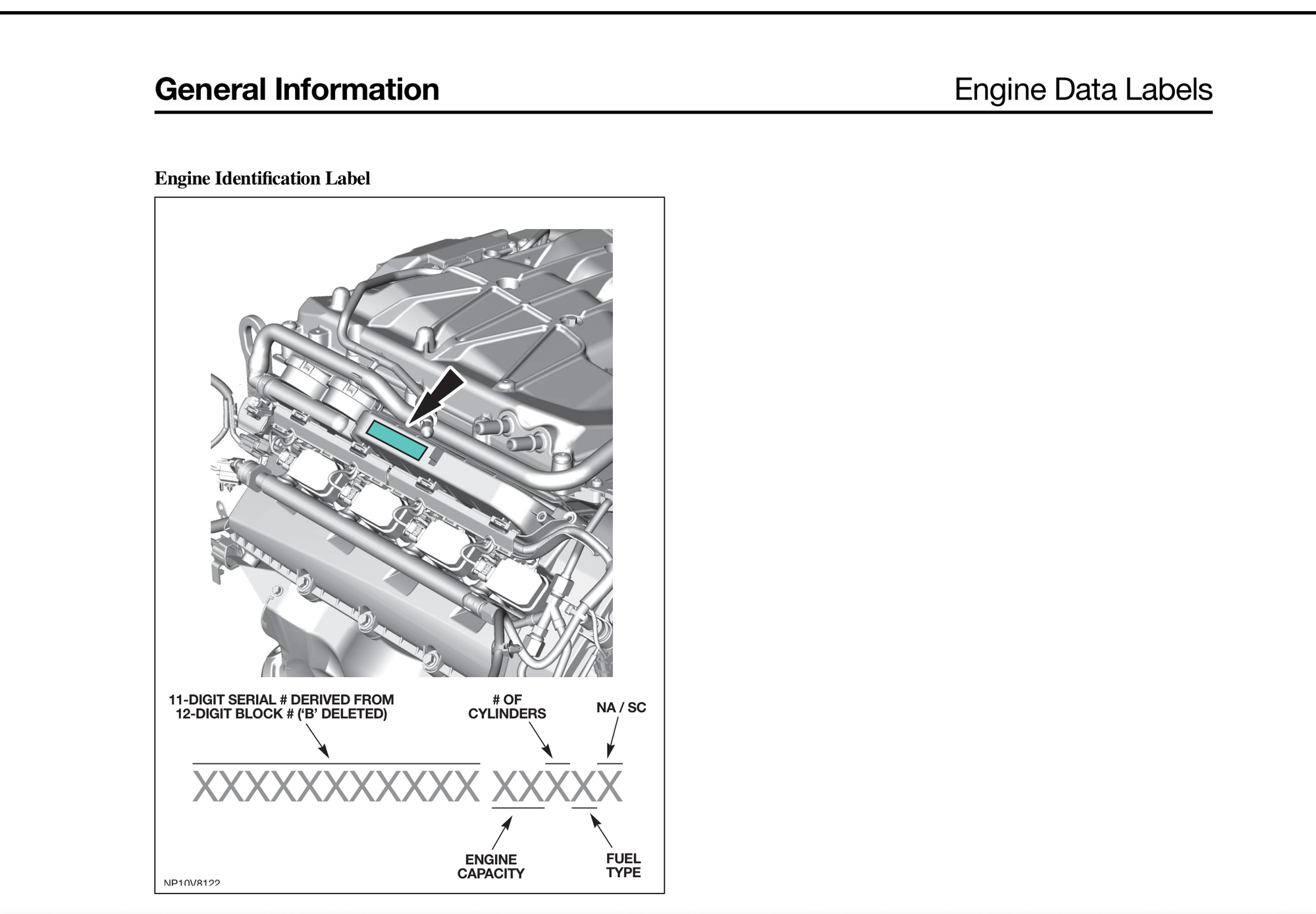

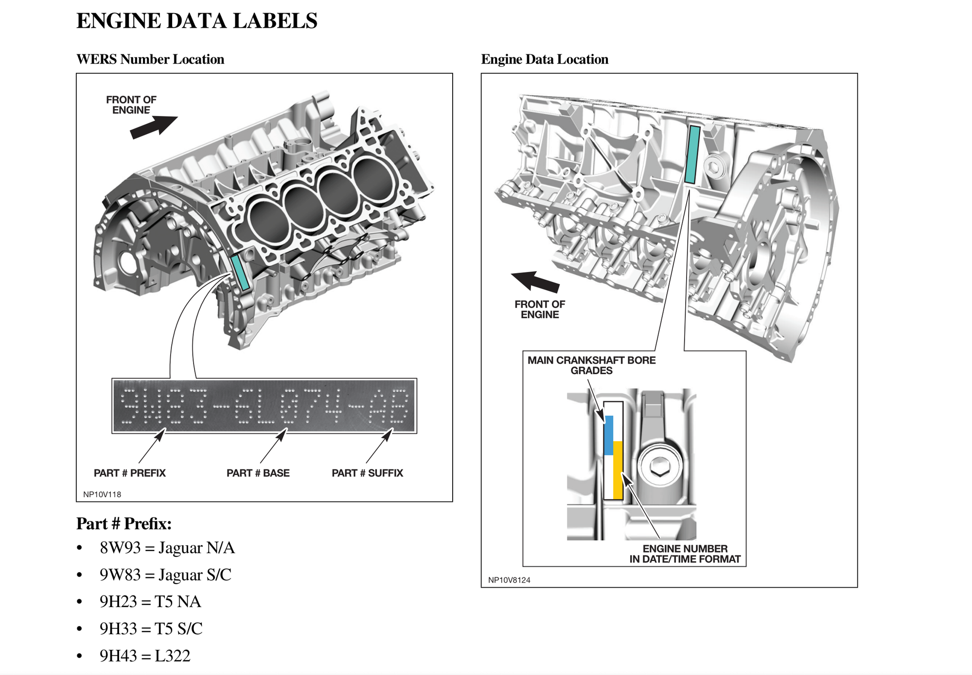

This is in the AJ133 (V8) training doc, but I can’t imagine the V6 would be different.

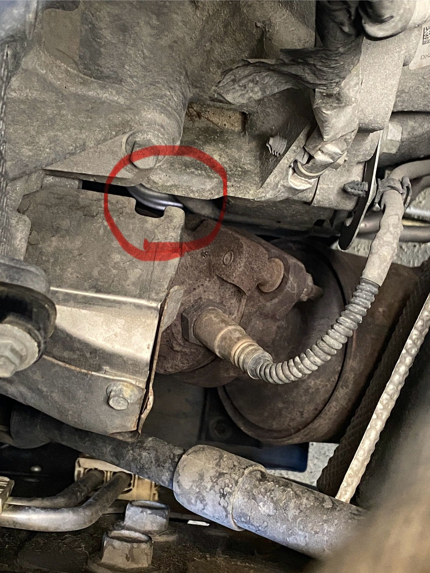

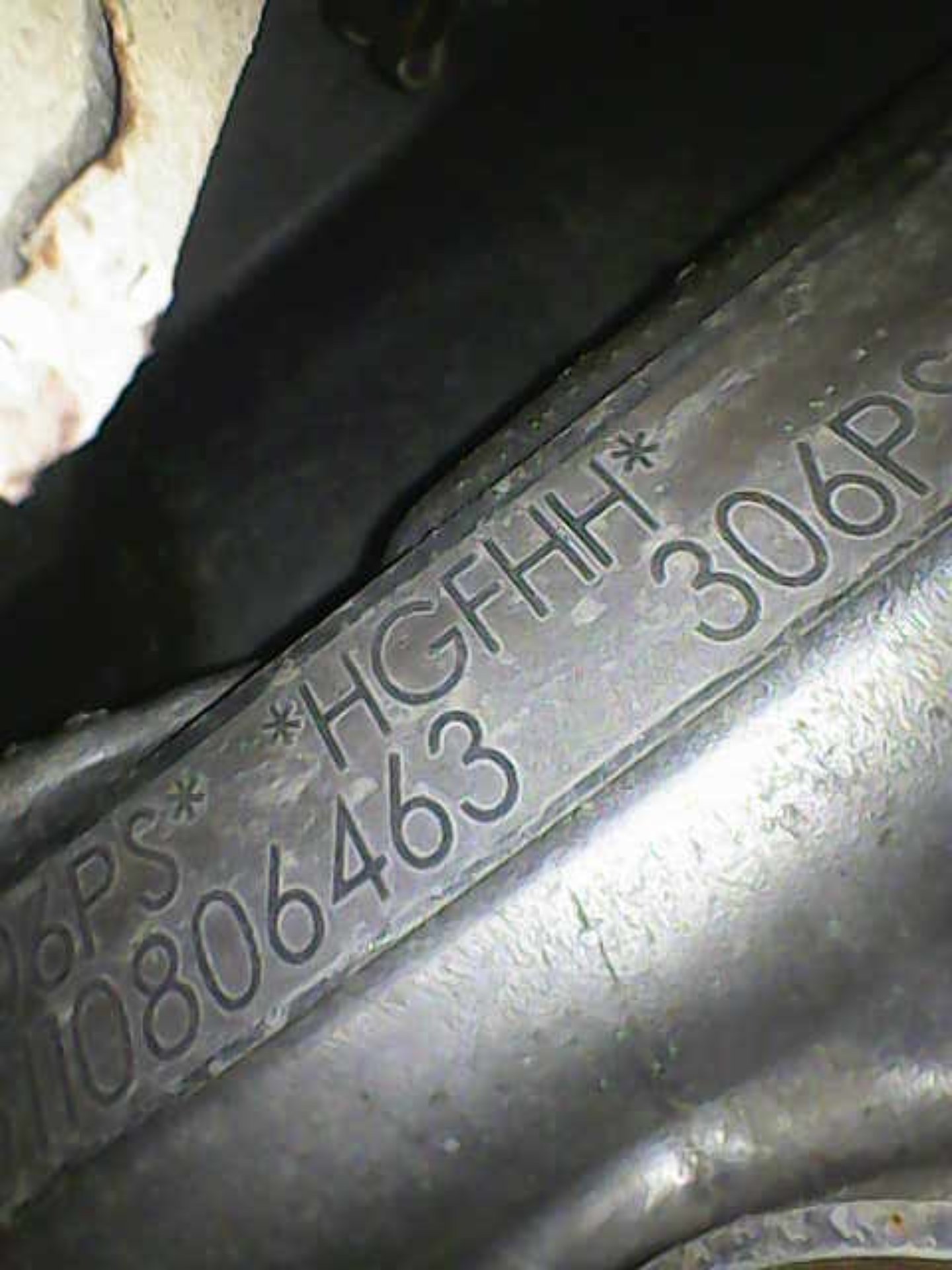

I found the right side engine serial number plate attached to the cam cover. The engine block one was a bit more difficult. In fact without a side facing endoscope it would have been impossible to find. The engine block one though is important for verification for customs import.
It was at the rear left corner of the engine block.
Endoscope was dropped through this notch from above.
