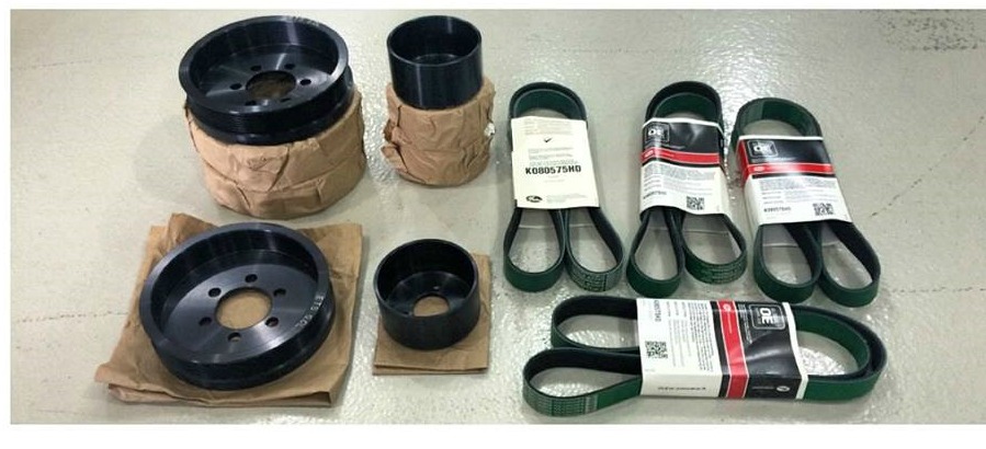

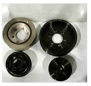

Rover kits shown, Jaguar kits similar (lower pulley the same).
Mike
Attached Thumbnails V6S Tune-11039084_1112709095422232_1620767787481760121_n-copy.jpg   V6S Tune-11046852_1077556205604188_3131222908373579178_n-copy.jpg
