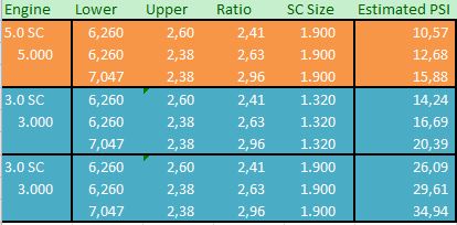

You can plug in the numbers to the formula and see which makes sense:
Theoretical Boost = (((Supercharger size in liters x Pully Ratio) / (Engine L / 2)) x 14.7) -14.7
It would be poor engineering to have the same sized supercharger for significantly different engine displacement.
But then again, Jaguar designed their V6 to be identical in size to their V8 so all logic goes out the window.

Fully agree, the boost values will already show that there is a different supercharger as mentioned, and that is only logical as you need to size the supercharger to the engines volume to sit within the optimal performance range.
If there was a electronically controlled way, the tuners would have found that by now already.
Now there is still an interesting option for the V6 owners, and that is as far as I know the engine block dimensions are the same with the V8 ones, and that means that most likely it will be easy (ie maybe with some small mods) to place the V8 1900 supercharger on it. You may need to get even bigger upper pulleys to reduce boost somewhat ;-)

Yours for instance (ie 1st post), but that wasn't even needed considering the boost calculations.
I just used the theoretical calculation (with small mod to come close to more realistic levels), and I guess the table below speaks for itself, but don't take these as exact values, its still just a ballpark.
Edit: As I don't see any expected jump in boost on your car with the pulley change, are you sure all limiters have been removed?

I originally thought that was accounted for by the difference in pulley (which is not a separately listed part, but the SCs now appear to be a totally different.

maybe didn't read it right (am in a denial phase that I need glasses ;-)), it would have been about 2.5 difference from the 66 pulley size.
Attached now only the V6 pulley sizes, so you see the values I get.

I am assuming the final column is showing boost. The -2.5% is showing a 0.73psi boost increase of 4.6%. I would have expected less than that given the lower isentropic efficiency at those SC speeds (~65%).
