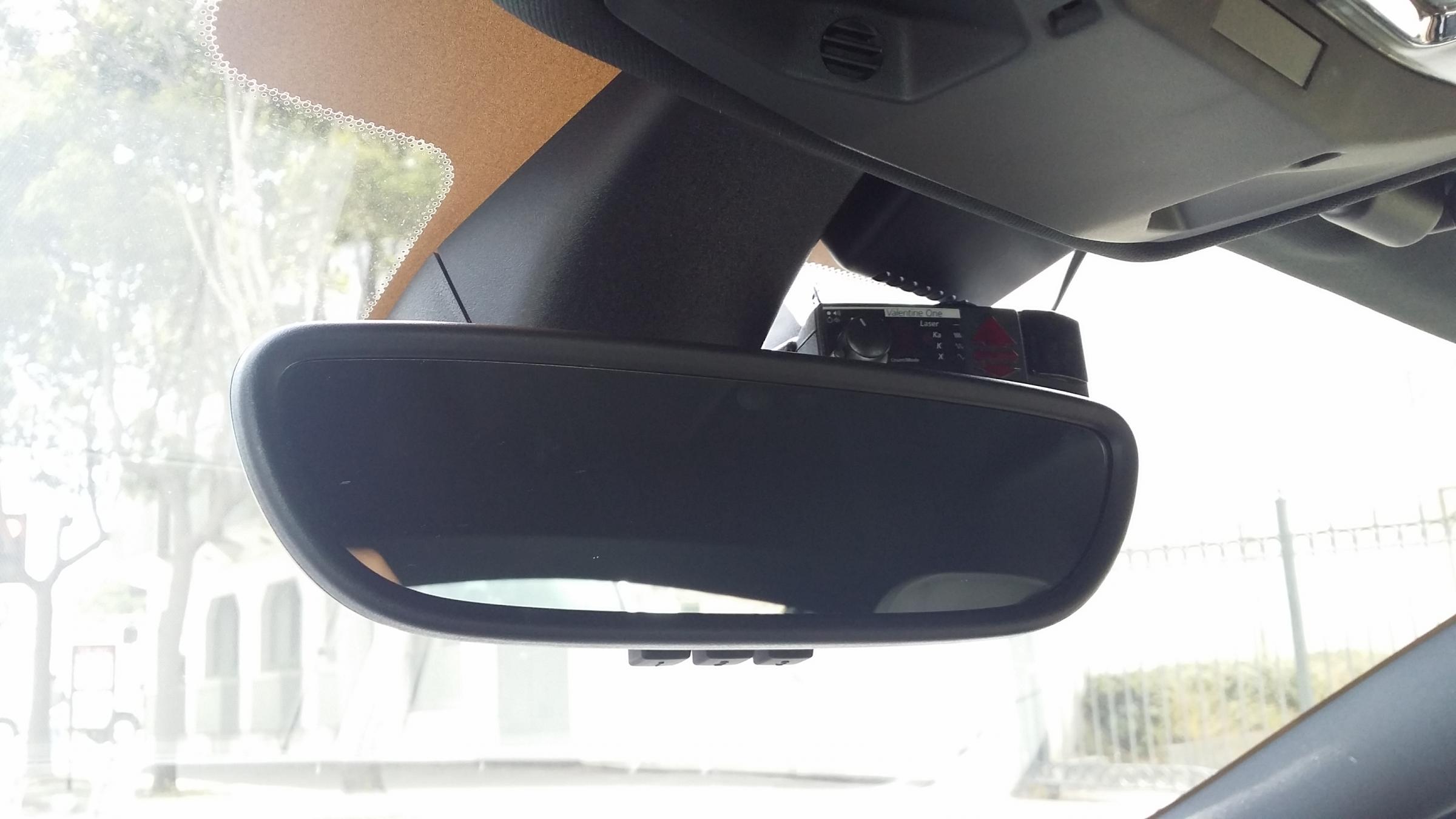

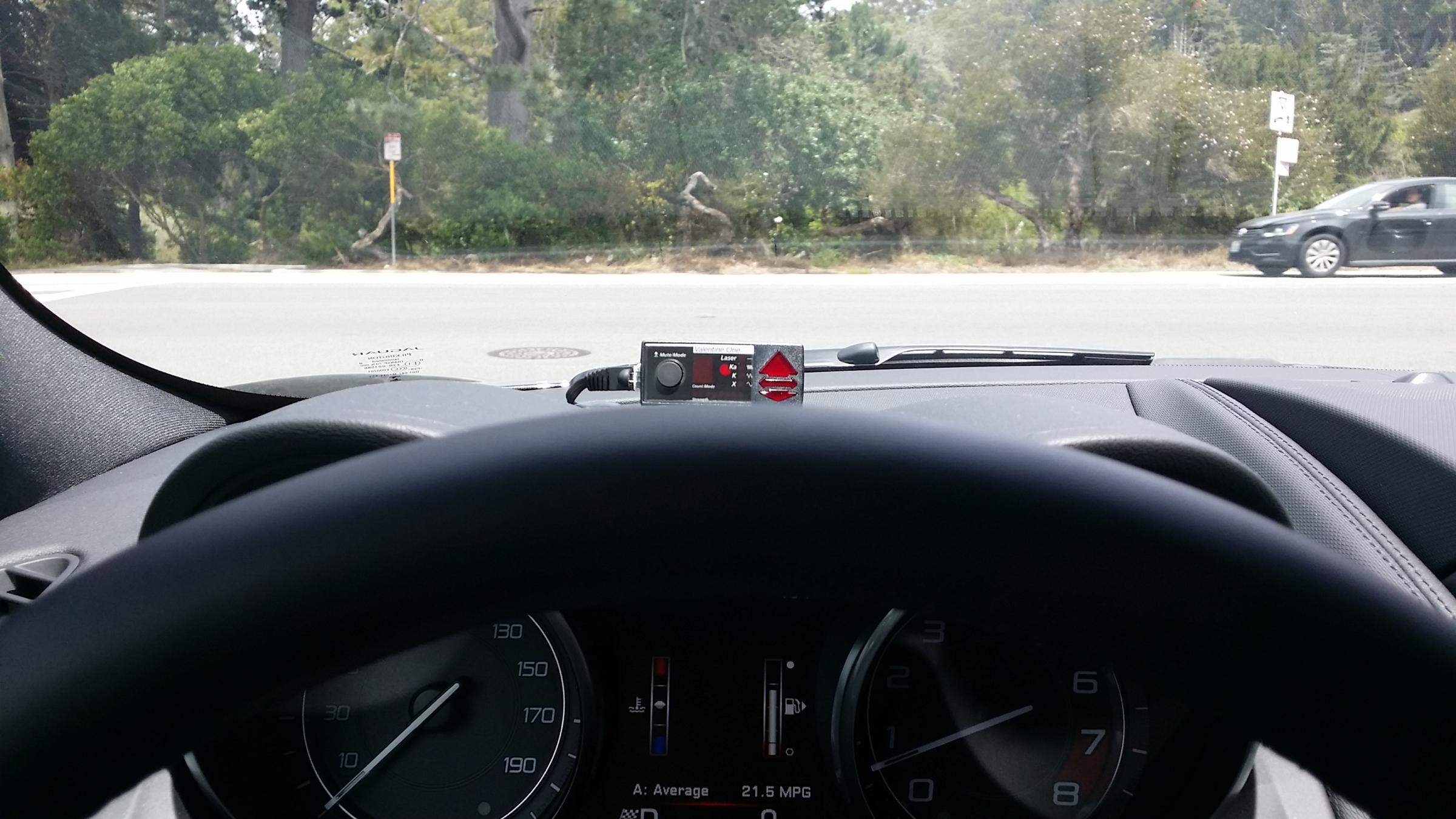

For folks interested, here's my install.
I used the Valentine One main unit, the concealed display, and SAVVY.
Placement
  • See the photos below.
  • The main unit slots in perfectly just above the rear view mirror.
  • The remote unit works very nicely mounted on the hood of the instrument cluster (see photo). It looks off-center in the photo but it's actually centered...it's just lens distortion. By positioning it in this spot, you (a) minimize internal reflections from the sun against the windshield; and (b) have it set back far enough that your eyes don't have to travel far off the road to glance at the display. It also sits just inside and at the center of your field of vision so alarms are very obvious.
Installation and cabling
  • The SAVVY unit is dead easy to install. The OBD connector is just under the (USA) driver side footwell, near your kneecap. I'd recommend a
    right angle connector right angle connector
    to minimize the plug profile. The underside of the footwell isn't covered, so it's very easy to run cabling....you don't need to take anything apart.
  • The cable routing should be pretty obvious. The SAVVY unit has sockets for both the main V1 unit and the (optional) concealed display. I had an installer run the main unit cabling up the driver side A piller and just inside the roofliner. The concealed display was a little trickier. There is enough room under the edge of the instrument hood to tuck the cable in so it isn't visible.

Ah come on do it right!!
Put the display in the rear view mirror. You have a very cool car don't string a bunch of crap all over the interior.

Uh. No thanks.
Do you own an F-Type coupe? The coupe rear view mirror has been crafted to echo the exact shape of the rear window...it's a really nice detail. Why would I replace that with large OEM mirror with a flashing display visible to any cop behind me?
On top of that, I still need to mount the detector unit, since it isn't built into the mirror.
Perhaps you drive while staring at the rear view mirror, but I prefer to look forward, so having the display unit in the middle periphery of my field of vision is a better solution for me.

Radar-Mirror.com will install the V1 remote into the Jaguar factory mirror. He did mine with a one day turnaround. A little more out of the way than the dash mount, but much more discrete.
