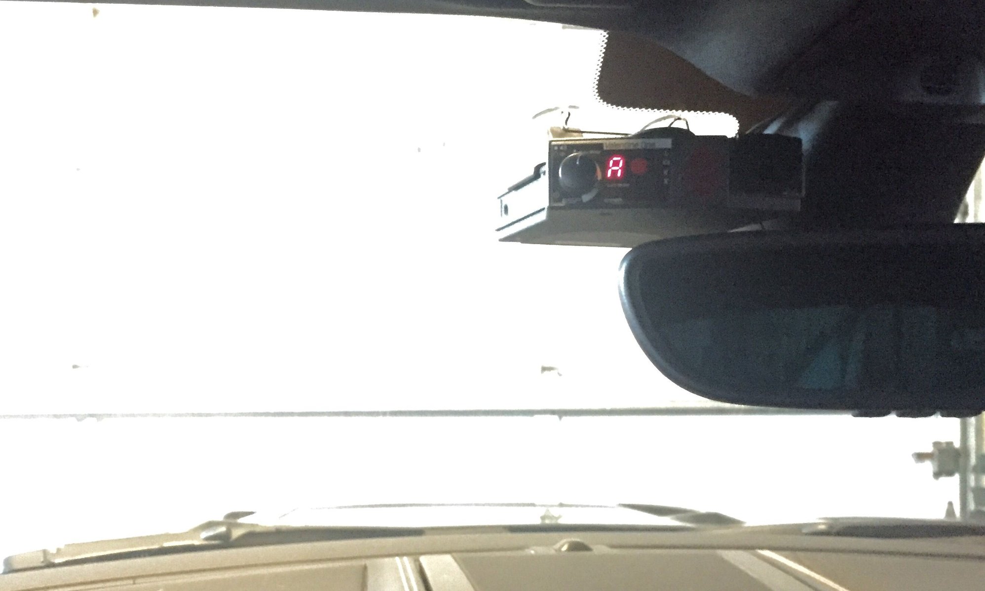

To me, I don't like the OP's set-up with both the remote and the V1. There is no need for a Remote V1. Now all you have is two devices instead of one. Plus the wires are visible from both units.
I mount my V1 on the left-hand side of the mirror. It fits PERFECTLY there, and the power cord is on its right-hand side, so it feeds perfectly out of view as to be invisible. Can I adjust the mirror easily? Check! Can I use my visor easily? Check! Can the suction cups hold it in place there? Check! Can I get a clean signal from the rear-facing receiver? Check!
As for viewing, it is out of the way, but immediately visible in your periphery if it goes off in that location.
I've never had a car that the V1 fits so perfectly. It's fit is IDEAL for an F-Type.

Thanks for the pic. Are you using the plug in cord or did you hard wire? Can you post a pic of the right side so I can see the power cord. It looks like you just used the suction cup mount. Any issue with temp changes and it falling off?

I hard wired it. The plug goes into the right side of the V1, so it's virtually invisible in that location. If you look closely, you can see the wire going into the rear view mirror covering. Yes, suction cups will hold it in place for a very, very long time. Just make sure both the glass and the cups are clean, get all glass and no black dots, and that's that.
