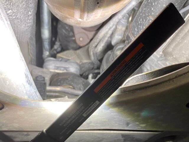

Thanks for the link! I’ll install these myself. The good part of having the off-road version is I can just raise the air suspension and roll under this thing. I crawled under and was able to touch all of the nuts and studs with the under panels still on. Once I drop those it looks like I have a ton of room. I think I can do it with just a crows foot attachment. Nuts on mine are definitely 15 mm. Some how that was a great secret of the internet 🤷🏻‍♂️
I’ll probably knock out the job by the weekend. It’s just the 4 studs and two exhaust clamps plus the 4 O2 sensors. I’d like to do it tomorrow but my schedule is packed.
Here is a picture of the bottom stud on the drivers side. The nut is on the other side but the flange isn’t to big for a crows foot to reach across.

Thanks! Appears to be a bit tighter on the F-Type, but someone did it, so I am going to try Now that I know the Nut size, I can order the torque adapter. When you say "Crows Foot."...Do you mean these? if so, I have a set of them!

Exactly. I have access to a lift so I’ll put it up any try some penetrate spray to loosen them up. The Crows foot only has two solid contacts opposed to the torque adapter having six. Mine is still pretty new so there’s a chance the crows foot will work. If not I’ll back out and get a torque adapter.

You need a multi point torque adapter with at least 1/2 inch neck in between the 3/8 and socket otherwise you won't get a solid seating due to the cats being so fat and offsetting your extension. Snap-On sells long enough offset adapters. Enjoy!

I have been searching all over for a 15 mm 3/8" Torque adapter with no luck. I hate to buy a whole set, as they are steep. Another option I may try (What I did for the headers on my 997 TT), is to use a box-end wrench, and heat it and bend it with a torch then cut the bottom off and add an extension/breaker? Mine is pretty new and clean looking as well. Plan on a little PB Blaster soak, and then go at it...

‘Good point, I did this trick installing the downpipes on my GTR with a crows foot, swivel joint and 36in extension. Though the TQ adapter looks like to better tool for the job.

Ok, after supersportml said that I realized I’ll just do it the right way the first time and I found out Napa has the 15mm TQ adapter for 15.99.
https://www.napaonline.com/en/p/CHQTA38115M
