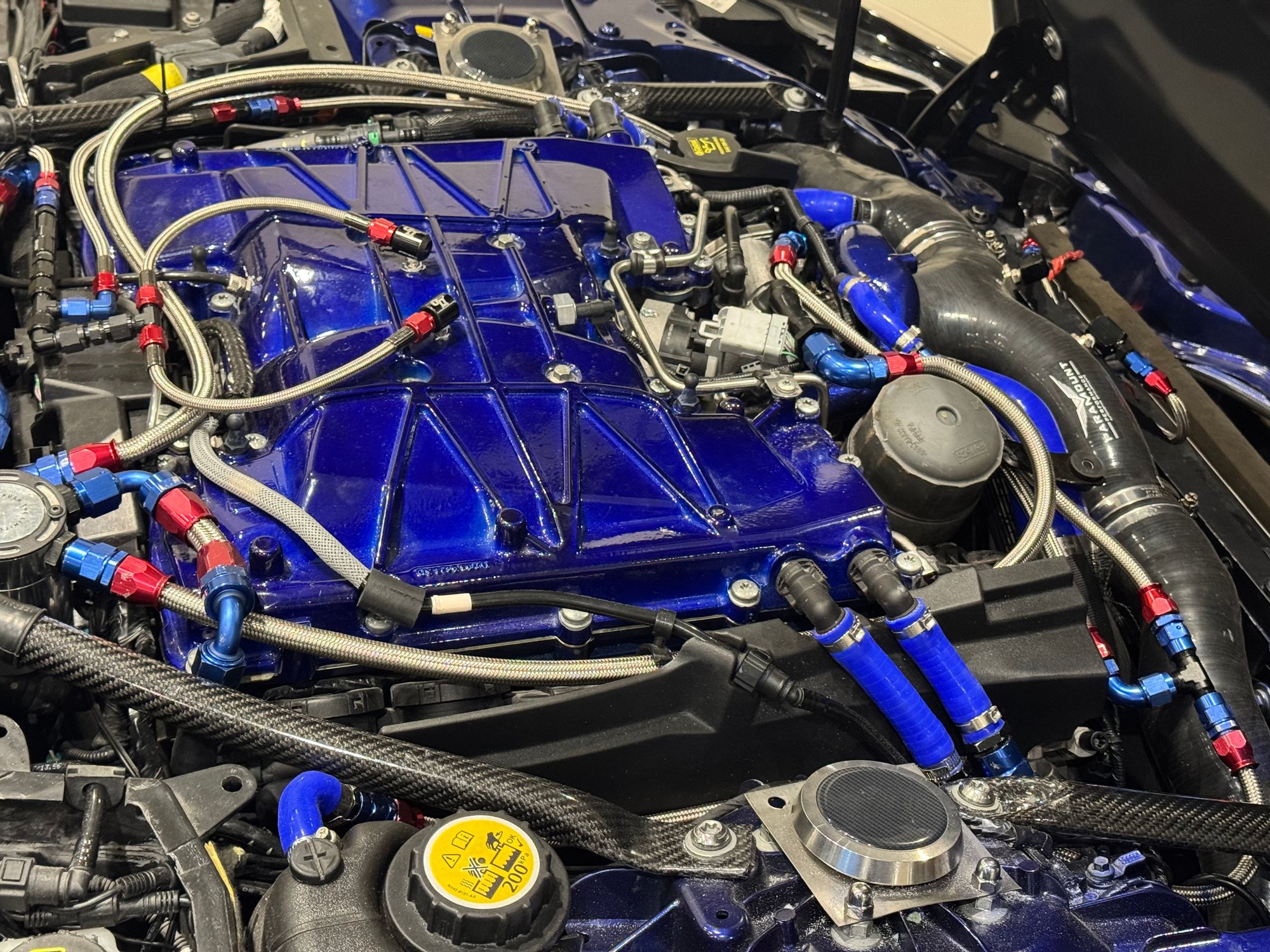

I am truly in all of your engine bay, thanks for sharing.
How much did all the plumbing cost - sorry to be so bold but I'd love to copy that...it is awesome.

I did it all myself but it’s really just braided ptfe and fittings so not a huge cost

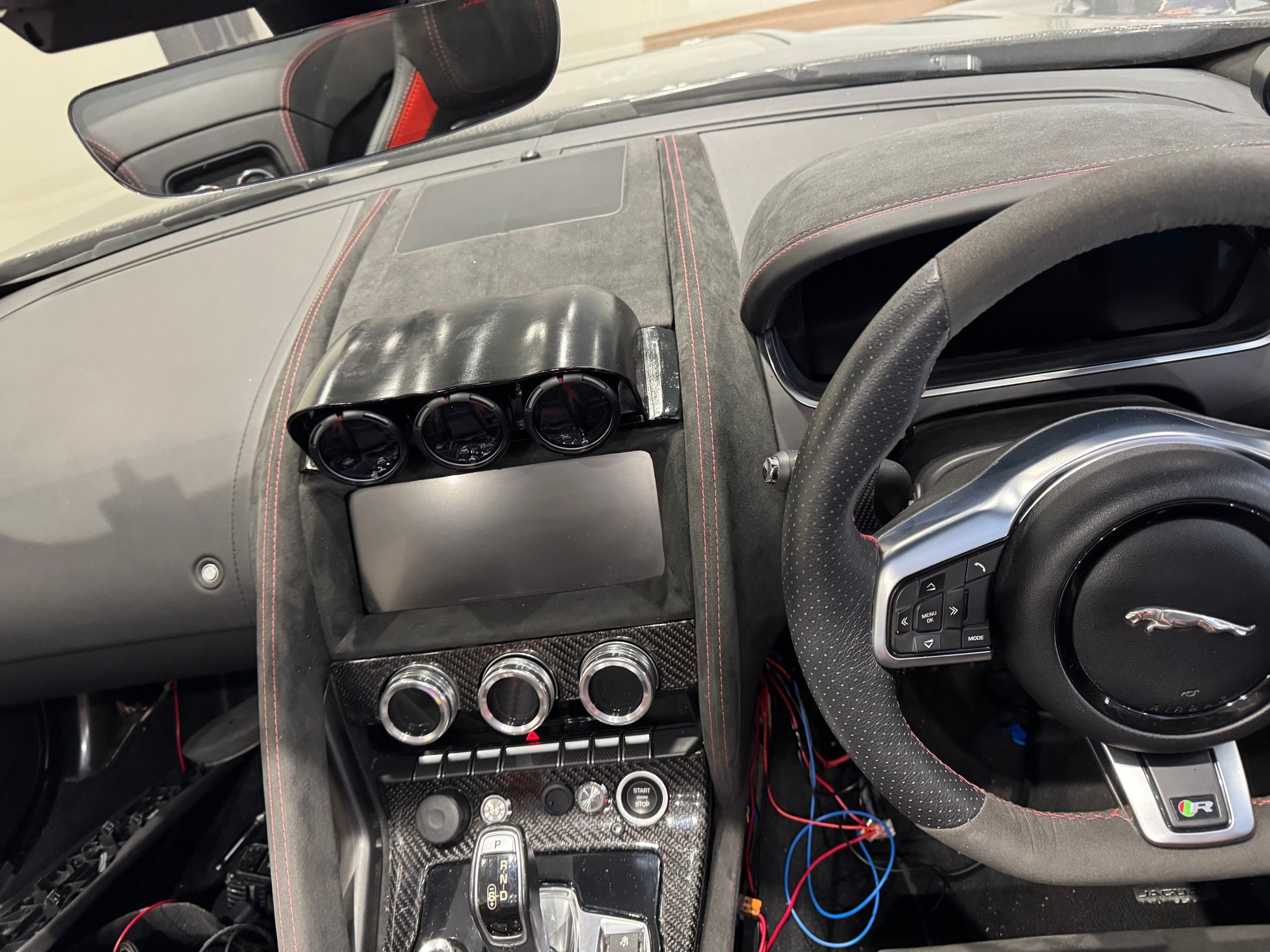

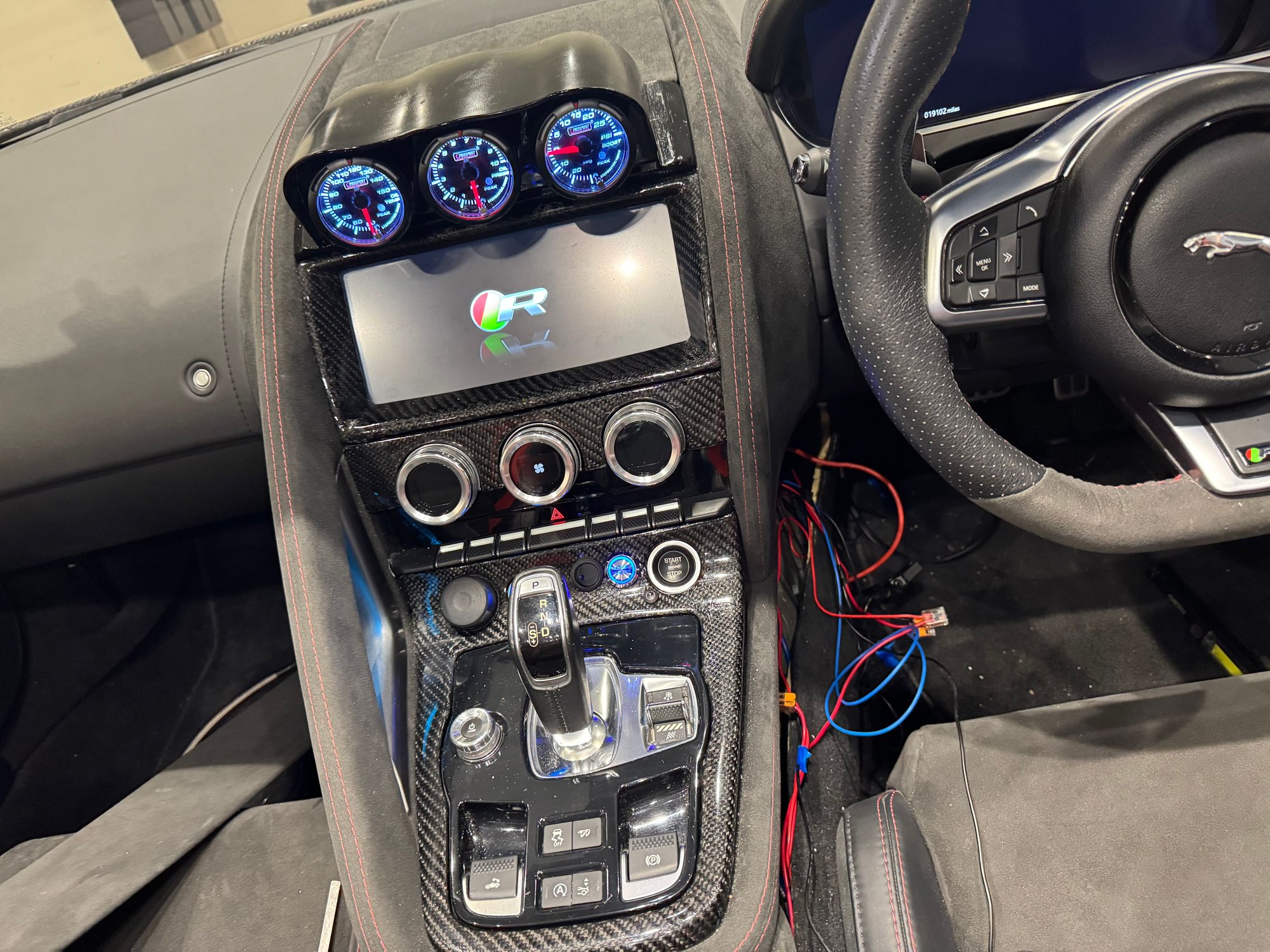

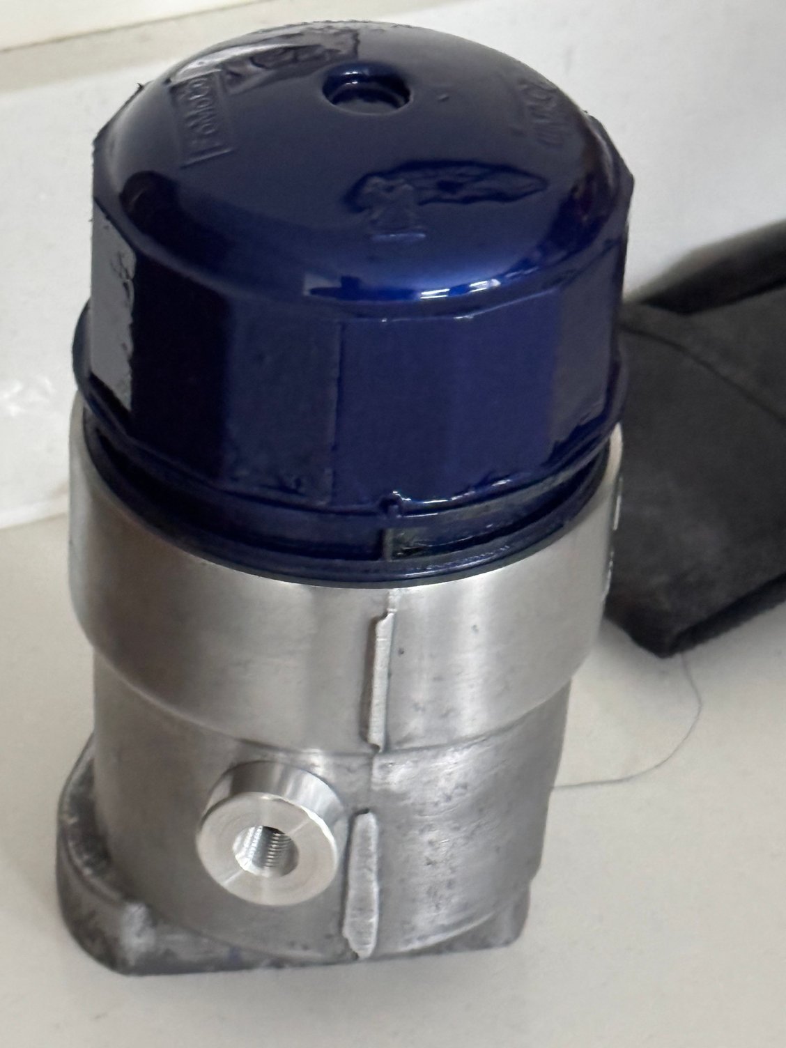

this will be my oil filter with a welded take of for oil pressure and oil temp guages the gauge pod is due to covered in alcantara

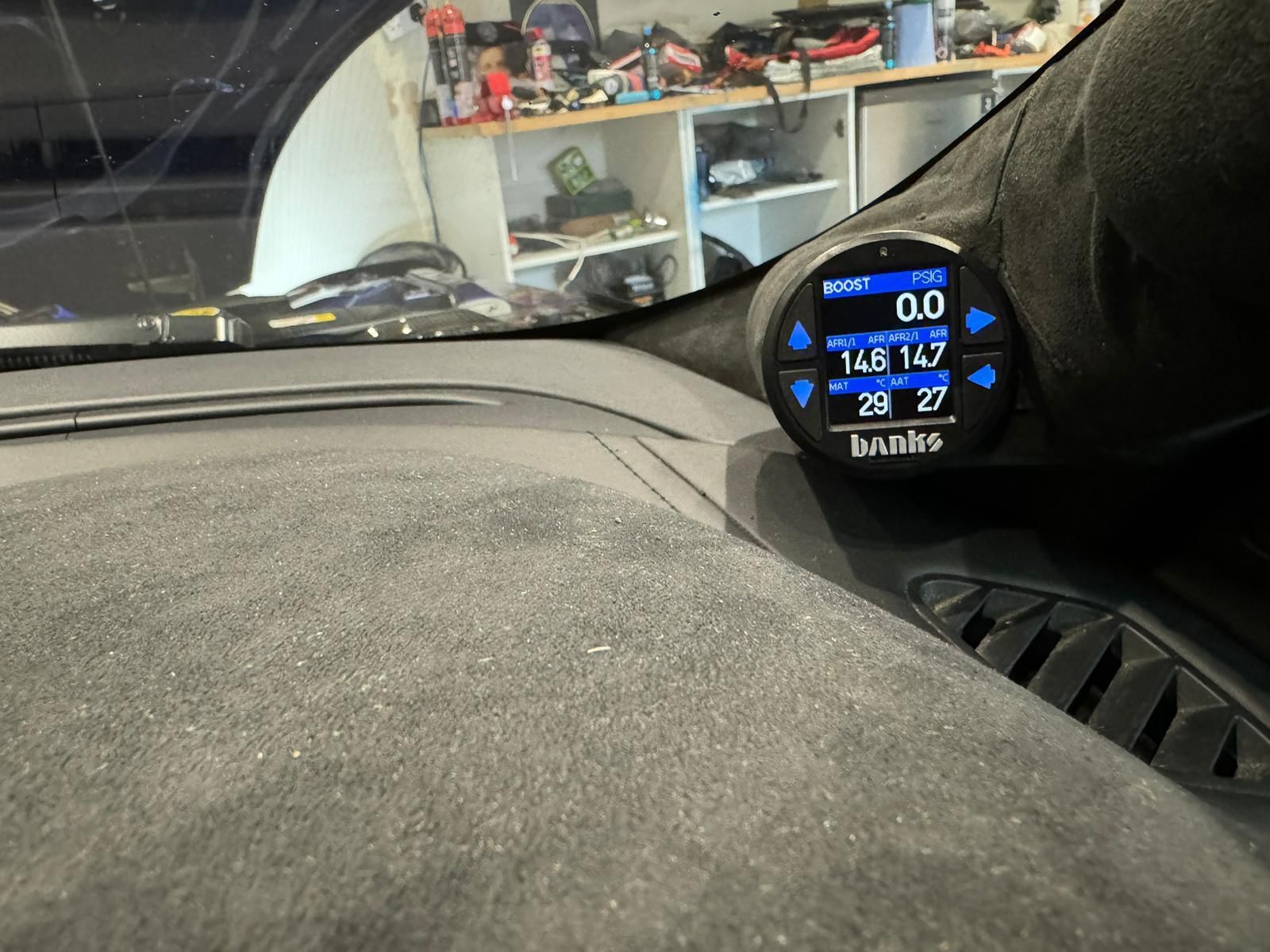

these figures are directly from the ecu via the obd port and a Banks guage

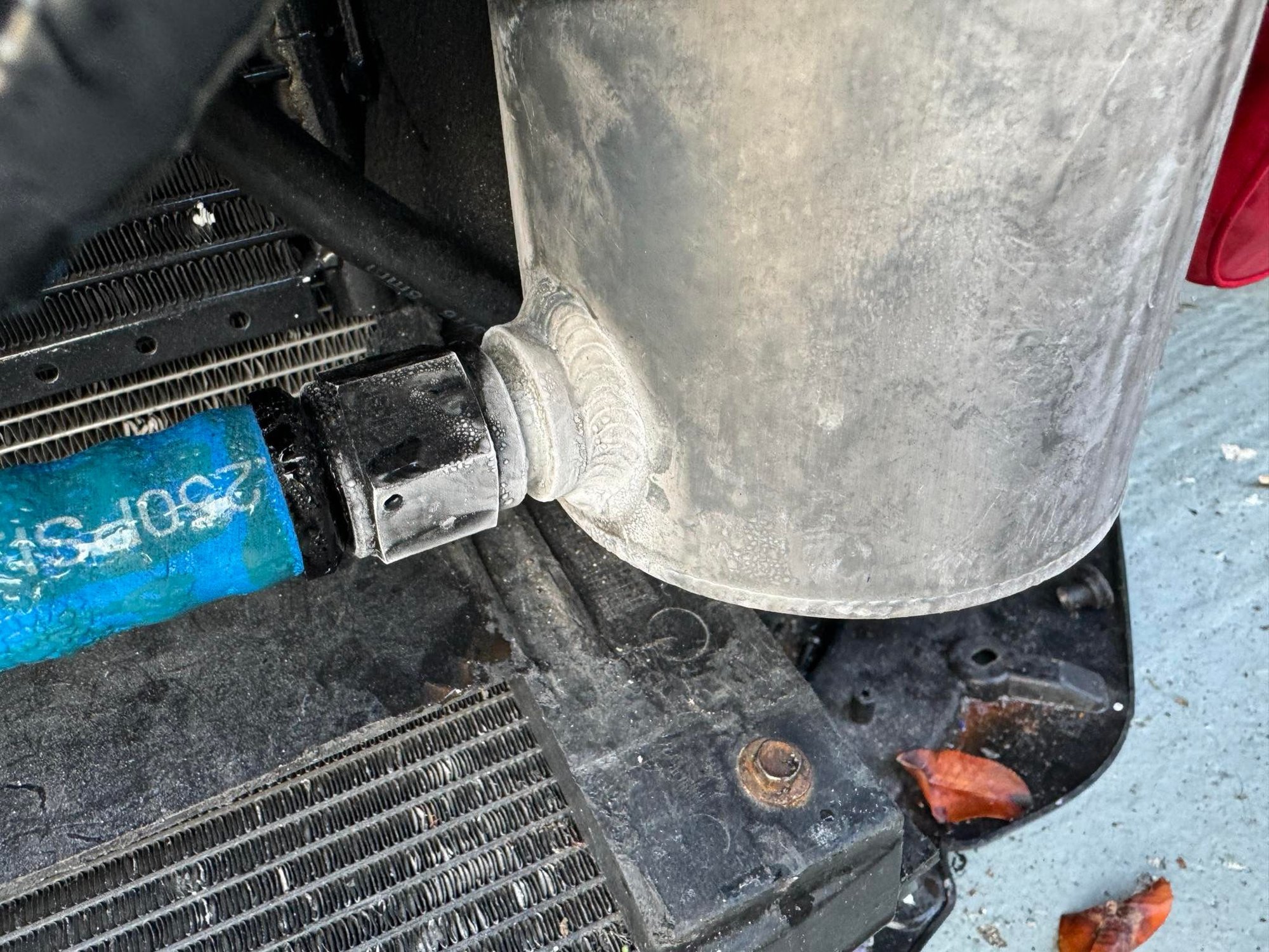

i am running a fi interchiller stage 2 and totally separate water supply and reservoir
that’s my return reservoir with ice on it after it’s been through the charge coolers
this is sitting in my garage with zero airflow through the air con condenser
