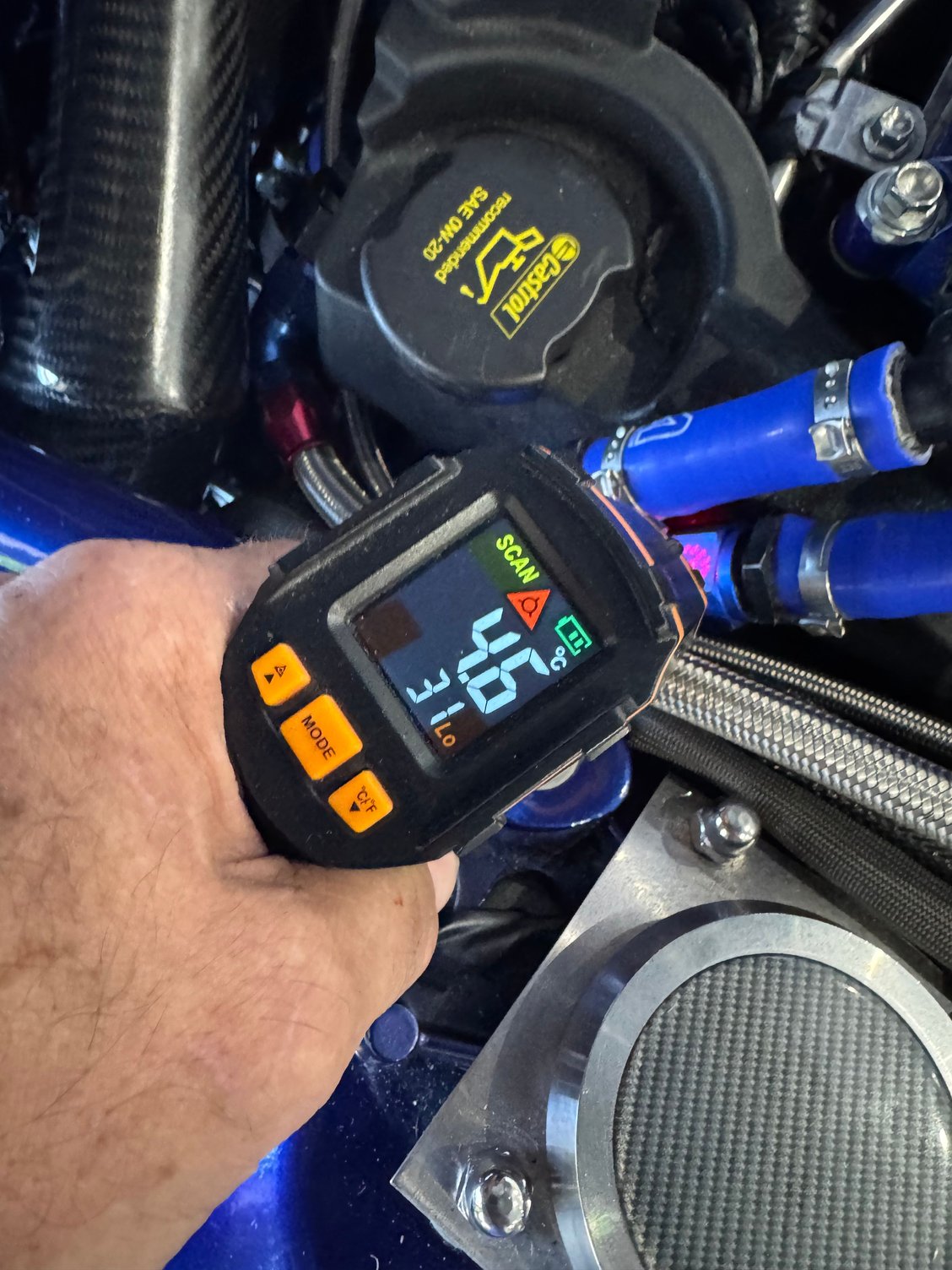

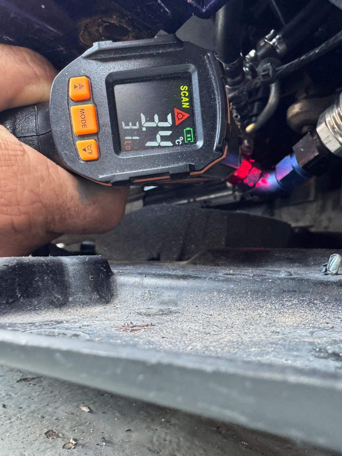

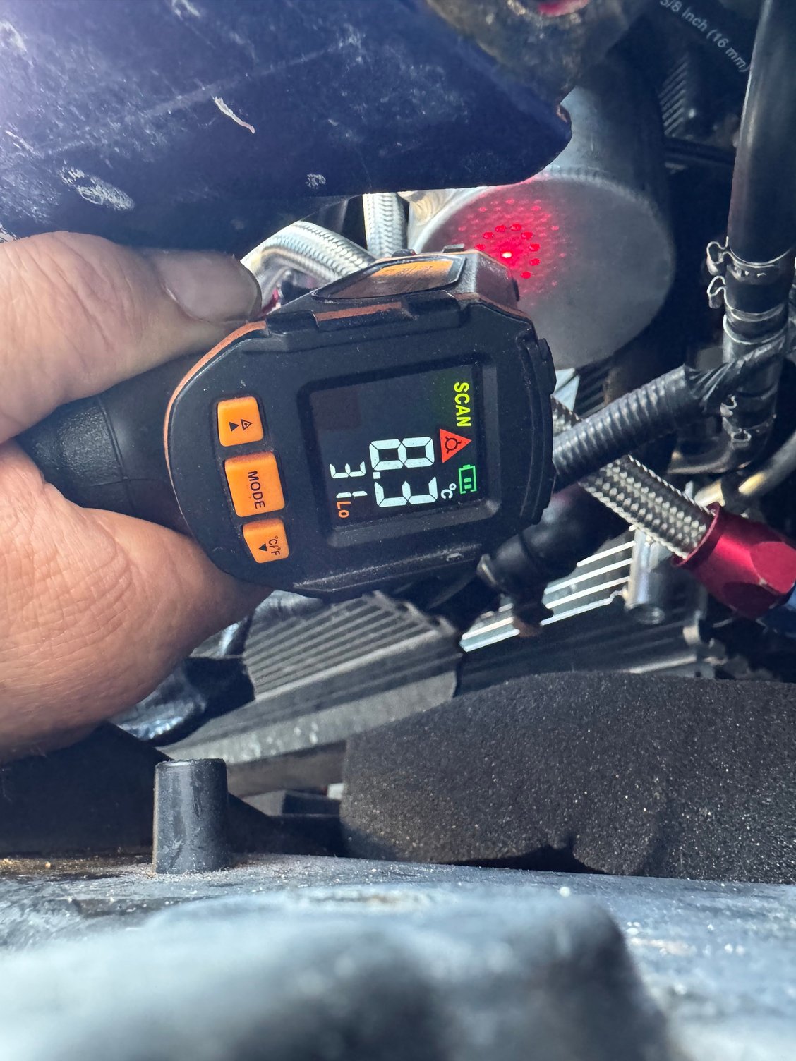

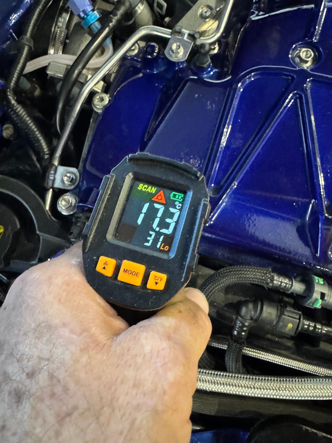

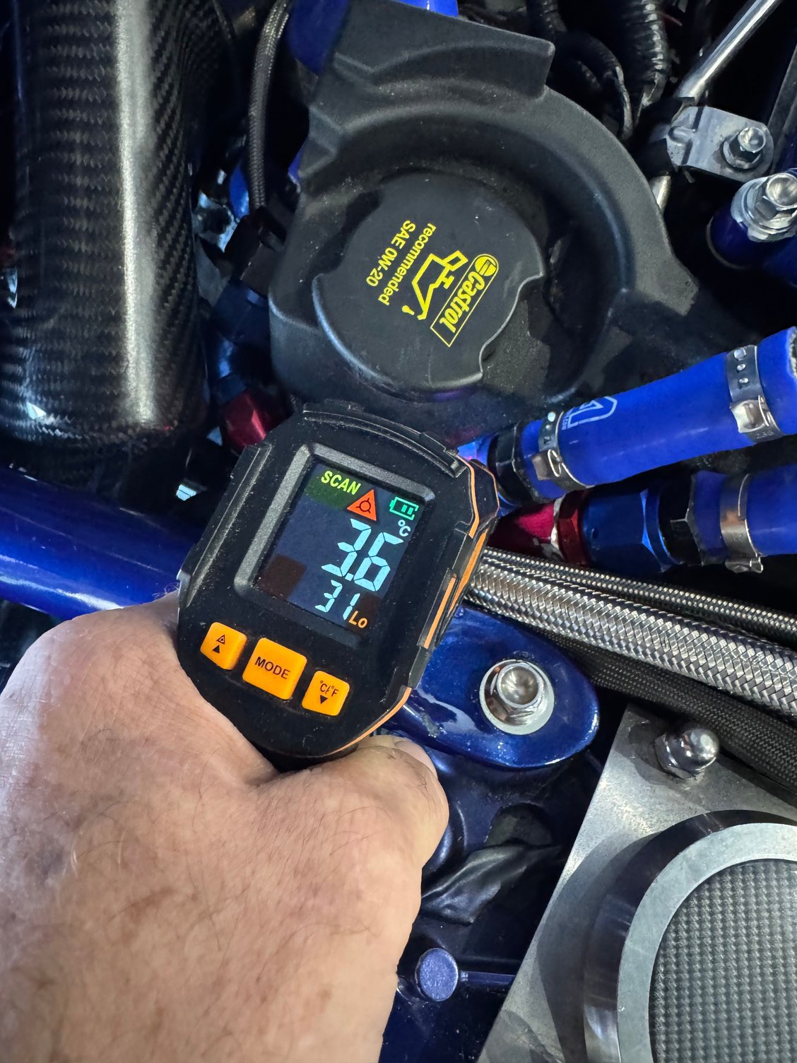

Been tied up with a broken coolant fan and a leaking rad so decided to rejig my setup
ready to finally get soma datalogs this week
my chiller and intake temps are awesome
my supercharger lid at operating temp is 20deg less than the average human temperature

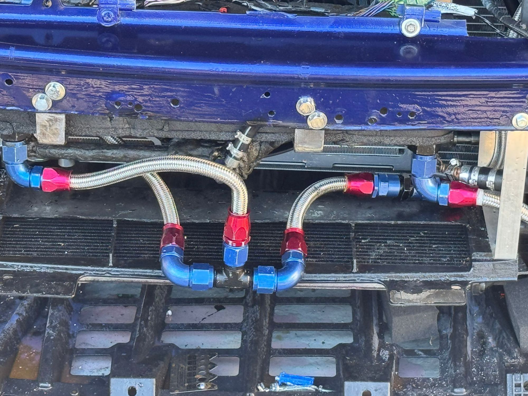

Rejigged piping
turned chiller upside down and it allowed me to simplify the pipework

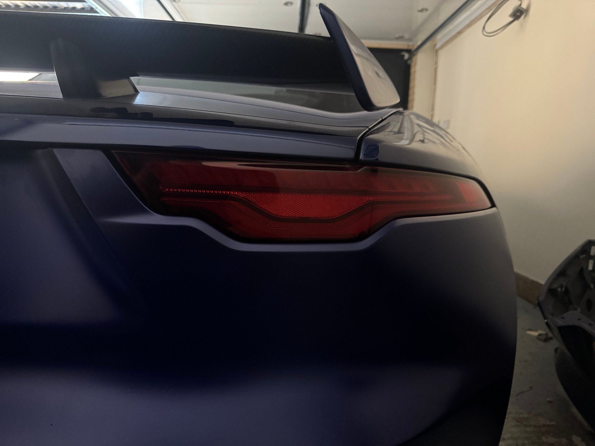

Got sidetracked a bit
after replumbing everything I decided to update the rear lights with facelift versions
