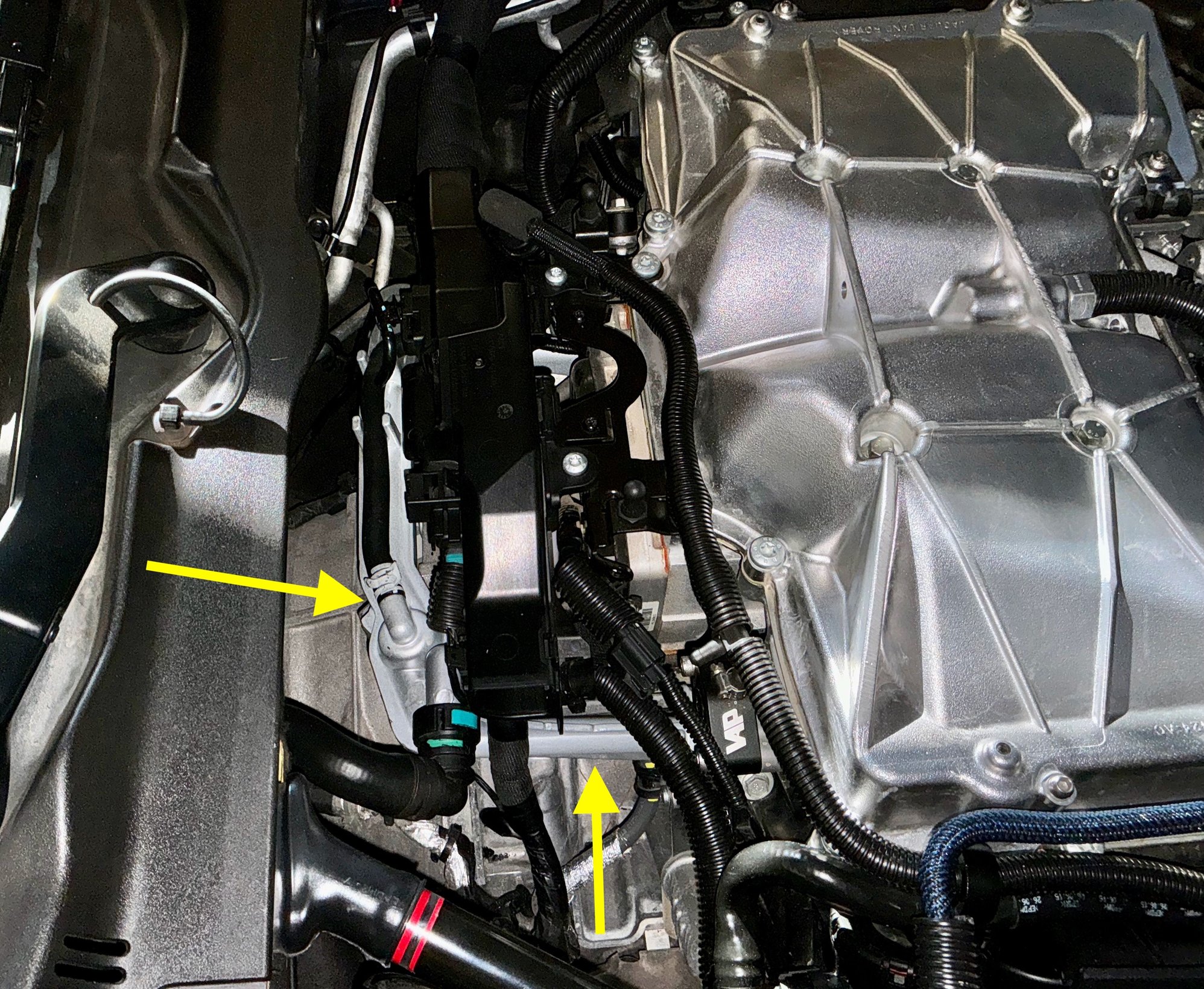

Originally Posted by Therock88
That is a great add. I realize after looking at your post how much more room the V-6 has...Wow! I had no idea

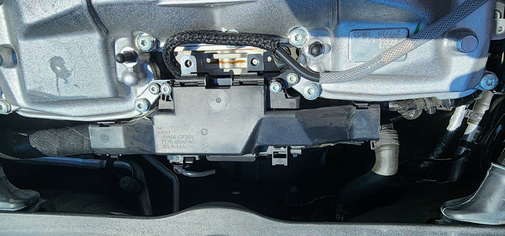

It's definitely a bit tight with the V8. The bottom bolt is relatively simple to access with the symposer removed (as shown below), but even my smallest 1/4" ratchet with the shortest hex bit wouldn't fit between the upper bolt and the coolant crossover pipe. I guess it's time to invest in an extra short bit set...
Anyway, it's a very nice piece of hardware and definitely an improvement the modified OEM part + a silicone plug I had there before.

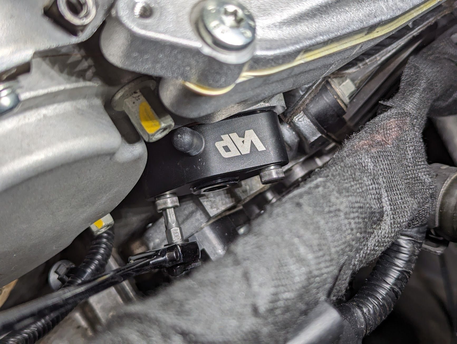

+1, I like the sound much better without the symposer and there's so much more room to access the rear of the engine. The next improvement for me is to replace the monstrous OEM plastic wiring harness support with something more elegant. Currently experimenting with this one:

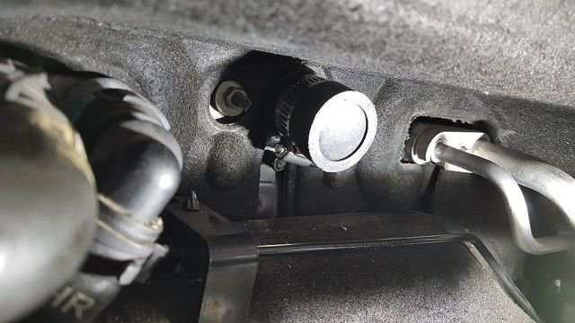

How do you actually close the hole between the engine compartment and the driver's compartment?
Thank you so much for all answers... BR Andi
Old Feb 26, 2024 | 08:13 AM
f-driver's Avatar
Posts: 132
Likes: 67
From: Germany

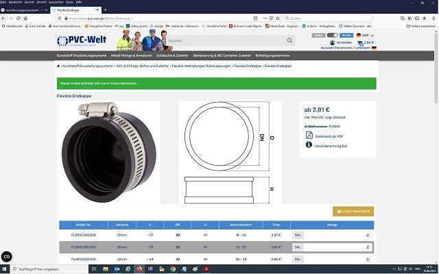

closed the hole with a 25mm rubber cover from "PVC-Welt" www.pvc-welt.de
Grüße von und nach Bayern
Ulrich

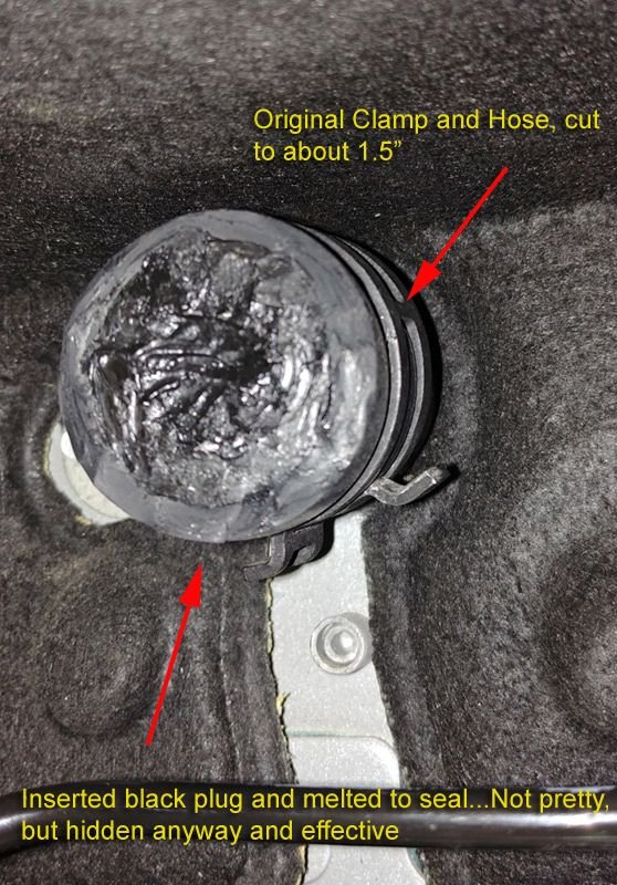

Similar to the other post...I just made one from the original rubber hose and melted the cap with another piece of it and used the original clamp.. You cannot see this part when it is tucked away on the firewall.

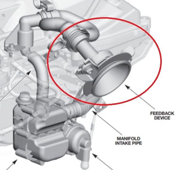

Ray Ray the blue plastic part as posted above is called the trumpet on the forum. But Jaguar calls it "The Feedback Device".
So far all of us have plugged the trumpet from the engine side and left it in place. If totally removed you then would need to fill the hole in the firewall anyway. So it's seems to make more sense to just leave that part be. Plus it's not in the way of anything so no downside.
