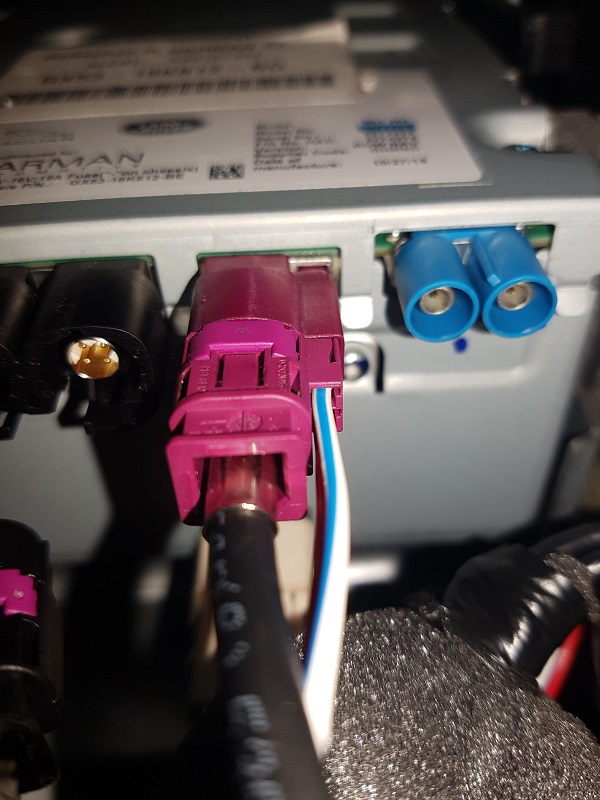

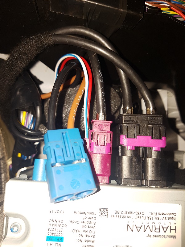

I got to thinking and plenty of trolling and reading on the possibility of replacing the factory head unit with an aftermarket android unit or replacing the factory unit with a different model JLR unit, I hit road block after road block and further investigation I decided to remove my head unit to see if an video aux input was available.

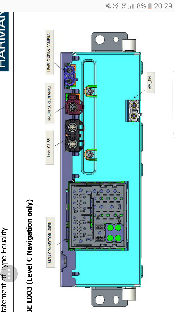

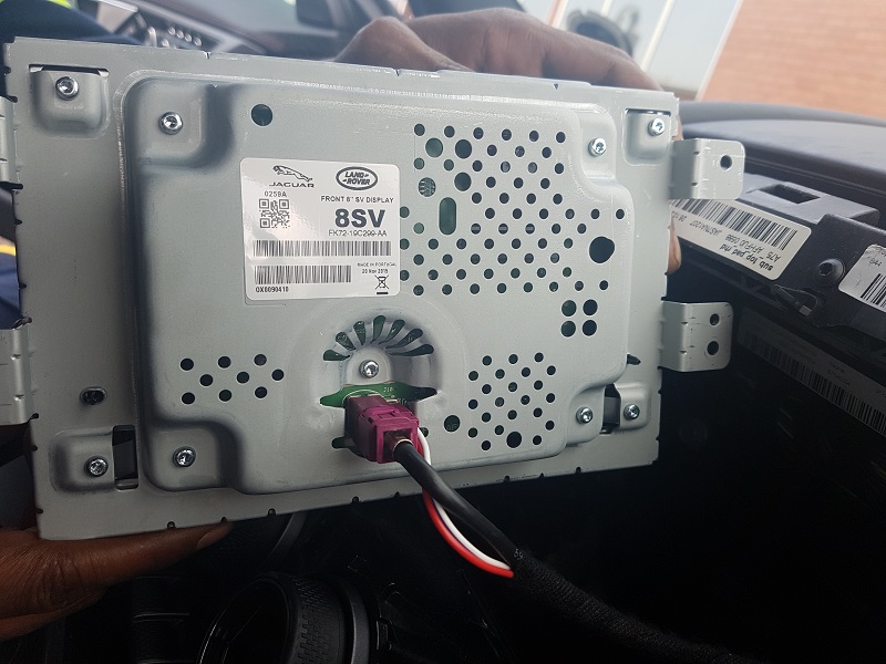

At this point I found out that my (South African) Version has a split unit with just a monitor and the balance of the infotainment under my hand-rest.
Which has a GPS / Video input using a FAKRA connector, this seemed like an opportunity as the camera can be activated in motion.....

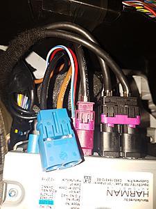

So this is where the planning started. I wanted the solution that I created to be completely reversible so NO modifying factory items. The basic Idea would be there will be two video inputs, the rear camera and android device ( Mirrored Device )
1. Fakra connector / adapter cable - to cut into the signal of the VIDEO IN (CAMERA)
2. Switching adapter or cable kit to auto switch between camera engagement ( Reverse engaged ) and Video 2 - Android
3. Wifi Car Display...
These are the results thus far !!

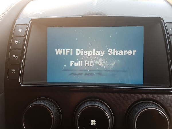

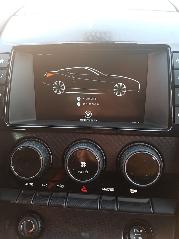

Engaging the camera on the Jag infotainment brings up the CAR WIFI menu, using ANDROID mirroring or IOS mirroring or AIRFUN APP allows for multiple options from videos, internet, music and pictures.
The screen quality is fairly decent and I can now comfortable say that all the Jag review complaining about the rear camera, is exactly that... the rear camera and not so much the screen that's the issue.
All in all its a success, if anyone needs a HOW TO, let me know and if I get enough requests I will do a complete and detailed one.
