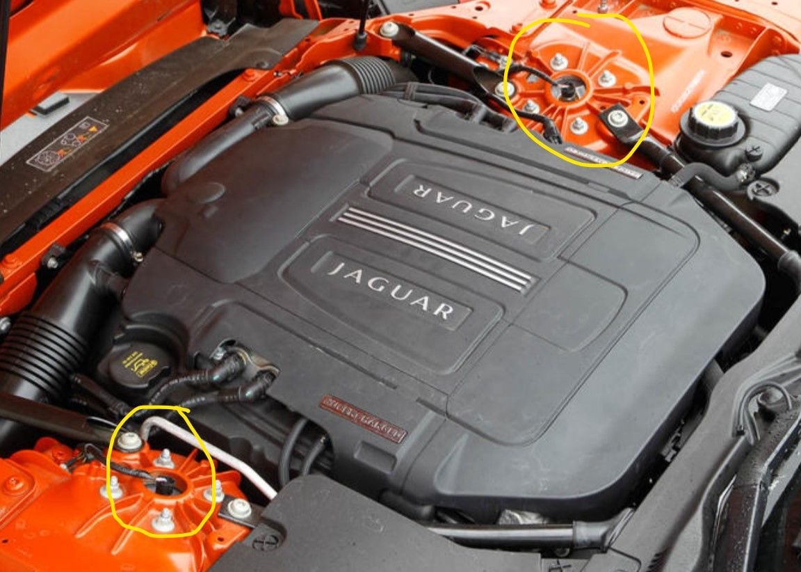

They're all supercharged and as said there's no reliable way to visually tell them apart from the outside. To be sure, get the VIN and get the build spec online or through a dealer.
You can also check if there's any photo of the engine compartment. That's one place where you can see a difference. The 380 / S has the adaptive suspension which has small cables connected to the tops of the shock absorbers. Don't know if the base car possibly also could have that as an option but I've never seen a base / 340 with it.
