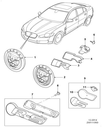

Why not use the proper mounting?
You can order the parts from a dealer...

I want to mount it properly, i have the parts listed above. The 'S' badge sticker, the base, the back cup, and the screw. But the screw is too big for the hole on the base. What are the next steps for the proper installation?
Old Nov 24, 2015 | 04:48 PM
Cambo's Avatar
Joined: Jan 2011
Posts: 8,637
Likes: 4,526
From: Sydney, Australia
Without seeing the parts in my hand, I would guess that the screw is a bit oversized, so that it really jambs into the plastic base and can't work itself loose?

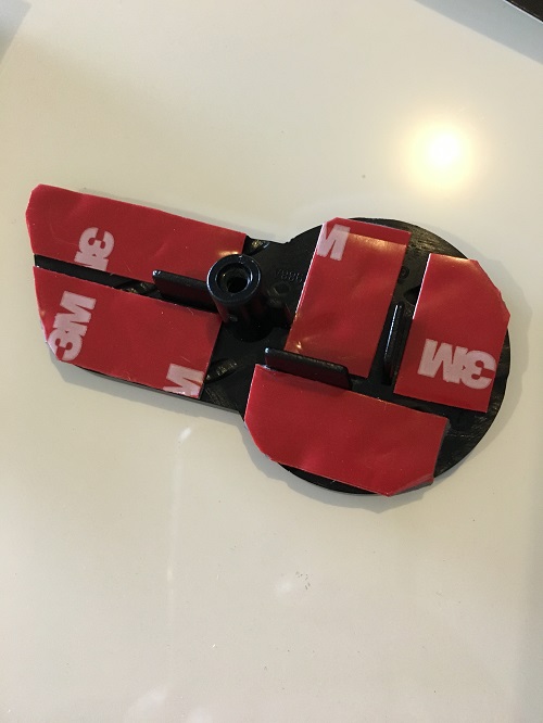

Thanks for all the info folks, I went ahead with using 3M super duty tape and loctite glue. Both should be easily available at your local hardware store.
Steps:
1. Clean the grille surface thoroughly and wipe it dry
2. Add the 3M tape to back of the plastic badge holder (Use loctite glue for extra hold)
3. Peel off the back of the 3M tape and add some loctite glue to it for extra hold
4. Attach it to the grille
5. Apply additional loctite glue where 3M tape touches the grille plastic
6. Use blow dryer to speed up the gluing process
7. After a few minutes, apply the "S" sticker onto the plastic base (Use loctite glue for extra hold)
8. Blow dry for a few minutes and let the glue dry off - Done!
I'll keep everyone posted on how it holds up through rain, dirt, car washes, etc.
Attached Thumbnails "S" Badge installation on the Grille-img_0464a.jpg   "S" Badge installation on the Grille-img_0465a.jpg   "S" Badge installation on the Grille-img_0467a.jpg   "S" Badge installation on the Grille-img_0468a.jpg   "S" Badge installation on the Grille-img_0469a.jpg
