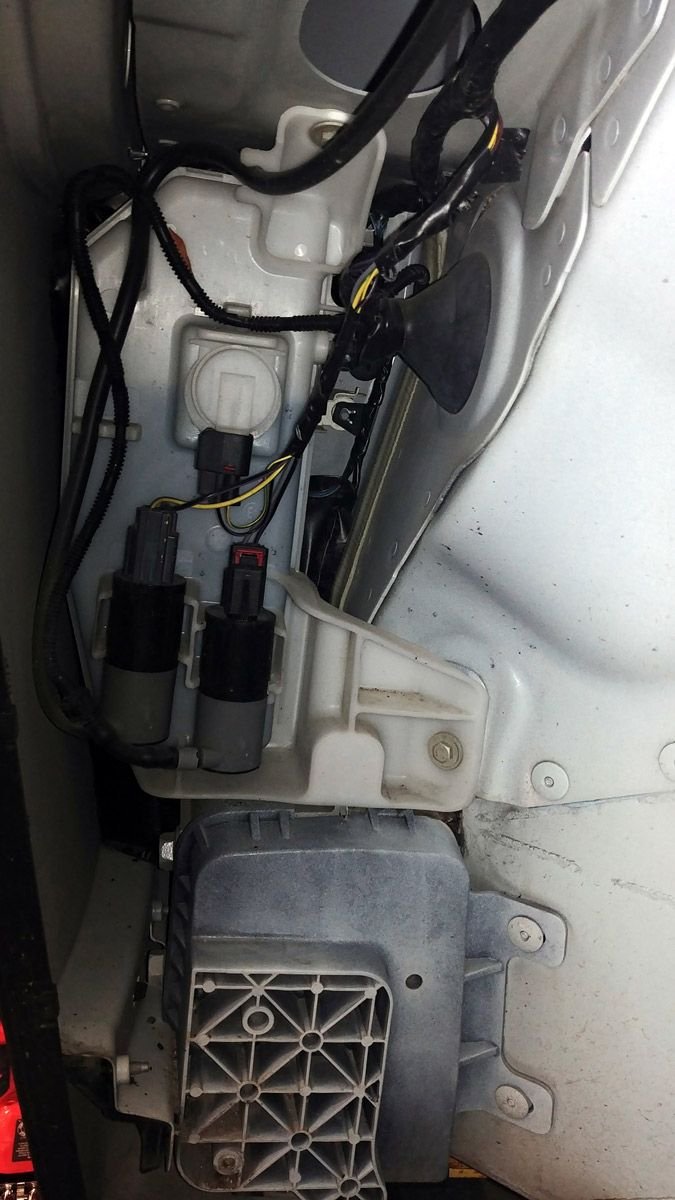

I suspect my washer hose is leaking as I have moisture under the passenger seat when I use the washer. Does anyone know how to access the line under the seat?

Don't know where the hose is but the damn resovor is behind the rear bumper. Mine was leaking and you have to a take the bumper to get to it. Complete pain.

Has two tanks...One in rear under bumper cover, and one right behind the right front fender inside the wheel apron. Remove wheel apron and it is accessible.
