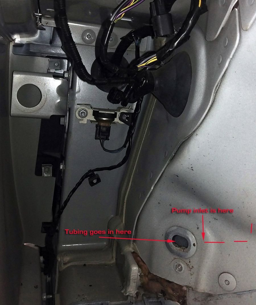

Originally Posted by Therock88
You may glean some helpful info from my DIY on the install on mine...Lots of ways to do it, but this one is clean an unobtrusive.
Good luck.. LINK HERE
DC
Hmm this was in reference to the supercharger coolant pump. I checked the link and don’t think I saw it. Did you do one for it?
Nope...No coolant pump...Just the Meth install

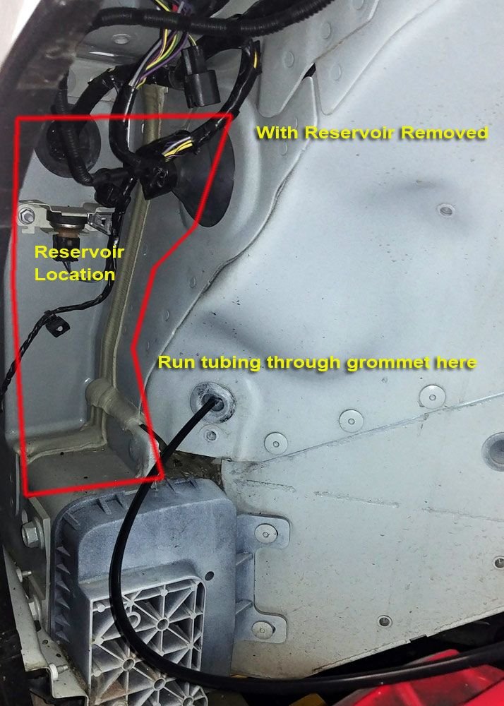

Originally Posted by Terrance39
I am running dual nozzle on a dual pulley R. I start my spray at 4psi and ramp it up to full spray at 11psi. I'm seeing max boost at 14-15psi. Been running this for more than 2 years now, with zero issues. Car pulls hard and efficiently, with no heat soak. Also I started out spraying pre charger and saw little change in iat, so I stopped and just sprayed post charger. That gave me the best results.
Can you please show us where did you install the pump and "juice" reservoir
Rock has an excellent DIY

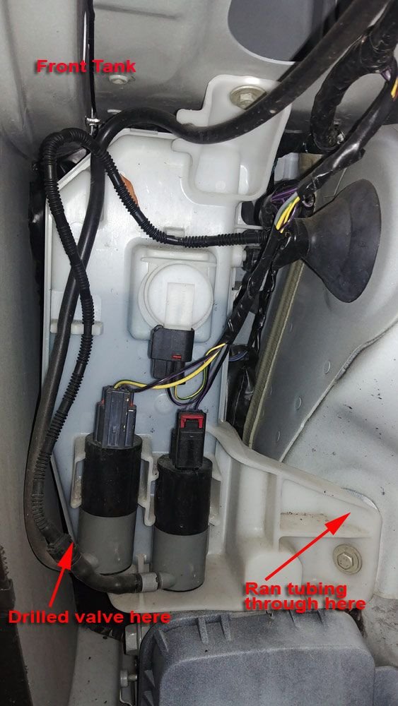

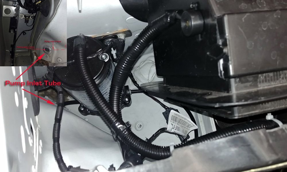

I agree, however one point concerns me there: pump suppose to be placed below the fluid reservoir and in his installation it is way above...
Incorrect. It is placed face down in the opening, and is almost even with the outlet fitting I installed. At most, it may be 1/2 inch higher at the inlet at the pump (which is 200 PSI and not an issue). Also, it has been working flawlessly for sometime now. This "Guideline" of at or below the reservoir is suggested by all vendors as a precaution and/or to mitigate the pump cavitating if the reservoir gets empty or low. That won't happen as there is a float to refill it.
But as I suggest in ALL of my DIY's. This is how I did it. Do it however you want, or whatever works for you. Bottom line...Mine works flawlessly, and there are infinite other ways, so I would encourage others to be creative and to come up with better solutions!
DC

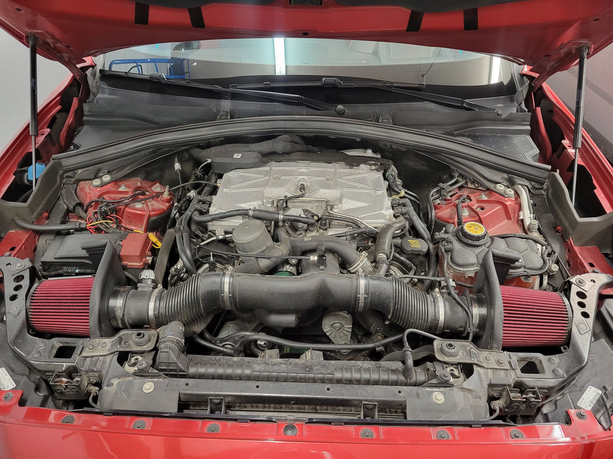

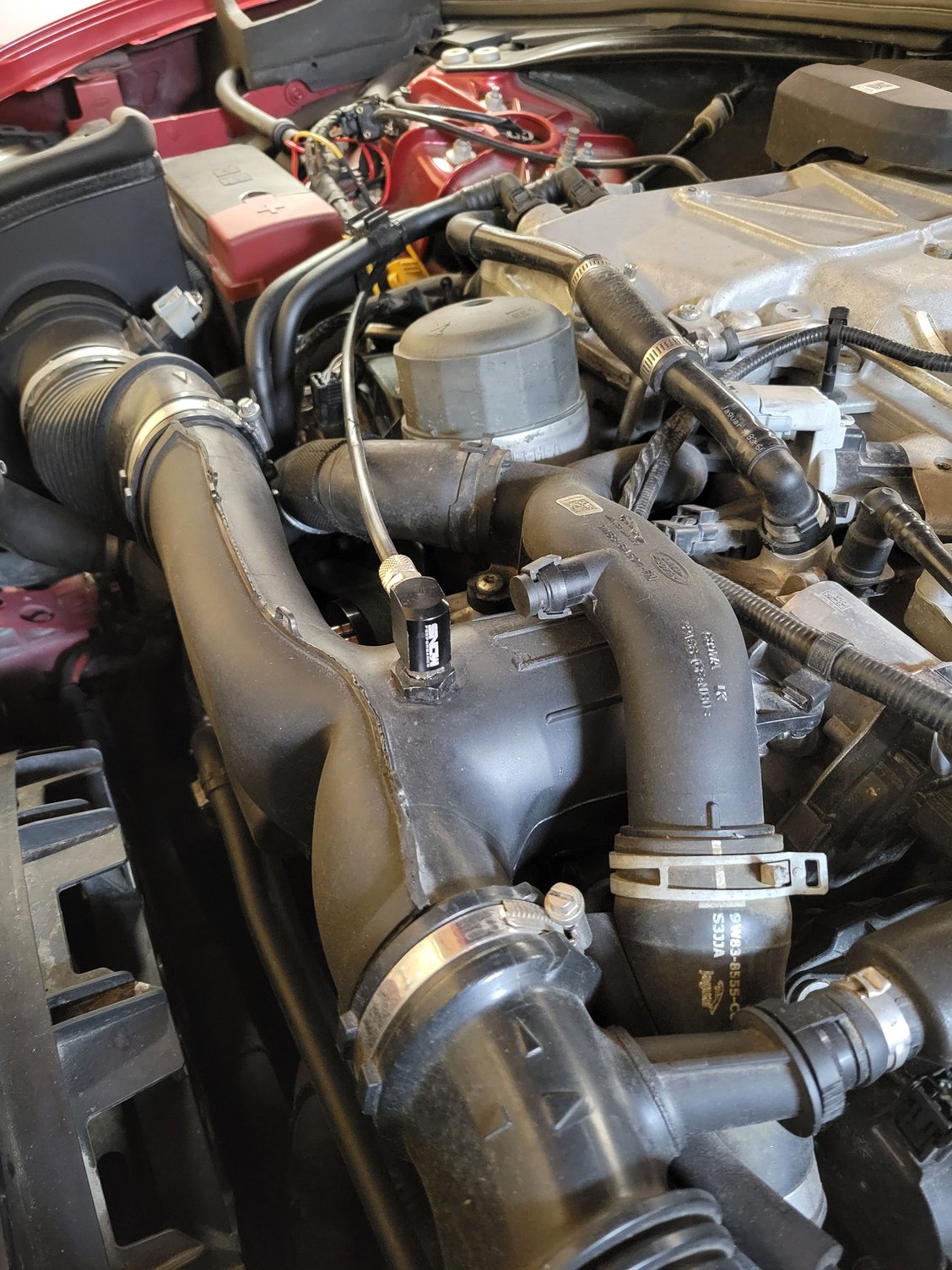

Originally Posted by hammam almulhe
im sooo tempted to do that. Two things are stopping me. First is that i do not know how close im getting to the pistons’s tolerance with the 15psi that comes with the dual pulley. Second. I dont want to overwhelm my already sensitive differential with a **** load of torque.
I am running a VAP lower pulley on my 2020 F-Pace SVR and upgraded to a 60.96mm (2.4") upper pulley. Using the MinaGallery filters on my stock intake tube and am utiluzing a snowperformance stage 2 WMI system with my factory reservoir and a #14 nozzle before the throttle body and have logged 18.2 psi. This SUV runs strong and gets 7.5 seconds consecutively in the 1/8 mile with a mild 1.77 60 foot on street tires. I am pushing the 1.9L supercharger to 18,660 rpms. Until VelocityAP developes a high pressure fuel system to take advantage of the additional boost the Harrop will produce, I'm maxed out.
Also using a E20-25 mix as well.
Next step is cat delete and then add 200 cell cats if I dont like the sound. Waiting for VelocityAP to finalize their CAI kit for the F-Pace. This vehicle has only cost $10 per hp which is way better than my Twin turbo Yukon which is my daily driver. Don't want to go too crazy on this vehicle as it's my spare so I need it reliable and fun.
