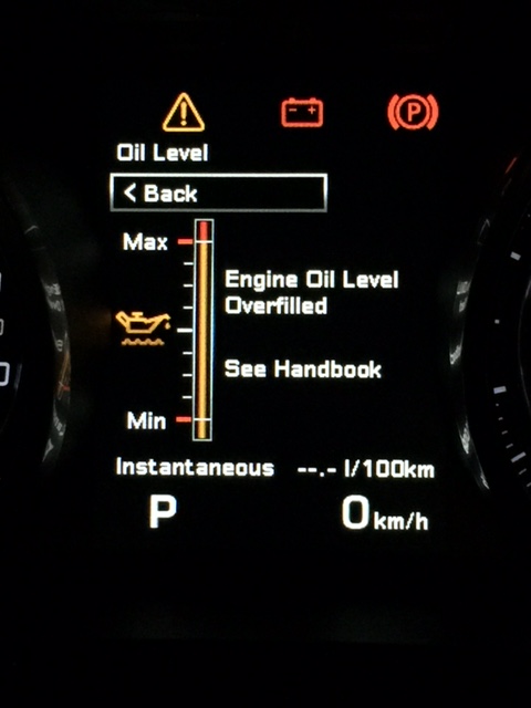

Originally Posted by Unhingd
....I don't think any trained mechanic puts in a specified amount without checking the level before the final quart goes in.
Think again....
This 2014 model had just came back from a dealer service and it was only by absolute luck that the owner saw this message as he had the bonnet up during a clean.
Idiots had put in at least 1 litre too much.
