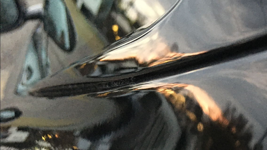

here is a pic of the left side rear window.
its hard to see in the pic, can you see what i'm seeing?
Massively blurry at my end, so much so that it's impossible to see anything.
Maybe try taking another pic or two?

i will take more tmrw, its getting dark now and thats the best of the few i took.
And maybe one a few steps back so we have some more context?

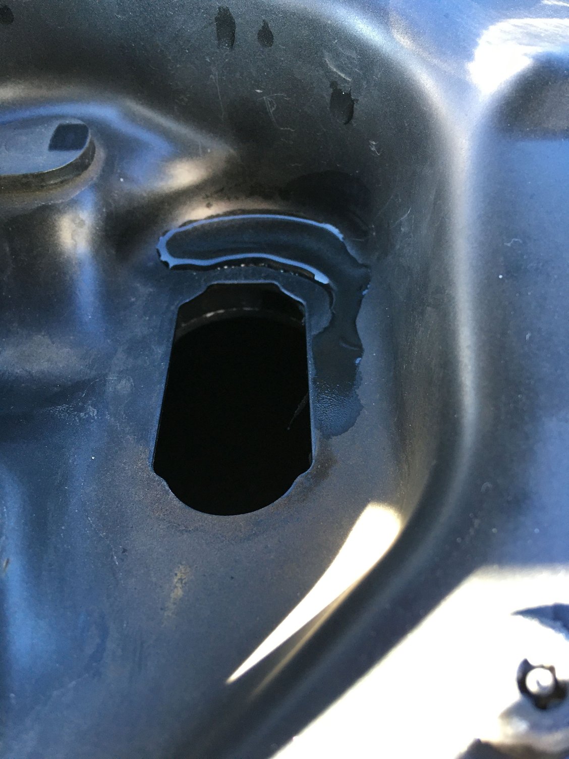

i think it is solved.
this morning i poured a little water into the hatch lock mechanism and it went straight into the battery compartment.

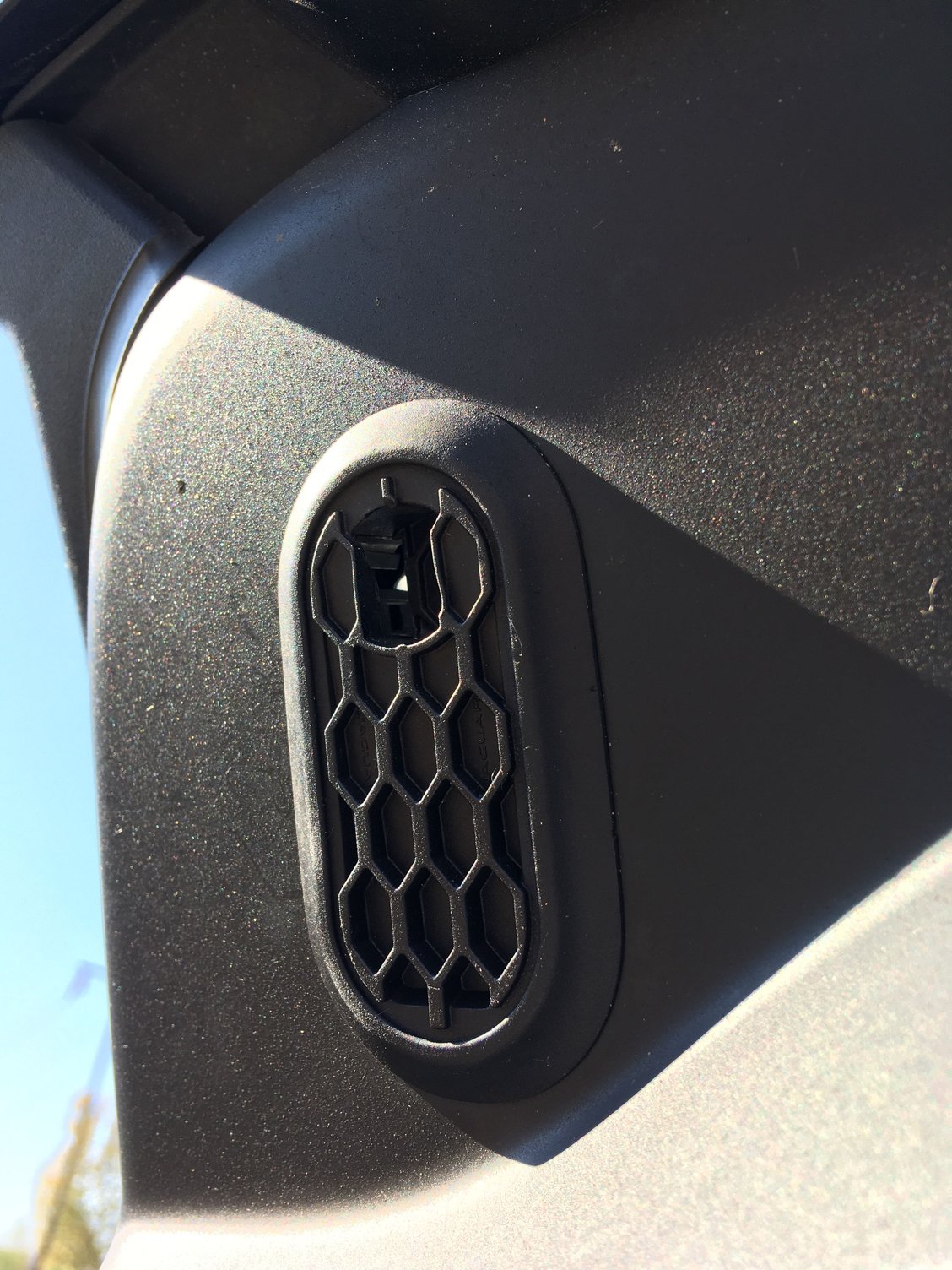

i then lifted the spoiler and i see a large hole on either side which looks like they should have covers on.
pice attached, the right side has nothing there and left side has "something"

The left side "something" should also be on the right side. I don't have a deployable spoiler so can't visualise what the other holes are.

Good troubleshooting!
Now, verify your suspicion by sealing that hole (temporarily) and see if the water ingress is eliminated.
