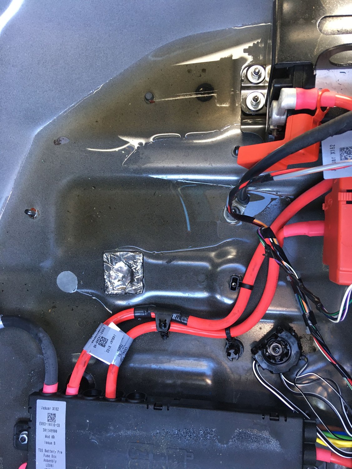

Old Dec 2, 2020 | 11:23 AM
iownme's Avatar
Joined: May 2011
Posts: 1,741
Likes: 174
From: ga
errrrr......this does not look so good, except for any critters needing a drink!.

I was going to ask, "What is that silver rectangle in the middle of the picture? A drain hole?" But then I looked and our 'Vert has one too.

As @scm mentions, it sounds like the seals in the rear are either damaged or worn. Start by checking them for damage. You can also try pouring some water down the sides to see where it run (and possible leaks). If you don't see any leaks, the seals may not be making a good connection with the hatch. You can try some "convertible rubber seal conditioner" which can help revitalize the seals. Lastly, there are some drains at the base. Make sure those aren't clogged.
