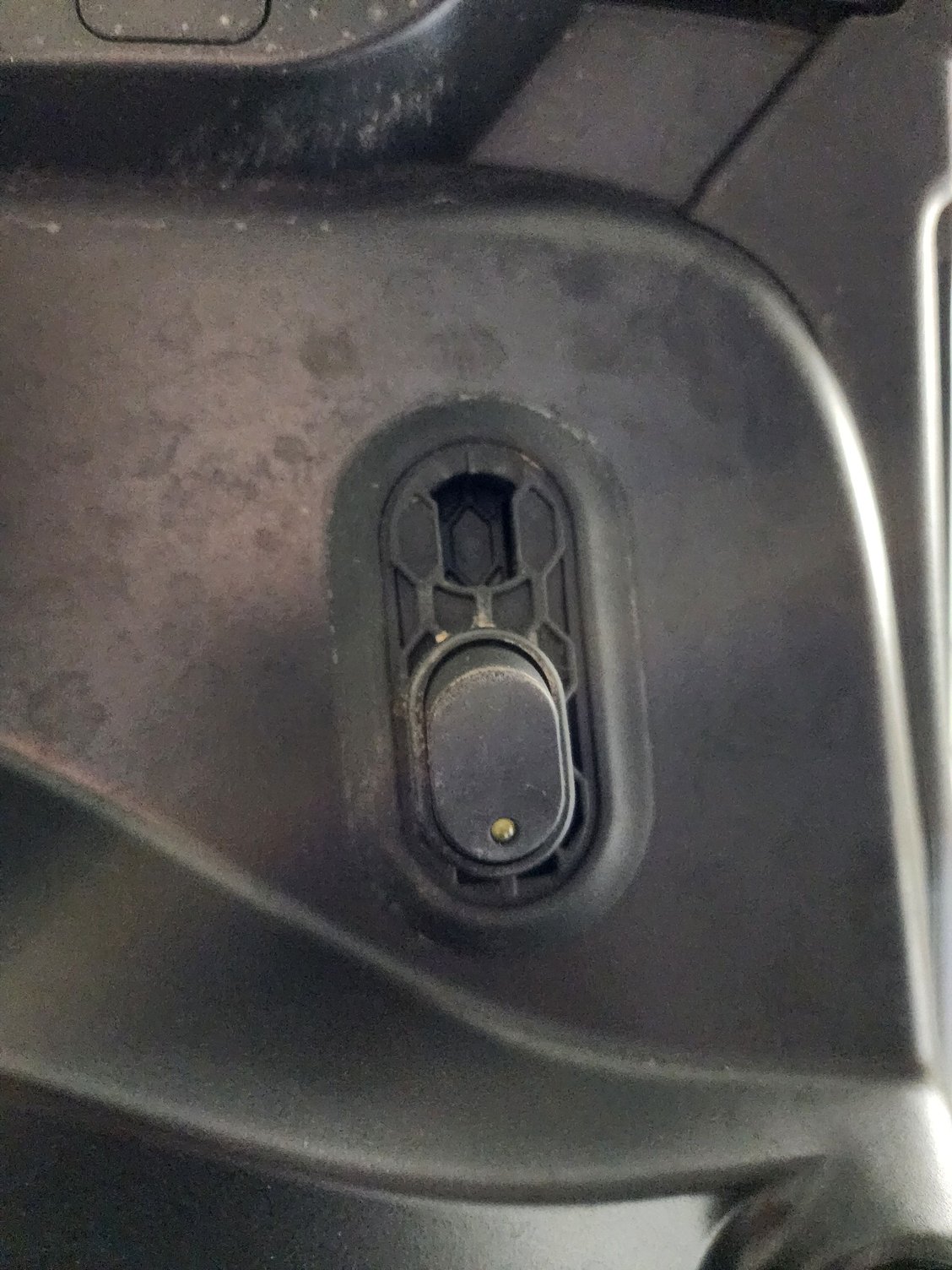

Good morning! I'm new to the forum and new to the F-Type. Traded in my '04 Crossfire and got a '21 F-Type P300. It was heartfelt giving up the XF, I was the original owner from the beginning. As I was cleaning the F-Type with the hatch open, I noticed this switch. (see pic). Any clue what this is?

Interesting ... I can see the drains elsewhere but, this is clearly a toggle switch of a type, as I have pressed it. There's also a small LED in it.
Thank you for the reply, I'm going to keep searching and I have an appointment scheduled, I'll ask the tech.

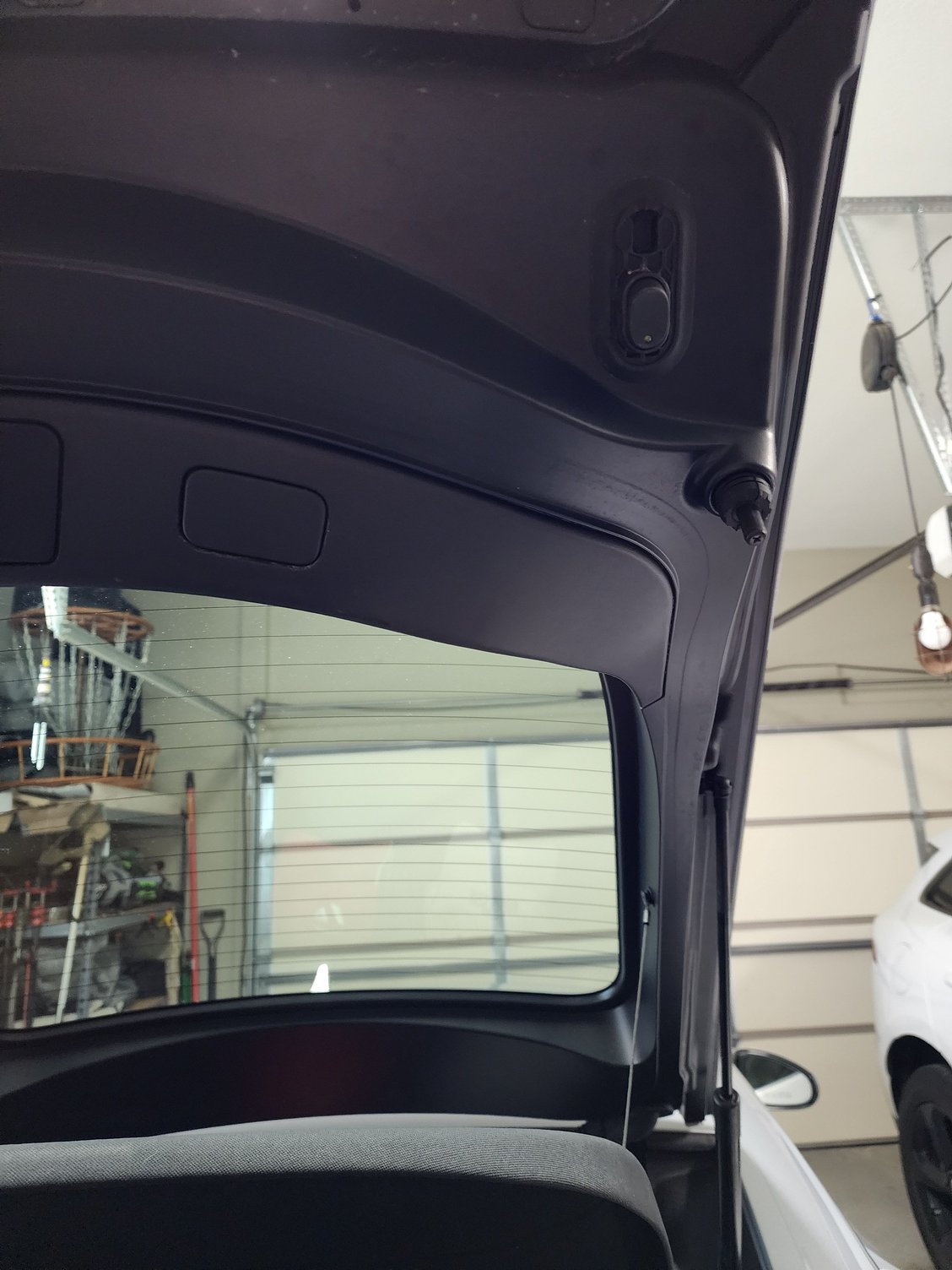

On my 2017, they look a bit like yours... the cross-hatching and the open hole at the top, but definitely not the round component that you identified as a switch.. do you have a switch to lower the hatch? have photo of what the 2017 has.

scm, I agree on your comment about it being a toggle switch not a press switch. A thought came mind, perhaps it was added to disable the spoiler without disconnecting the fuse. The little LED would illuminate indicating power was on to whatever it's connected to (spoiler perhaps).

Not sure how these mystery switches/drains line up with the closing surfaces on your car. I went out and partially closed the hatch to get a fix on what they would touch or come in contact with. On the 2017, there is nothing that would touch or depress. Certainly not like the adjacent hatch switches that depress when hatch is closed, operating, I believe the trunk lighting.

Mystery solved!
Took the F-Type to the shop and the technician traced out the wiring and it was set up as a spoiler kill switch. Due to the location the previous owner chose to install this switch, it got wet and shorted out the spoiler system. The switch was removed and the spoiler system was fixed and it is now fully functional. Even though this switch was something the previous owner installed, all repairs were covered under warranty. Big relief on my part.
