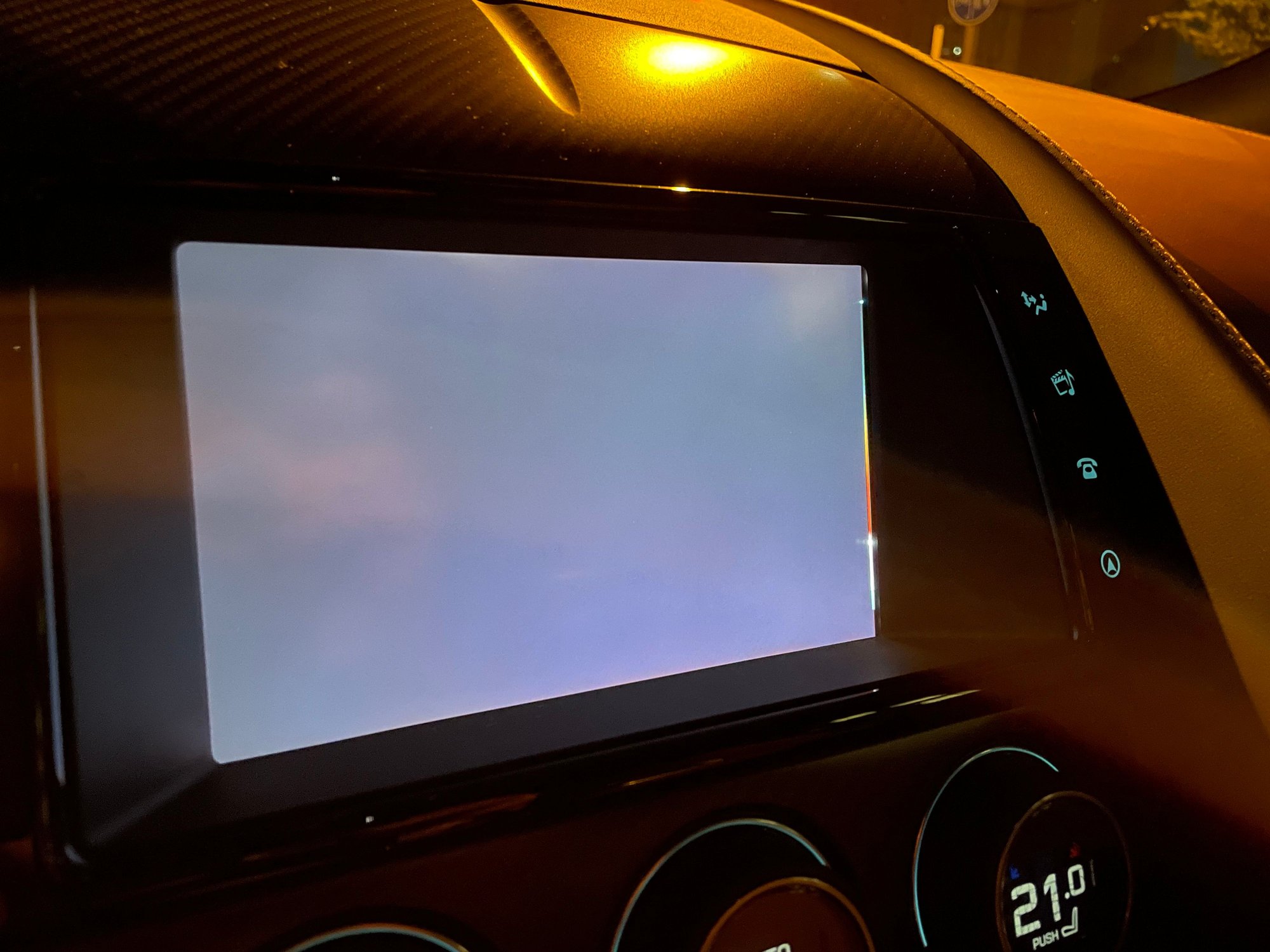

Just to give my own personal experience with UAD. I had not stop problems with their unit, and even went as far as purchasing a second unit after over a year of issues with the original one thinking maybe mine was defective. Still was a no go. When it worked, it was great, but almost 90% of the time on starting of the car it would fail/black screen, and the unit would need restarted. Even after continued emails back and forth with UAD, it could not be figured out and the second unit did the exact same thing. Now I do have that unique year, MY18 with the 8 inch screen but also half the newer 19 hardware in the center counsel. I can only assume this is the issue and since that model makes up such a small # of F types you don’t hear much about it. I will say I’ve only ever heard of success with the earlier models annd UAD so if you don’t have the internals that mine does, and you’re ok keeping the 8 inch screen (which I would have been) then go for it. But for those few MY18 with mixed techs inside I can not recommend UAD. Sorry

Seems like you Blacks18 had some really bad luck and maybe there was something particular with your car that caused the issues since you had the same issues with two different units. I have the same system - a facelift MY18 car with the full fat ICTP with the 8" screen and the UAD unit works brilliantly for me. It has gone black and quickly rebooted a few times, but that's extremely rare. Btw, I remember getting some helpful advice from you via PM back when I was installing mine - appreciated! Anyways, from my experience I can highly recommend UAD also for facelift cars.
