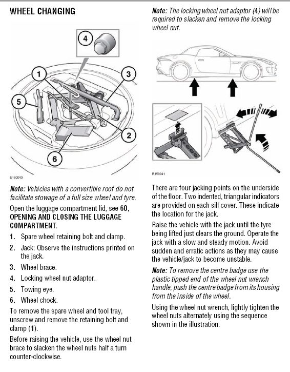

Since the F-type doesn't come with a jack and therefore the manual doesn't show jack points, does any one where the save jack points are?
I want to remove the wheels to clean the rims and also check out the suspension.

Hello,
Please click on the link.
This SHOULD take you to a photo bucket account where I have uploaded the jack points to.
Many Thanks
Mikehttp://i1287.photobucket.com/albums/...psfff1df15.jpg

Mike,
Thanks for the prompt response. The photo bucket link does work.
I've added the information to the FAQ's 'sticky' at the top of the threads as this question is likely to be a regular inquiry.
