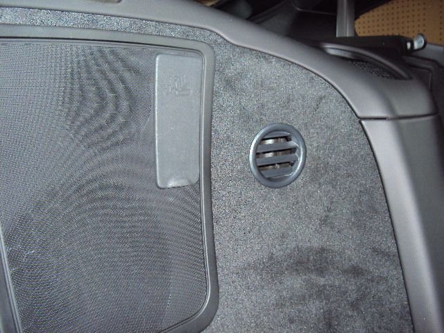

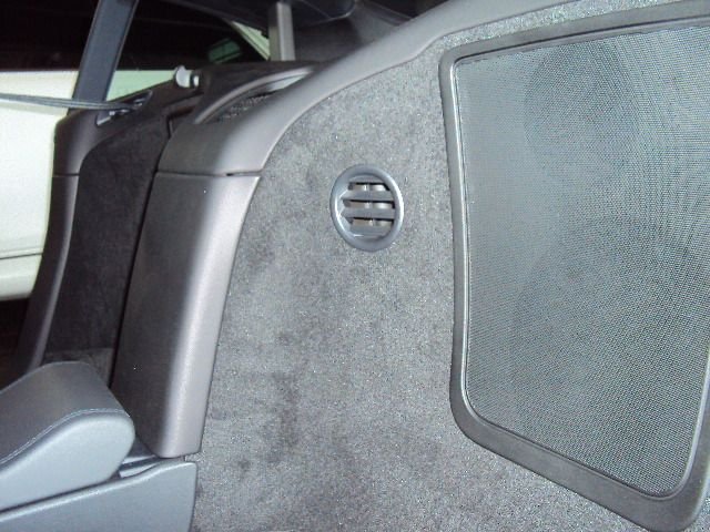

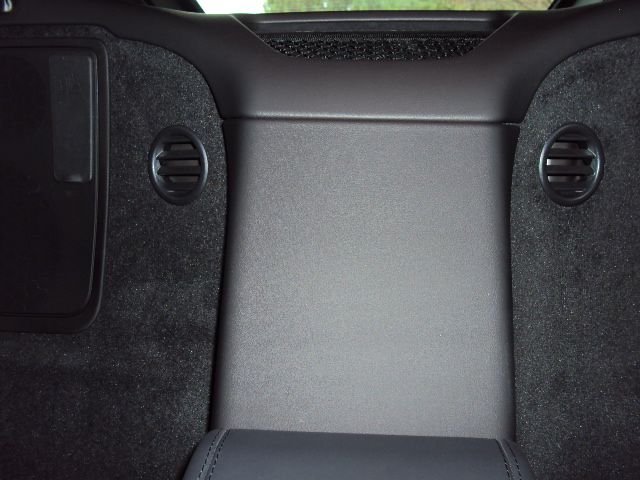

Just to follow-up, these are the two round vents in the rear bulkhead of the cabin (seats and seat backs full forward). I was able to determine (smoke from a match) that the airflow is into the vents, so they are exhausting the cabin. Again, the sound of the fan is very slight, and comes on as soon as either of the doors are opened. How long it remains on after shutdown or doors closing I do not know.
Right/Passenger side
View of Both
Left/Drivers side
