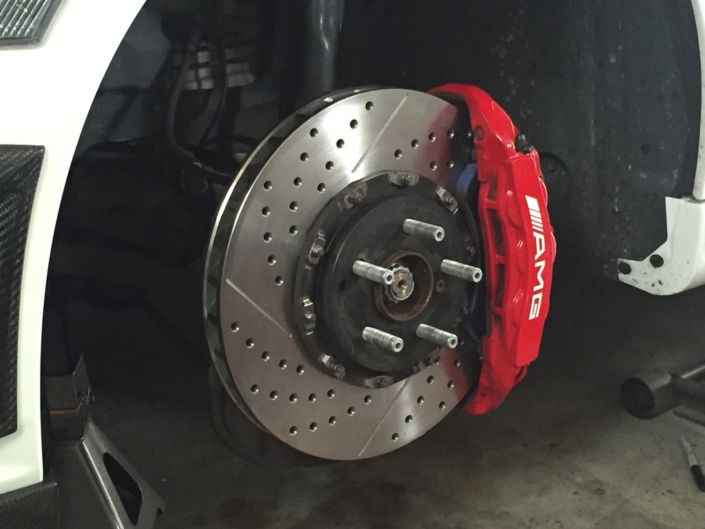

I bet it's actually the same caliper, just a different mounting bracket to allow for 380mm rotors. At least, that's what AMG does with their line up. Same Brembo calipers, with different brackets allowing for larger rotors.
Good to know though - pads are what's important though.

Nup, the caliper (and bracket) is quite different, I know coz I had the 355 mm brakes on my old XFS (The F-Type 355 mm brakes are identical) and the 380 mm brakes on both my XFR and F-Type. These calipers are ATE or TRW, not Brembo.
Edit - forgot to add - another reason why the 380 mm front brakes are a bit more powerful than the 355 mm ones (besides the much greater swept area and much bigger pads) is the 380 mm are twin piston while the 355 mm are single piston.

Ahh, gotcha. I'll have to take a closer look. Yes, these are definitely not Brembo. I was saying I had Brembo's on my C63. They sure were a lot prettier.
