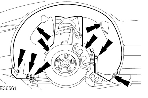

The liner is attached at the following points:

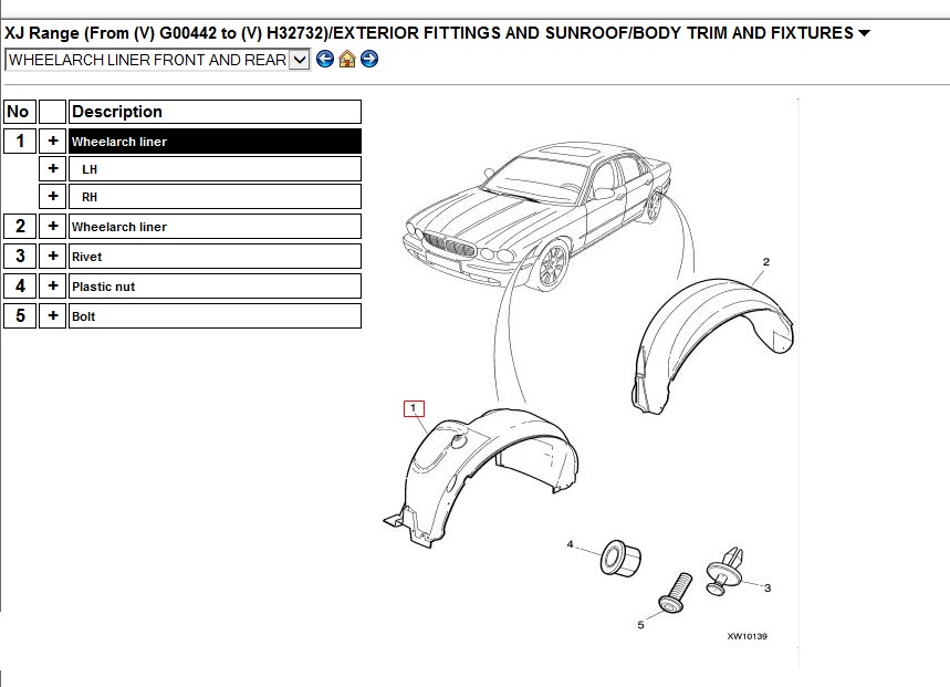

Three types of fixings are used (see items 3, 4 & 5):
Item 3, the plastic rivet is released by undoing the centre screw so the fixing can be pulled out.
