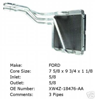

First thing I would do and this is what fixed mine. Unhook the 3 heater hoses going to the firewall. Then back flush those 3 hoses every way you can. Forward, backwards, plug one hose and then a different one so you force water thru the heater core.
Now we have a problem because with a split climate control system you have a split heater core. That means you can't flush it 100% like you could with the old single systems. If you have some blockage you might want to put some cleaner in the core and let it sit and work.
Here is what your heater core looks like so my description will make more sense.
I got my heat back after the heater core was flushed and I saw nothing come out of the hoses.
