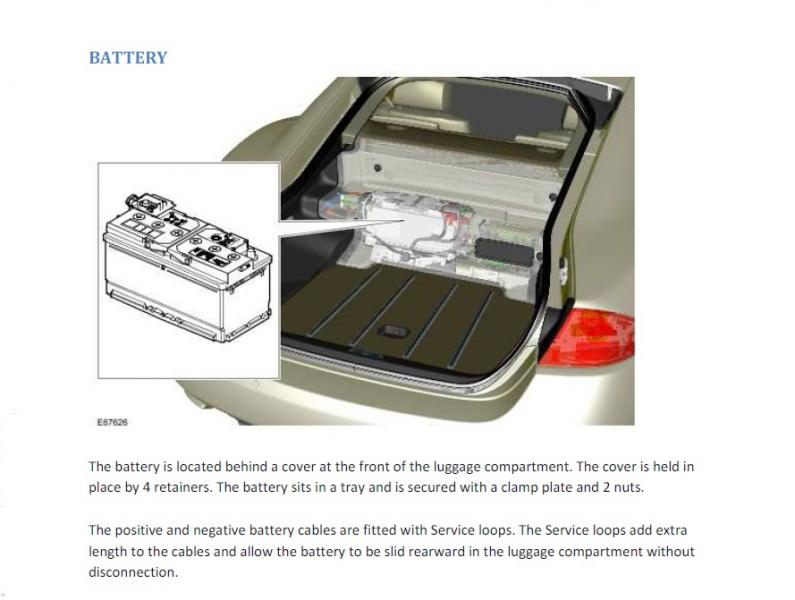

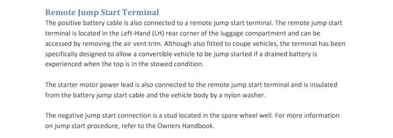

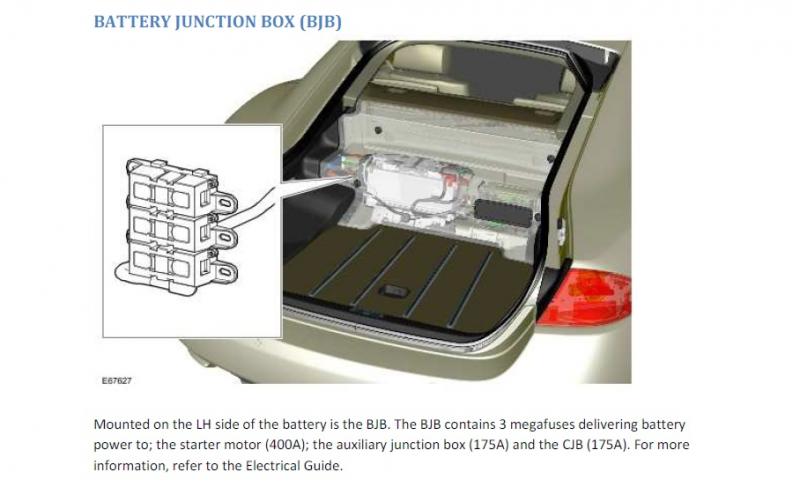

Andrew,
The XKR almost appears to have been built around the battery:
The cables and loops are more complex that the earlier models. Be careful not to short across the terminals.

Thanks again Graham! Some good bedtime reading
Mine's a convertible, so it's even trickier as I need to remove the luggage separator. It seems there's also a procedure for starting up after a battery disconnection/hard reset.
Incidentally, you're spot on re the fault code resets. See first para of attached excerpt from workshop manual.
