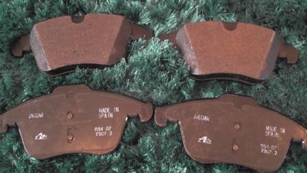

Hi all,
I'm hoping you can help me identify some brake pads that I have. They are for a Jaguar obviously and are manufactured by ATE. I have included a photo to show one of the pads. The numbers on the bottom right read 054-07/B above 7307.2. I also have another set with similar numbering just without the /B part. Appreciate the help.
Cheers, Matt.

They look like front pads for X308 or X100.
Just a guess. No wear sensor slot so they are later style pads.

lucasist, doing some looking, using the 054-07/B as a part number, it cross references back to Brembo pads. So, that would lead me to believe that the pads are from either an XJR or XKR. But, can not get much more specific than that as there were no references to Jaguar specific vehicles.
