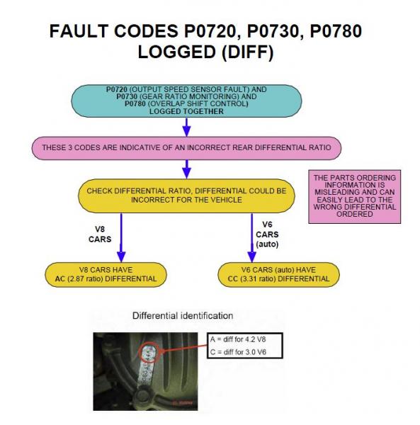

1st of all you will get an error if you just swap the diff without the TCM programming, this is documented by Jaguar, see attachment.
The 2.7D files will have a totally different shift pattern, and lower rpm, so that’s not an option. The V6 3.0 will be closest, but you need to tune the ECU so it revs at least 100 to 150 rpm higher than the shift point of the V6 files. I would guess that you can increase the max rpm to 6800 or so but you will lose some good torque in that area, maybe diminishing the results you are looking for. I am also a guy that just does things and applaud people doing it as well, but I would do a little bit more preparation here.
1st is upload TCM software form the V6, if that works you will then also find out if the TCM will throw an incorrect gear ratio error which would be good news than ;-). Then reload the original one again, to make the car drivable again, and go to step 2.
2nd tune your ECU so it revs higher than the shift point. You can test this by putting the gear lever in a fixed gear, as then the tcm will not shift down. You can also then test on a dyno how the power delivery is in this new band. Only if that is acceptable, you can actually change the diff imho.
