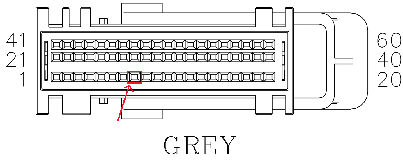

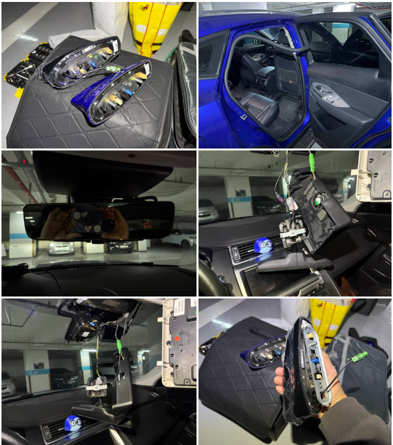

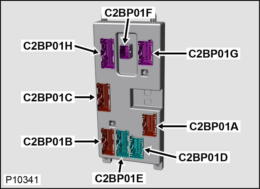

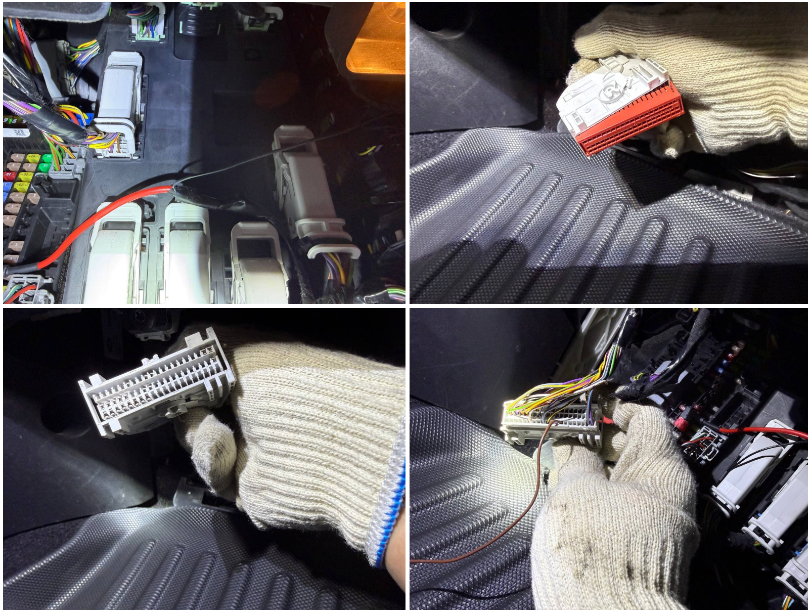

Last Friday, I did some testing on new Evoque and found something pretty important. As I suspected, the BCM LIN is the key for SRVM operation. The CCF coding enables the BCM LIN, and that signal is then passed to the SRVM, which makes it work. Pin 6 on the RVM (Rear View Mirror) connector is connected to the BCM LIN.
Both I-PACE and New Evoque have this pin present and connected to the BCM. Unfortunately, on my E-PACE, this pin isn’t connected.
I enabled SRVM in CCF and also wired the pin to BCM. Unfortunately, it seems like E-PACE isn’t outputting any signal from BCM. SRVM doesn’t turn on at all. Pin is C2BP01C-8.
SRVM didn’t power on at all. I also checked whether the basic LIN voltage was present, but there was no change on the tester - no signal detected.
I’ve bought a LIN emulator, but I don’t know the exact specs like ID and DATA. Since I’m not in a position to reverse it(evoque left), I’m planning to try all possible values. Even if I manage to power it on, if dimming function doesn’t work, then it’s basically no different from aftermarket products... which would be pretty disappointing.
