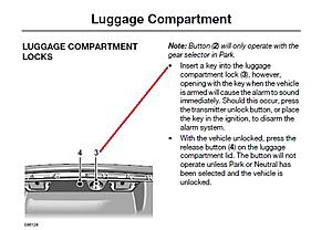

Old Dec 10, 2017 | 10:20 AM
Likes: 17,016
Is this it?

I don't think so GGG, it's on page 74 and 75 in the 2012 XJL Owner's manual. You have an emergency release handle inside the trunk that conveniently glows in the dark. Or you have to apply a 12 volt source under the hood to power the car. It cautions against trying to do it yourself or trying to start the car with power applied in that fashion.
