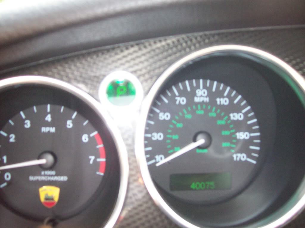

You should look into a Speedshift kit from Racing Green Cars in the UK. It will allow you to bush buttons on the steering wheel to control gear changes. Name:  163-1.jpg
