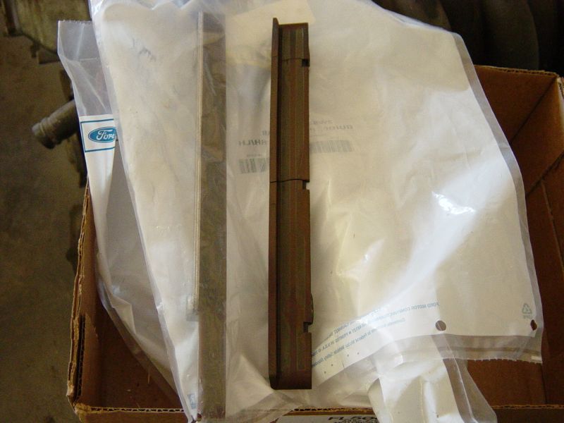

I ordered some of the Ford parts from the list as described in the .pdf and the hydraulic units are correct. The chain guides are not the same and I need to know if anyone has ordered Ford guides and what the part # was.
I need the guides (not the tensioner blade) and the part #. The Jaguar part # is AJ82326 or NCA2025AB.
2W9Z-6K297-AB GUIDE is not the same as AJ82326 or NCA2025AB.
The guides are much too narrow as far as I can tell.
Has anyone installed these parts and been successful??

Attached Thumbnails Ford V8 vs Jaguar timing chain components-v8guide1.jpg   Ford V8 vs Jaguar timing chain components-v8guide2.jpg

I don't know if the pics uploaded in the post.
I'll order the Jag parts if I cannot identify the Ford ones.

The shorter/wider one is NCA1998AB and it is the one I need the Ford number for.
The Ford ones I bought are for the 2002MY onward engines. I need the earlier type part number.

Xw4z-6l253-aa
xw4z-6k297-aa
