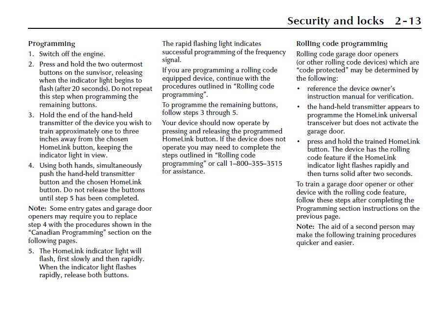

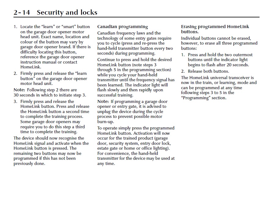

Here is the full procedure from the Driver's Handbook:
The instructions are on the fourth page for reprogramming a previously trained Homelink to erase the link to your old garage door opener.

My manual is slightly different than yours but basically the same procedure.
I followed the procedure and get the homelink to go from slow to fast flashing indicating it should be programmed.
However, my driver's manual says the light should go to yellow if it is a rolling code device. It does not go to yellow.
I tried to teach the garge door opener my newly programmed button anyway but could not get it to work.
It's cold in my garage. Now I'm cold. I'll try again tomorrow from the beginning.
Mybe it didn't program the button correctly.
Thank for the help.
