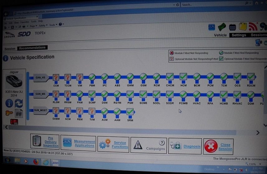

It's a bit of code reading for sure!
You have to decipher what the abbreviations are and what functions they provide. But it's not too hard. I mainly do internet searches to find the answers.

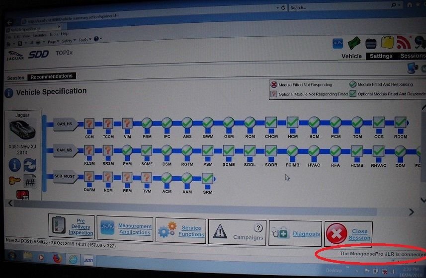

Here is my car. See the yellow battery indicator. This was early on (The version is 157.00 v.327. and Date is 24 Oct 2019) before I was convinced of the need for a power supply and was running my normal battery charger. Hey it said it was rated for 50A!
Note the red symbol (What ever it is?) in the upper right hand corner that tells me I am not connected to the internet.
Some are pretty easy to figure out but mainly you want either green check marks or red question marks. Any red X marks are a sign of trouble and miscommunication of some kind.
I really don't fully understand all of them yet because mine has a red question mark on the REM which I thought was the Rear Electronics Module that every car had to have to operate?
I think it's OK because the definitions state the red question mark in a square box are optional modules not fitted to the car.
The real important thing is no red X in a round box.
Yes depending on the software either no internet and no updates or like how mine is cracked and it bugs you to do updates. Mine if not connected to the internet will work but as time goes on it will start disabling functions until your pretty much forced to connect and start updating. I have been worried became most people have the type you do where it's static and NOT connected to the internet. I have done TONS of updates and no change in how it works on my car but I can see how a dealer would need to update continually because of new models and updates.
But I think SDD should stop updating soon because it's been replaced by Pathfinder on the newest Jaguar's.

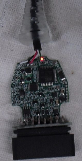

I have not asked but did you install the Drew Tech Mongoose Pro drivers? You can see if you have on the SDD screen.
If not I have the 32bit and 64bit versions.
SDD does not know or care if your cable is real or not the drivers handle all that. That part of the screen will change if you are using something else like the VCM. See attached for a summary of approved Interfaces. Note the shocking high prices for all of those devices! Also note that even the Drew Tech. Mongoose can't program some ECU's. But that's very advanced stuff and I have never had to do that.
Your cable (If it's a Mongoose/Mangoose) will have status lights that should blink and also indicate communication with the car.
I had trouble seeing these lights as they show thru a clear plastic cable protector. So I removed the cover for a better view.
Apologize as that photo a bit blurry!
