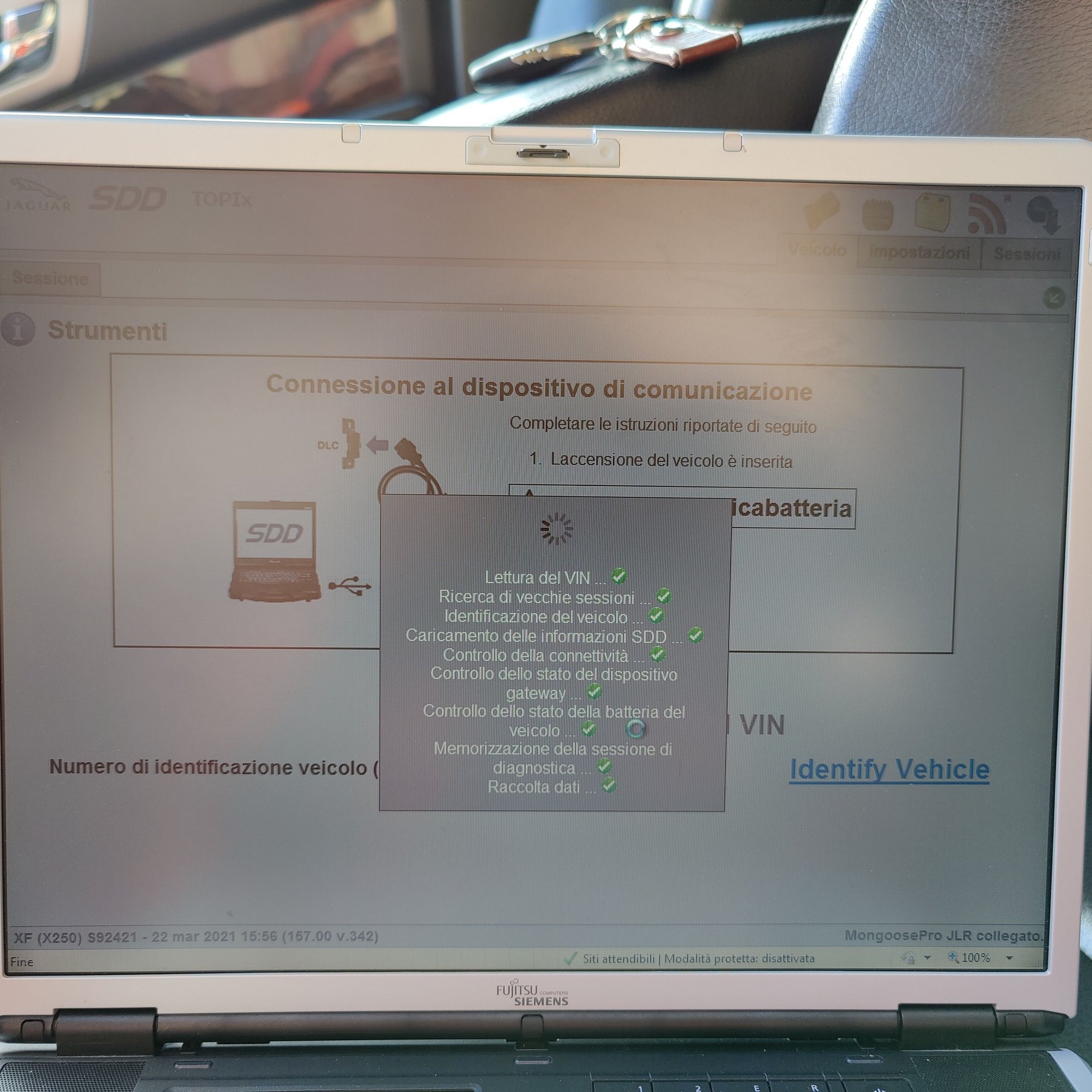

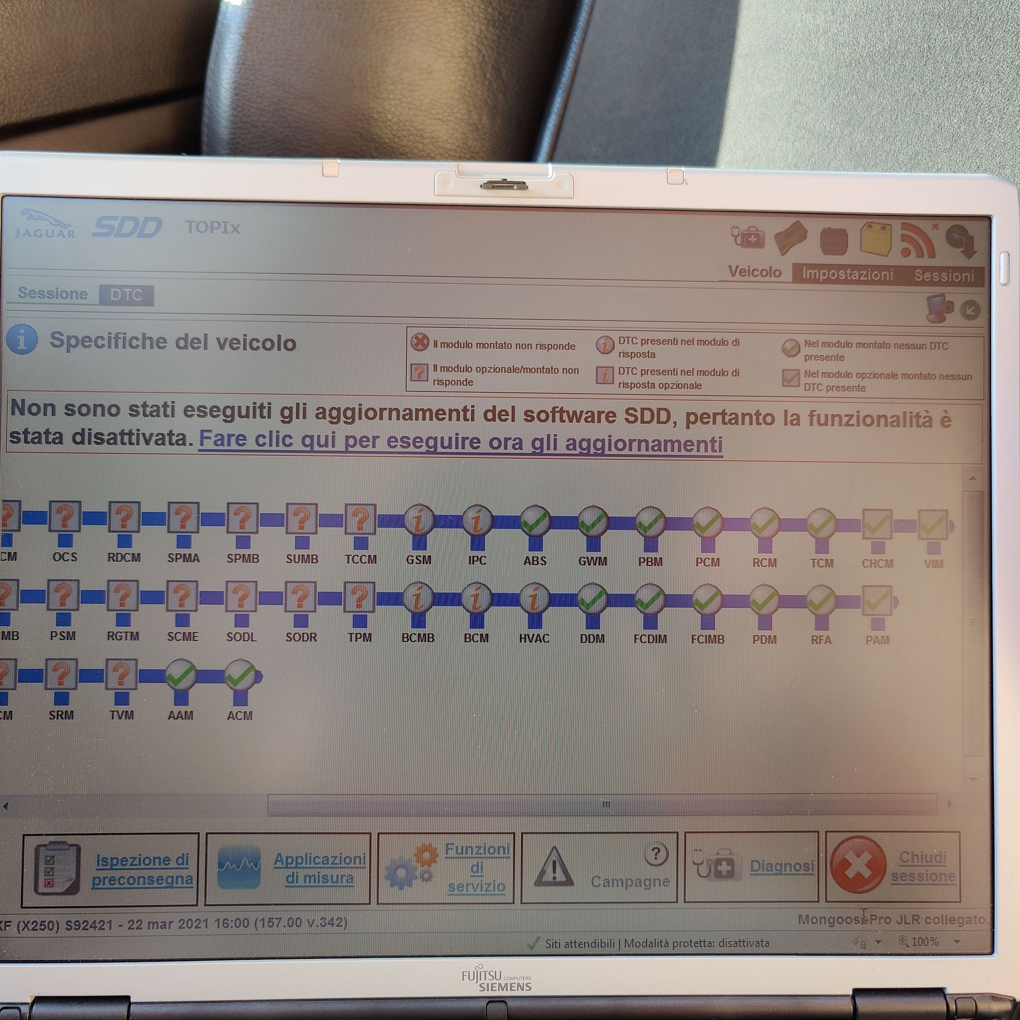

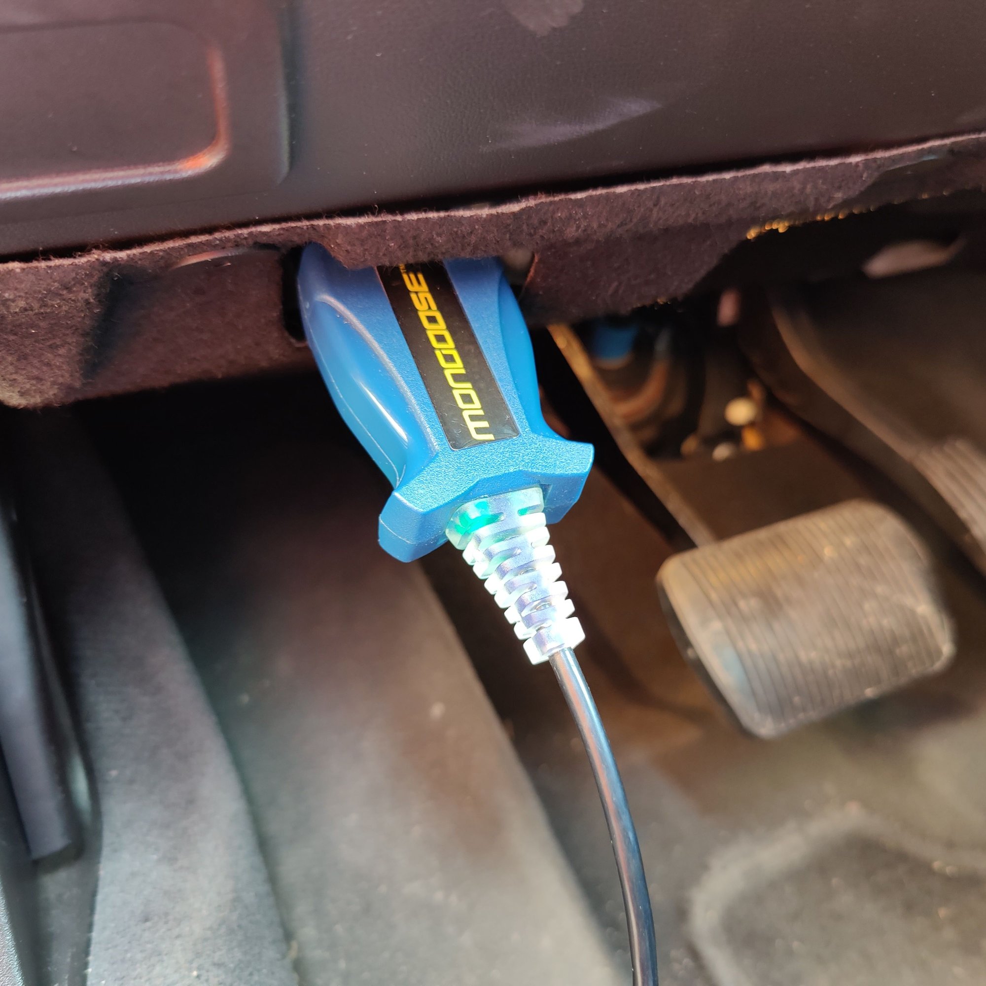

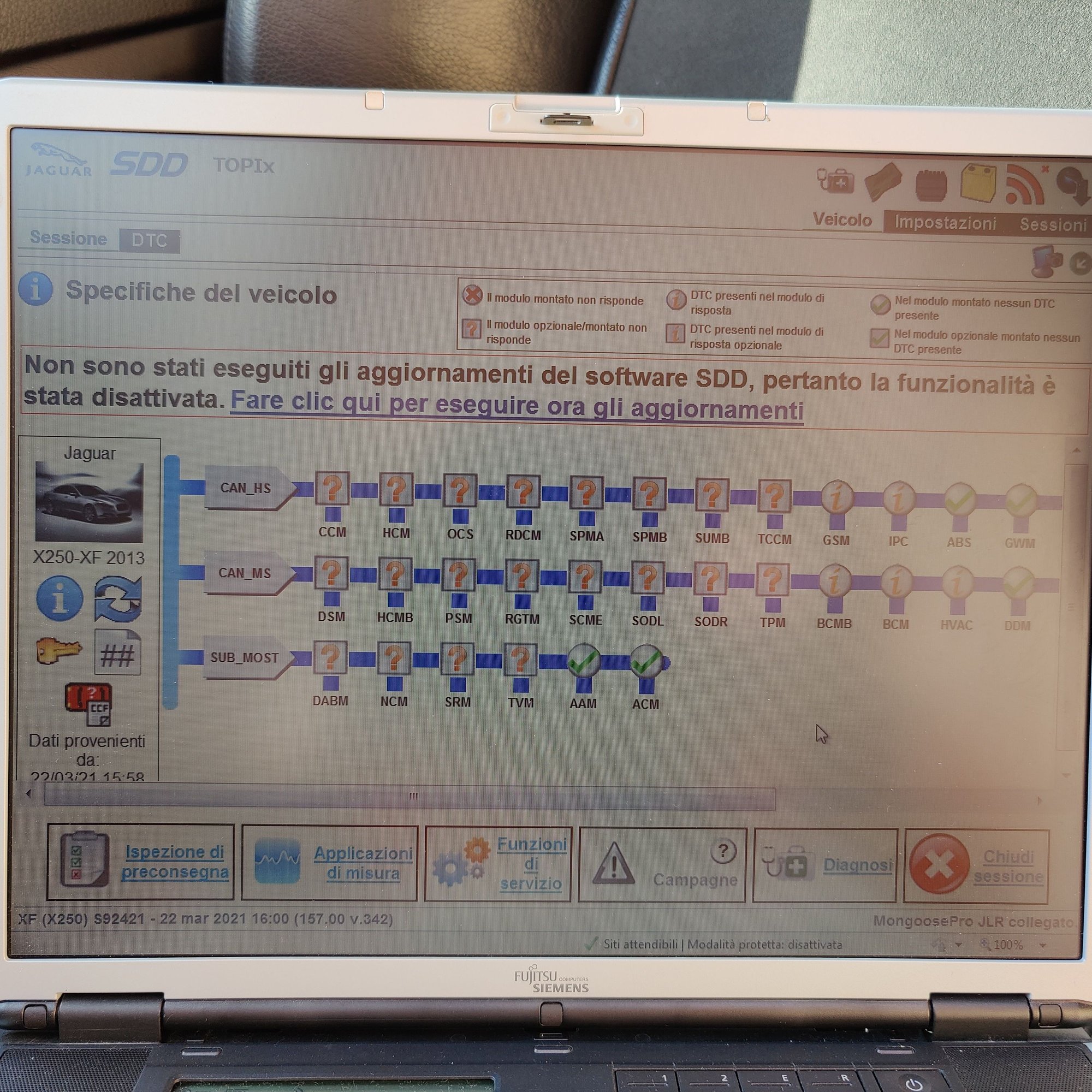

installation performed, I think everything is in order. See in the lower left corner the version of sdd, do you think that if I am connected to the internet it will update? and especially when I connect to the machine the internet must be on or off?
sdd just did an update, now it's 157.00 v 342

Looking good!!
I think you got it. Now get to work!
But get that battery symbol green first.
Pretty cool I have never seen SDD in Italian before.

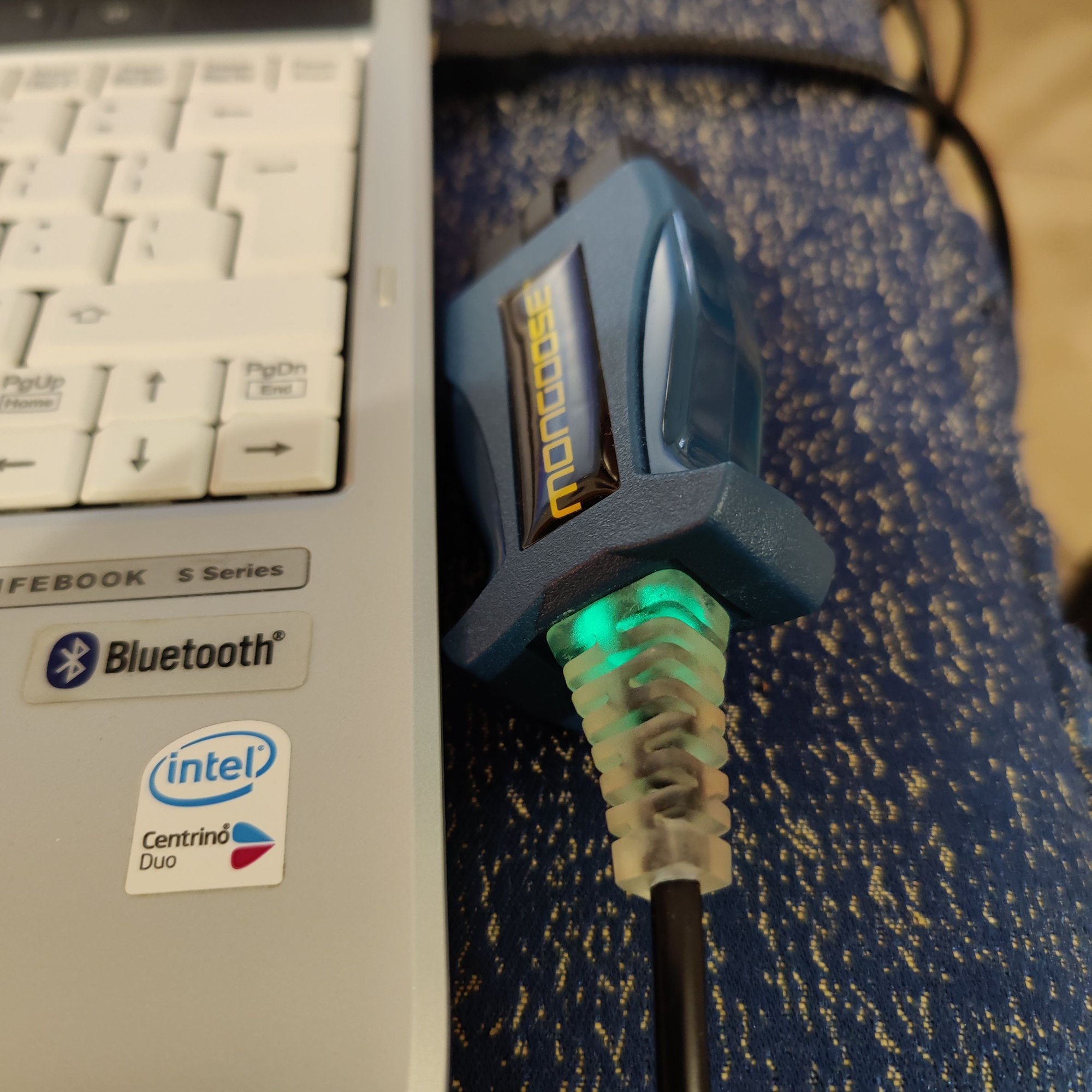

do not look at the yellow battery because I have yet to purchase the charger. I connected the pc to the internet and magically sdd continues to download updates, it is now at 157.04 v342.

Yes many updates and they take a LONG time. But again you look great!
Hope it's useful for your repairs too!
But you really don't need the updates so your ready to use SDD now.
