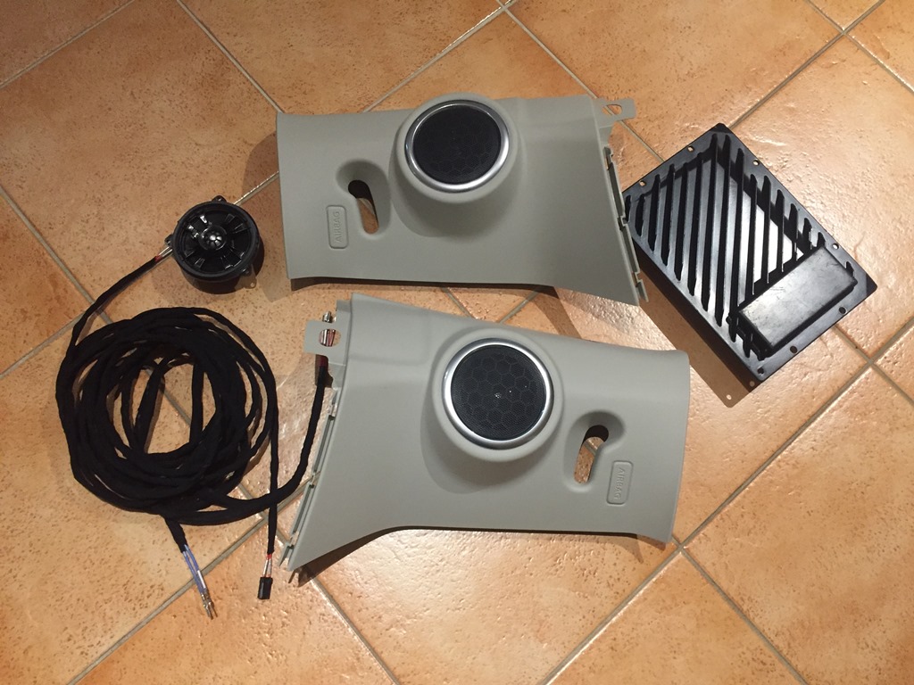

If you wanted to go a bit further here, it's also possible to upgrade from the 11-speaker 600W Harmon Kardon system to the 17-speaker 1200W Harmon Kardon Logic7 Surround system. I've done this on a few Disco4 / LR4 now.
If you need to buy a replacment amp anyhow, then why not get a Logic7 version and go for an upgrade...
The Logic7 amp is CH32-19C164-BC or CH32-19C164-BD.
You need the additional speakers, which are available as complete d-pillar trims, plus the center speaker that goes in the dashboard. There is some wiring missing however I have made up some "retrofit harness" to solve that problem.
However you do need some software changes to enable the Surround functions, where are you located? I might know someone nearby who could do it. Or if you have a Nanocom or IID, it's possible to do the software changes with those.
You can also just fit the Logic7 amplifier in place of the non-surround one, it should work the same without any programming, have seen this on several other cars that have been upgraded, as an interim fix.
