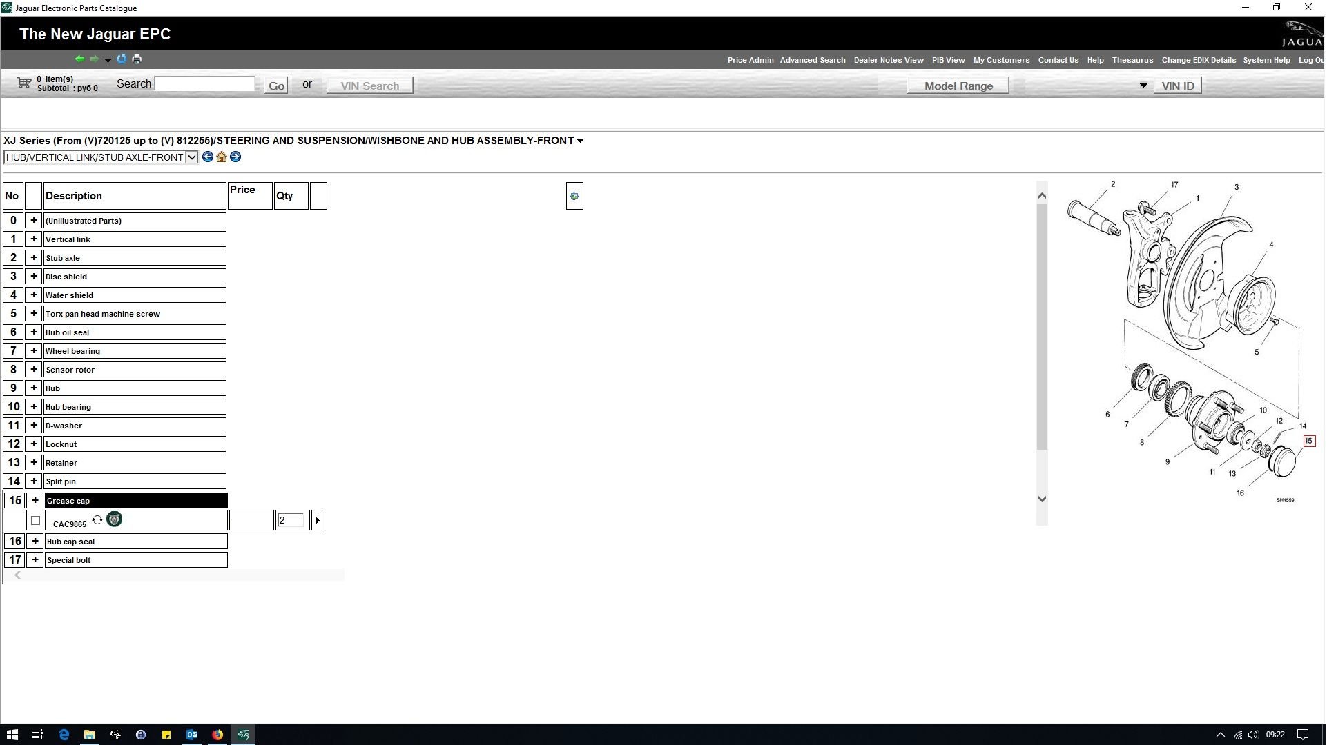

Old Mar 28, 2019 | 04:28 AM
Here's the relevant extract from JEPC (Jaguar Electronic Parts Catalogue) for the X300 Front Vertical Link clearly showing the cap (item 15):
If there was supposed to be an equivalent one on the Rear Hub Carrier, it would be on the JEPC page I posted in #4.
Graham,
I agree so will just leave that one off
