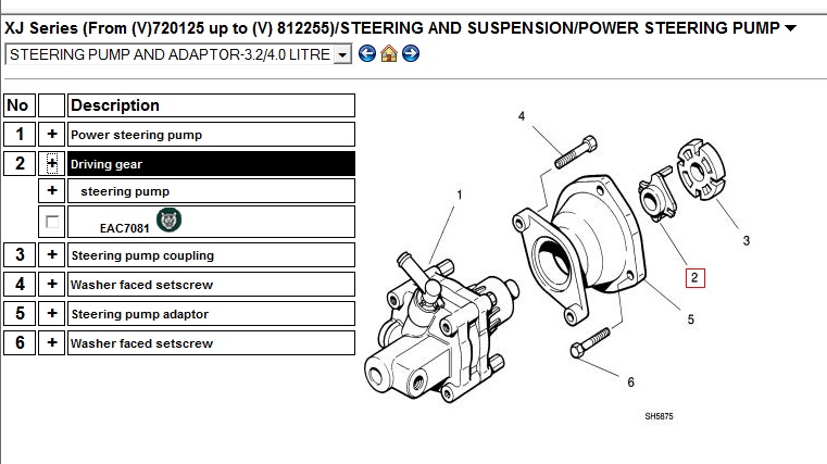

My off-the-cuff guess is that the pump went Tango Uniform. Or the pump isn't being driven.
It's a shaft driven pump, not belt driven, by the way. And as I recall there's a coupler or "dog" of some sort on the shaft. If so, perhaps it's broken?

Failed pumps usually make unusual noises. The Driving Gear (item 2) is a possible cause:

I reckon the Item 3, plastic coupler has died.
I have had one do that in all my years.
The AJ16 (X300) is an alloy ZF pump, as apposed to the XJ40 which is a cast iron anchor, and they are not interchangeable.
These alloy pumps are real fussy with good clean ATF, and will cease very quickly if neglected in that area.
I would carefully crack one of the cooler lines, RH side of the radiator, and see if you have fluid escaping (lots of it) with the pump running. This will establish that the pump is being actually being driven, thus eliminating Item 3 in Graham's post.

Well gentlemen, this will be my first. I have over a million miles in the XJ's over the years and have never had a power steering issue, I took everyones advice, as the R&R of the pump is quite easy, was not the driving gear was not the coupling...........It was a bad pump By the grace of goodness I kept a couple of donor cars and with a minor modification to the high pressure coupling the pump off my 92 fit perfect, no more issues
