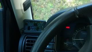

Has anyone tried the UltraGauge? I've got one in my land rover now and it's great! It reads codes and also gives live data. Best part is it's only $60. It's also very compact so it will fit well into the interior.

I bought it after I sold the XJR. The Land Rover Discovery is known for overheating, so I bought it for that. I really like the Gauge. It's got MANY gauges you can set on the screen, and the size is really nice. VERY compact. I just leave it plugged in full time on the Rover.

PS: Yes, that IS 13.3 MPG... OUCH!
