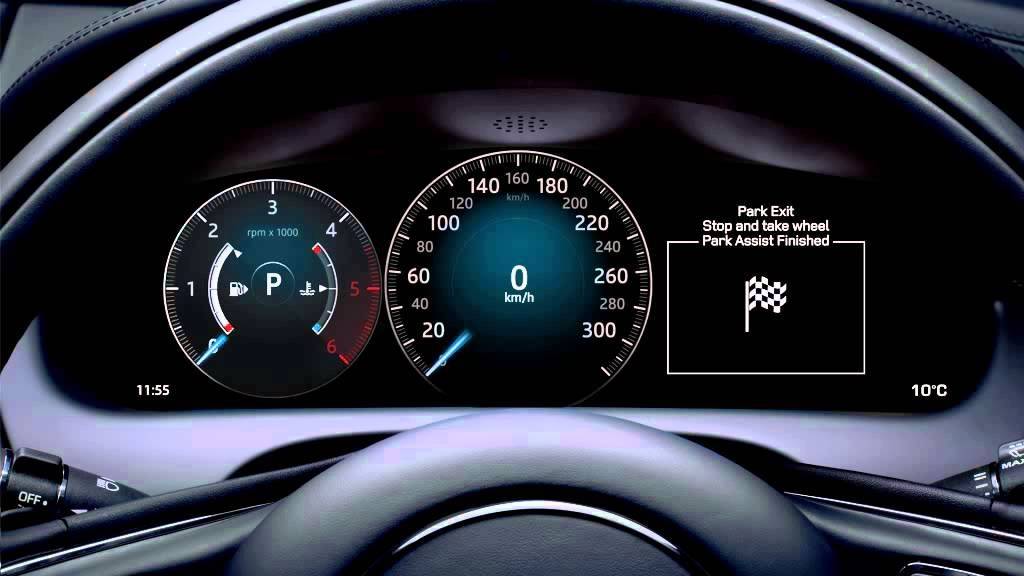

Hello, I am just curious I have mapped Jaguar XJ 2016 3.0 v6 supercharged 410hp 300kw without limiter. Is it possible to hit 300 km/hod?

Adrian Ady, atleast from a power point of view, you should be good for up to about 200 MPH (316 km/h). So, now the question comes whether the gearing is there for you. This is where a little bit of math will answer that for you. So, in short, if your car will hit 100 km/h by the time you hit 1500 RPM, then you will be able to hit 300 km/h. If you are up around say 1800 RPM at 100 km/h, then you are going to be limited based on engine RPM. This is all based on what I see in the image where you are rev limited to 4500 RPM.
