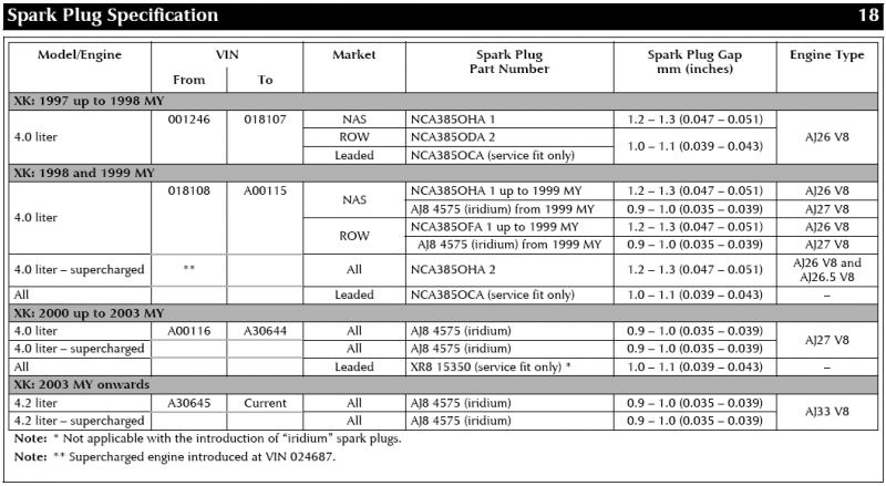

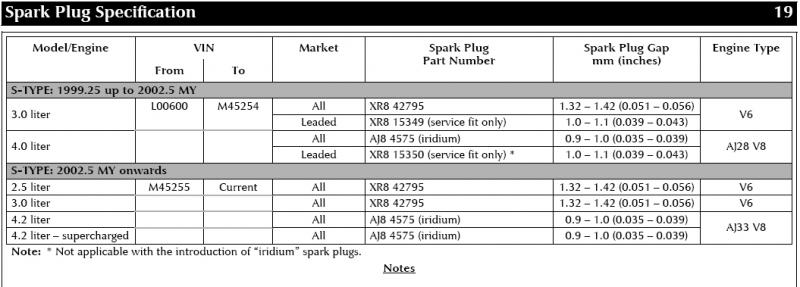

Never assume that the gap of your plugs out of the box is correct for your car. For the proper gap, go to your Vehicle Specification Book. You can find it on this forum or on my page under Electrical, OBDII codes, Tech Guides & Spec Book. When installing your plugs use anti-seize and be sure to properly torque the plugs. You do not want to overdo it and brake the plug and you do not want it to loosen up as you are driving.
